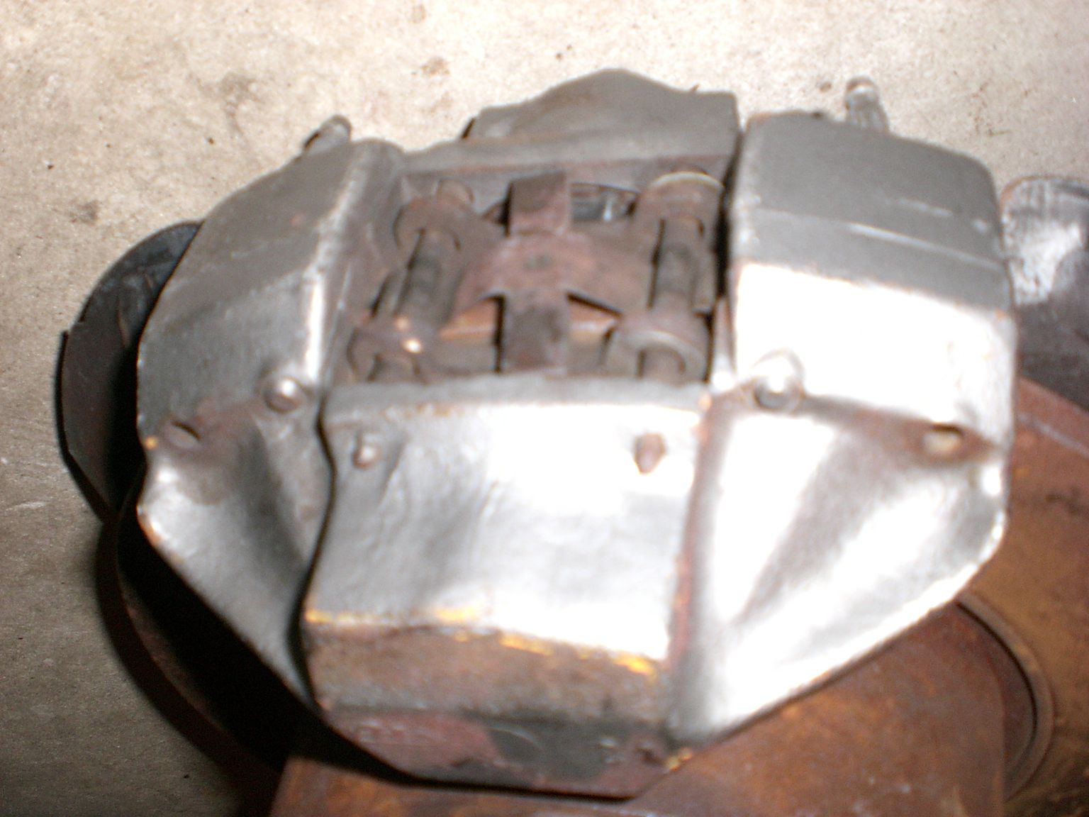

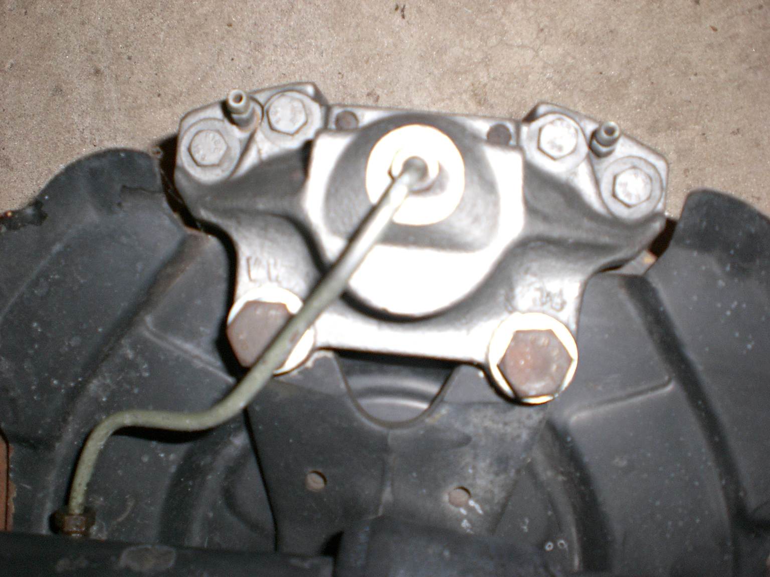

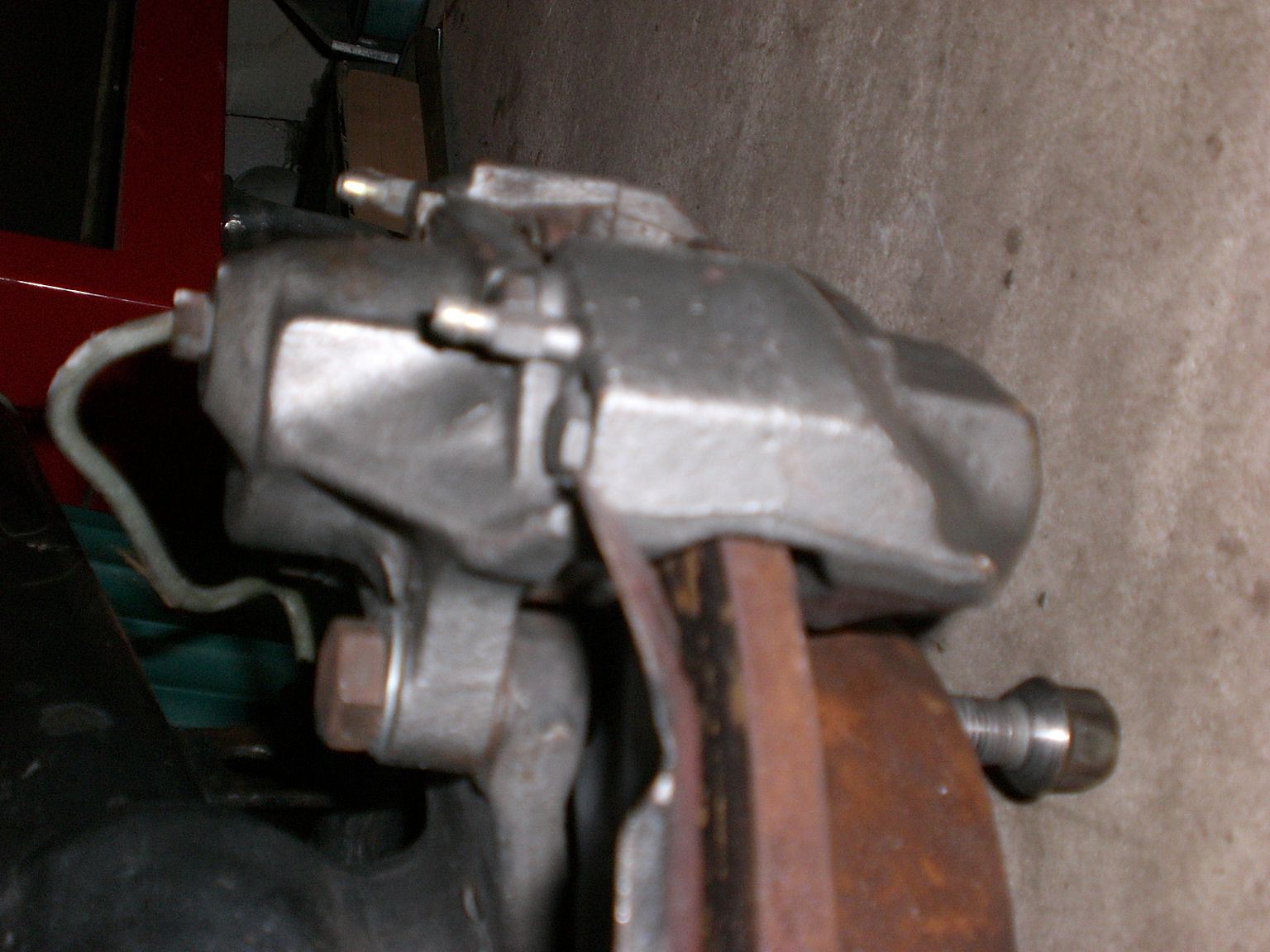

rufio0205   back to the brake issue. a friend gave me the fr...   Feb 13 2008, 09:25 AM
Richard Casto   Regarding brake calipers, this Wiki article will g...   Feb 13 2008, 10:49 AM
rufio0205   i didnt see your first post, sorry. thanks for th...   Feb 13 2008, 11:48 AM

geniusanthony   3 inches center-to-center will fit 914 struts, alo...   Feb 13 2008, 06:50 PM
John   Those are not 911 struts. Those are 914 struts th...   Feb 13 2008, 08:43 PM
rufio0205   hey thanks for all your help guys. one more questi...   Feb 13 2008, 11:22 PM
John   hey thanks for all your help guys. one more quest...   Feb 14 2008, 12:47 PM
jd74914   :agree: I also have no idea where one finds a 17...   Feb 14 2008, 01:37 PM
rufio0205   there is nothing wrong to my knowledge with the ma...   Feb 14 2008, 02:08 PM
