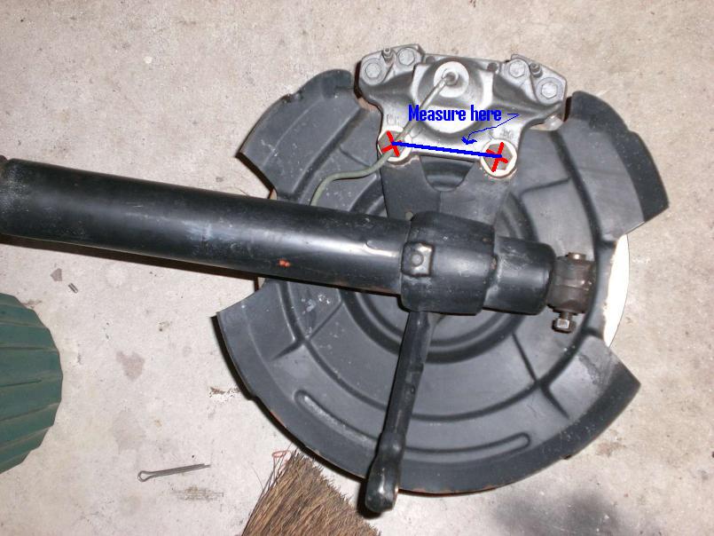

3 inches center-to-center will fit 914 struts, along with the 19mm master cyl. a T should replace the factory proportioning valve. I know Eric Shea sells em.

rufio0205   back to the brake issue. a friend gave me the fr...   Feb 13 2008, 09:25 AM
Richard Casto   Regarding brake calipers, this Wiki article will g...   Feb 13 2008, 10:49 AM
rufio0205   i didnt see your first post, sorry. thanks for th...   Feb 13 2008, 11:48 AM

geniusanthony   3 inches center-to-center will fit 914 struts, alo...   Feb 13 2008, 06:50 PM
John   Those are not 911 struts. Those are 914 struts th...   Feb 13 2008, 08:43 PM
