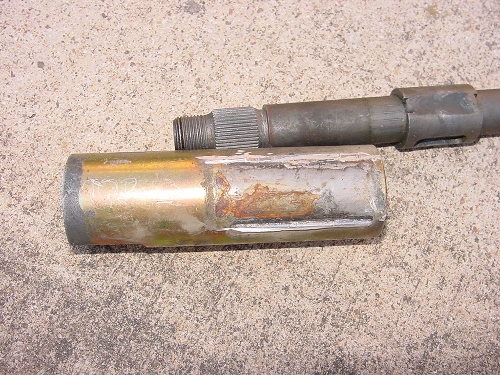

Start with a 4 cylinder column. Remove the mounting plate from it.
Pict is of the leftover column tube. (IMG:style_emoticons/default/sawzall-smiley.gif)

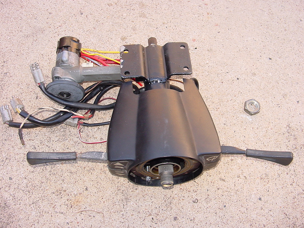

Weld the 4 cylinder mount to the 911 column. (IMG:style_emoticons/default/welder.gif) You should end up with this.
Now you can put the column back together. I don't know about a car with a stock 3 gauge dash, but with the 911 style dash I had to trim the front edge of the top clamshell to get it to clear the gauge assembly.
