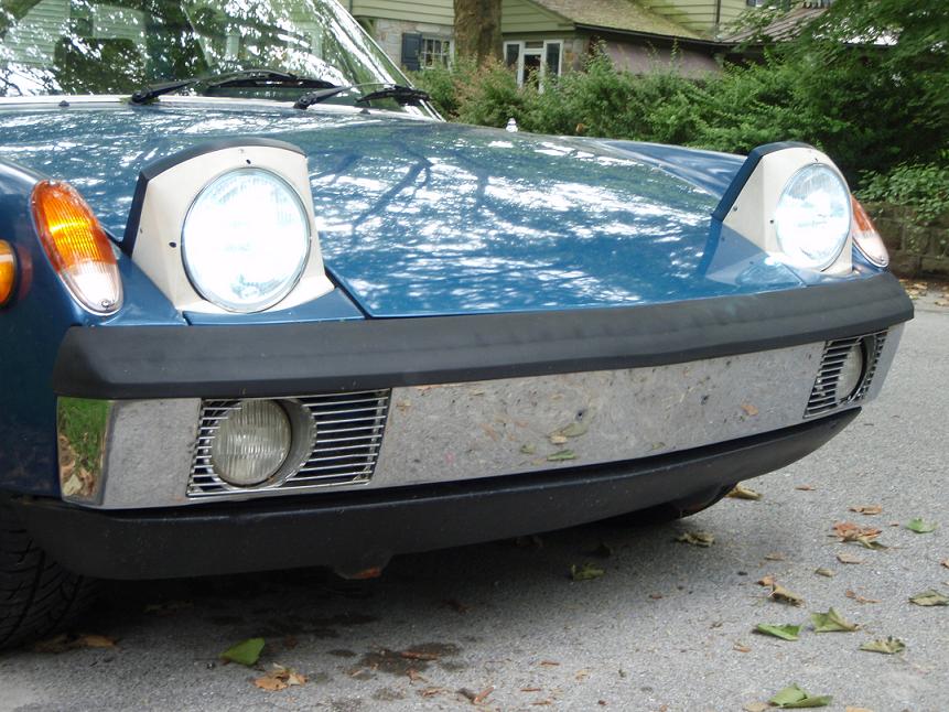

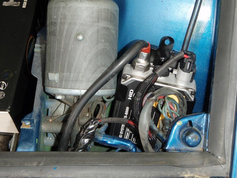

I have been searching the web for a good HID kit, and i finally went all out and got one. Took a couple of hours to install. Basically it just snaps on to the existing harness and has a few extra wires going into the headlight box. sorry, i had to make a few more holes in my teener (IMG:style_emoticons/default/dry.gif) Then i used the hella h4 e code lense so the beam would not blind any of the opposing traffic. I tucked the ballast right behind each headlight.
My setup runs on 12volt and draws 3.2amps constant. initial startup draws as much as 8 amps. then it puts out a constant 35watts. I choose a color temp of 6000k (sunlight) (IMG:style_emoticons/default/aktion035.gif) Attached thumbnail(s) |
