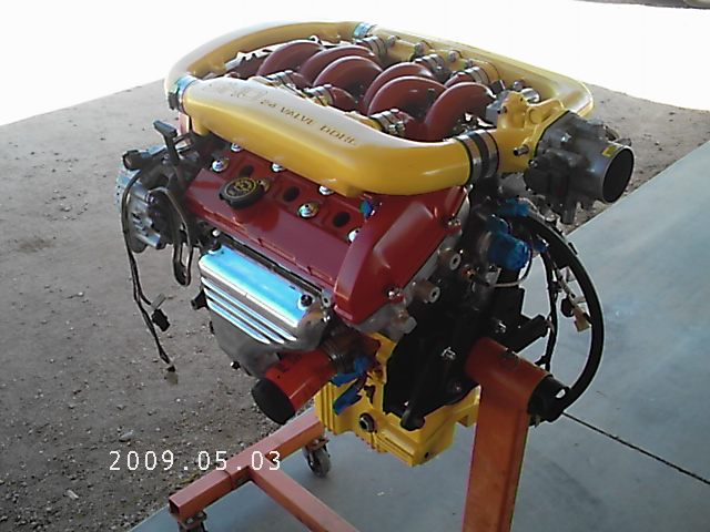

Seen a couple different approaches for exhaust on V6 & V8 teeners. Gettin ready to fab a Y-pipe for the SHO motor going into the 914. Want to run single exhaust down the right side, muffler in stock position, and single tail pipe out the back-left.
Curious to see different approaches there are for routing exhaust above or below the axles. Post pics!
Here's a picture of the 3.2L SHO motor.
TIA
