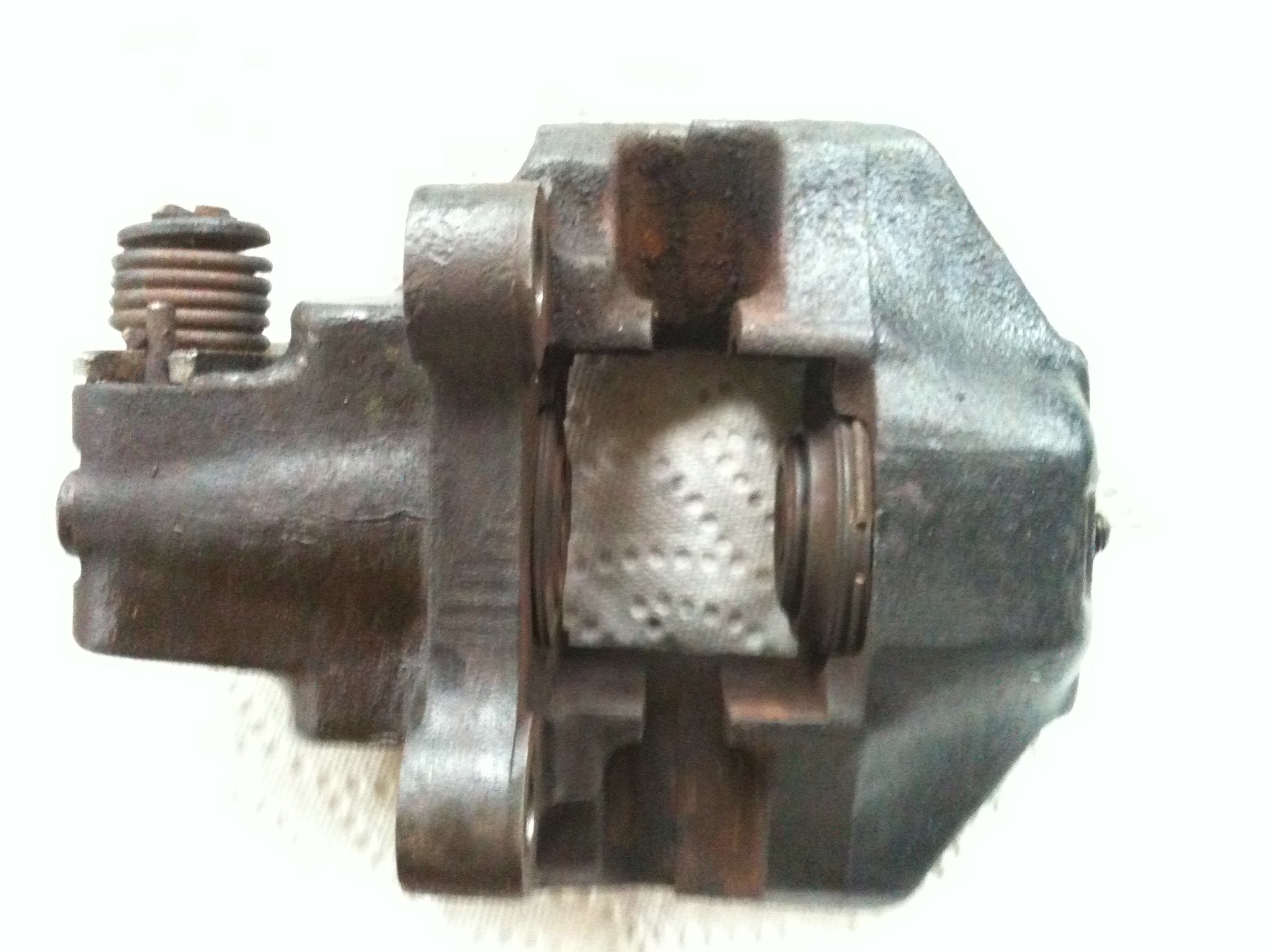

while i wait for other calipers to come, i'm looking at the ones i have.
i'm having a problem retracting the outer piston into the housing. i've sent the guru eric a pm, but i thought i'd put it out for the crowd too. shouldn't the pistons seat all the way, like blairs here? mine move pretty well, but don't want to go that far. thanks! |

rick 918-S Could be a ring of varnish from old scortched flui... Jun 28 2012, 08:02 AM
Cap'n Krusty Keep in mind you should be applying pressure to th... Jun 28 2012, 08:04 AM
lotus_65 ok, cap'n. i'll find a spreader to apply p... Jun 28 2012, 08:15 AM
Valy If you're trying to reuse the without any kind... Jun 28 2012, 09:24 AM![]() ![]() |
