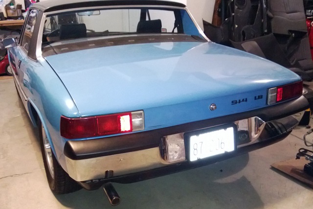

Here is the candidate (or victim, depending on what side of the fence you are on):
A 1975 1.8L with California Emissions...I've had it for almost 11 years. During that time I have logged about 2800 miles on it. I decided to swap it out for a modern drive train so my daughter could drive it so I started looking for a 2.2L Subie and a 2WD auto trans. This setup CAN be made to work with a custom hanger, but it's not a very exciting trans. Think early '90's Camry or Corolla acceleration. I'm sure it could be re-geared but an Audi trans would probably be a much better option.

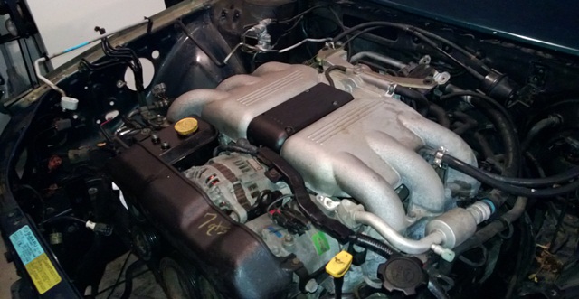

So far I have:
Strong running SVX engine

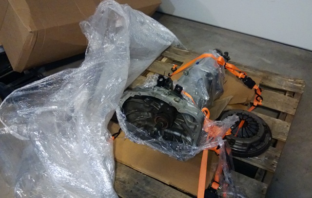

2006 WRX trans purchased from NASIOC

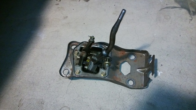

1990-1992 Honda Accord shifter Update - you cannot use this one unless you design something to reverse the shifter mechanism operation. Since it is designed for the trans in front of the car the mechanism moves in the opposite direction (mirror image) of what is needed. I ended up using an MR2 shifter.
