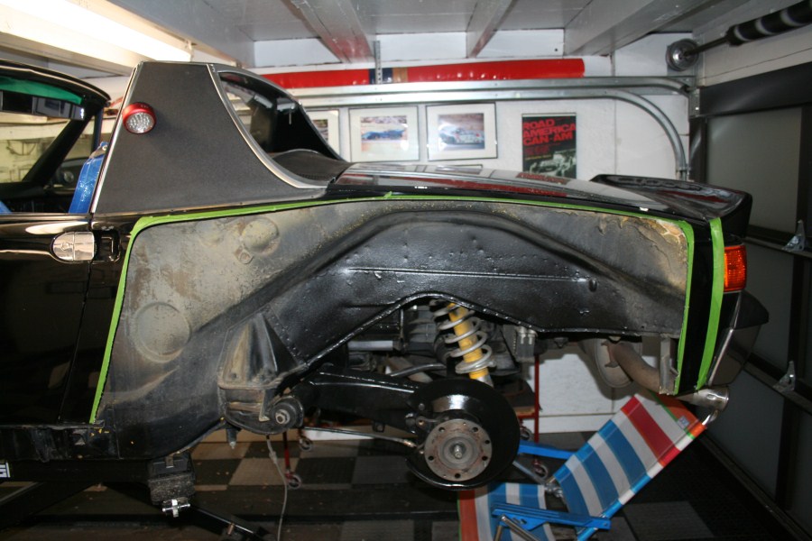

AAAAHHHHHH! Some lunatic broke into my garage and cut off my fender. Just kidding. Actually I'm the lunatic. Prepping for fiber glass. Easier than I thought with a sabre saw.

jsconst   :woohoo: So how long did you stand there looking ...   Jan 23 2013, 07:35 PM
Elliot Cannon   :woohoo: So how long did you stand there looking...   Jan 23 2013, 07:35 PM

tadink   AAAAHHHHHH! Some lunatic broke into my garag...   Jan 23 2013, 07:42 PM

'73-914kid   Are you bonding it on, or Dzus fasteners?   Jan 23 2013, 08:29 PM
Elliot Cannon   Are you bonding it on, or Dzus fasteners? Dzus.   Jan 23 2013, 11:38 PM
76-914   get stainless or anodized so you don't need to...   Jan 23 2013, 08:44 PM
Elliot Cannon   get stainless or anodized so you don't need t...   Jan 23 2013, 11:40 PM

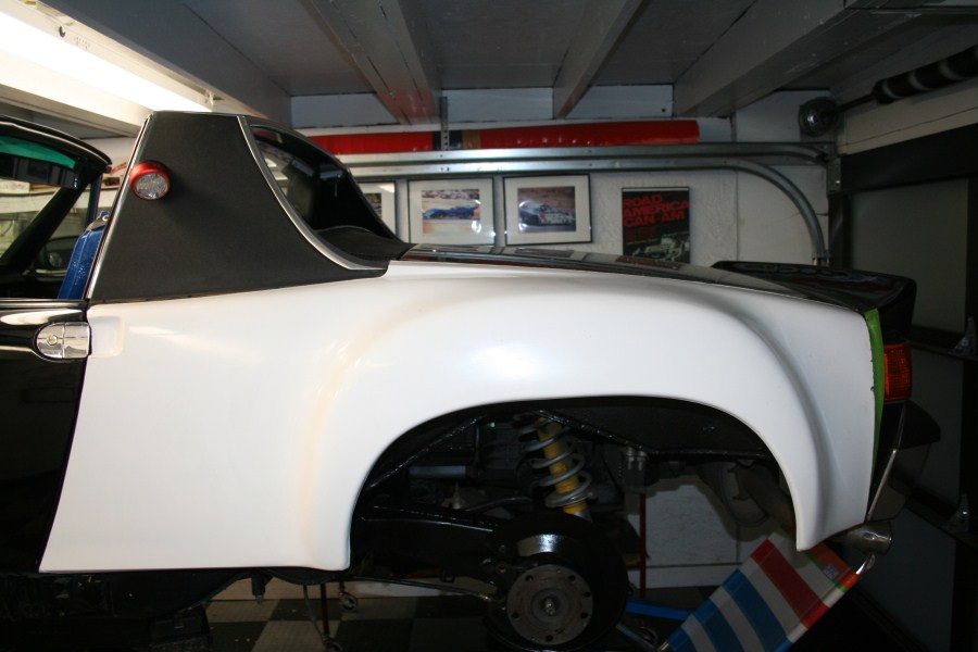

Elliot Cannon   It has taken a little massaging to get the fenders...   Jan 28 2013, 08:21 PM
76-914   It has taken a little massaging to get the fender...   Jan 29 2013, 09:25 AM
Elliot Cannon   It has taken a little massaging to get the fende...   Jan 29 2013, 10:48 AM
tadink   It has taken a little massaging to get the fender...   Feb 5 2013, 03:17 PM
Elliot Cannon   [quote name='Elliot Cannon' post='1811187' date='...   Feb 5 2013, 09:52 PM

Elliot Cannon   All the "Dzus" fasteners are installed. ...   Feb 5 2013, 10:50 PM
Elliot Cannon   I had to fabricate some "struts" to make...   Feb 5 2013, 10:53 PM
Elliot Cannon   I had to do a lot of "massaging" to make...   Feb 5 2013, 11:00 PM
Elliot Cannon   I cut a lot off the back of the rear fenders becau...   Feb 5 2013, 11:04 PM

Elliot Cannon   Just a quick update. I got all the fenders and bo...   Mar 30 2013, 06:06 PM

Elliot Cannon   I finally got some good paint on these fenders. A...   May 22 2013, 06:17 PM
