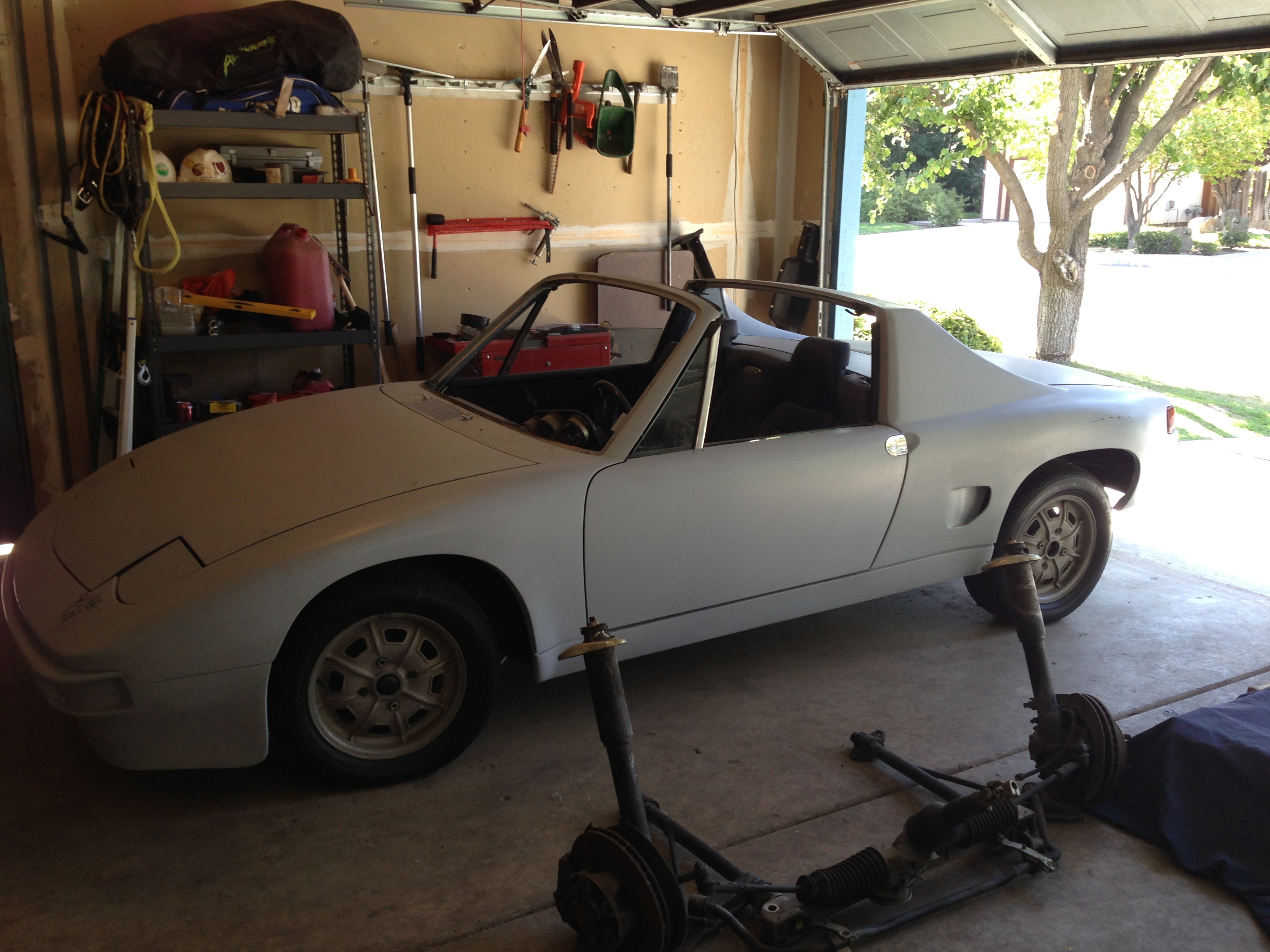

Hello 914 world and welcome to my thread ....I'm in the process of a conversion with a ez30r I have been collecting parts since december of 2012 its going to be a long road ahead but I see the promise land ahead
Here she is one long search 10 hour drive and a trade later she is mine (IMG:style_emoticons/default/biggrin.gif) bodywork was all done prior and anti rust agent was done by last owner
