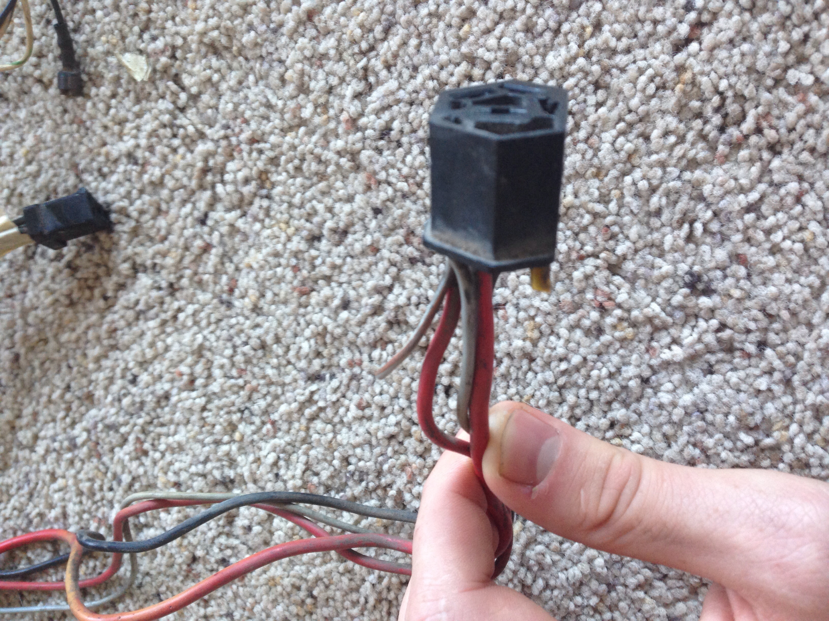

Have the harness out right now for some stripping and cleaning and cant figure out where this plug would go.
I have a 72, not sure if it was efi or carb, i would think it was a carb but i dont know the year they started selling efi (73?) If someone knows what it is, i would also like to know if the harness will function without it being plugged in. Thanks alot. Sorry about iphone pics Attached thumbnail(s) |
Mwood Mystery plug in 914 wiring harness Jan 19 2014, 01:40 PM
Mwood Here it is dead-on Jan 19 2014, 01:41 PM
Jeff Bowlsby It goes to the Ignition switch! Jan 19 2014, 01:47 PM
reharvey
... Jan 19 2014, 01:51 PM
Mwood Oh god nice ...
Thanks for the help Jan 19 2014, 01:53 PM
Kirmizi :agree:
You've also got some snipped wires th... Jan 19 2014, 01:54 PM
zambezi And by the way, ALL 914-4's were originally EF... Jan 19 2014, 10:30 PM
Dave_Darling One exception to that: The European-spec 1.8 lite... Jan 20 2014, 04:45 PM
SLITS The cut yellow wire is your starter (solenoid powe... Jan 20 2014, 05:13 PM
Mwood thanks all for the info it is much appreciated.
o... Jan 20 2014, 07:56 PM
Mwood EDIT: nevermind
figured this one out on my own. Im... Jan 20 2014, 08:14 PM![]() ![]() |
