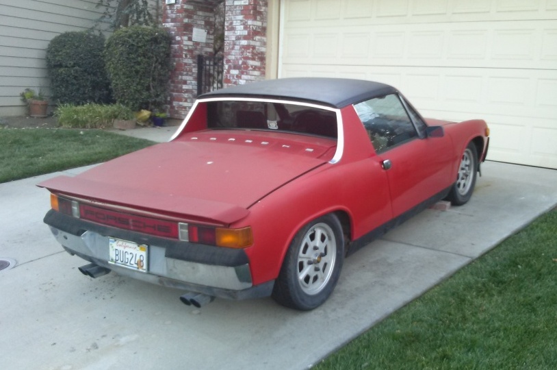

New poster here, but far from new in terms of reading the forums on this site. I am an avid participant on Rennlist, and the Rennie guys highly recommend the 914world folks. Isn't this great? Our love of Porsches overshadows any competition between web sites. I have an '03 911 (ok a 996), and an "07 Cayman. But, I have a big time 914 itch that needs scratching. I need to add a 914 to the stable.
OK, guys, some armchair quarterbacking requested.
This weekend, I read EVERY thread on the 914 forum here. I have my 914 requirements narrowed down to the following: 1973 2.0, or 1974 2.0 with appearance group. Any color except black.
With that said, it narrows down even more the slim field of cars on the market.
So, I have a car I am considering... 1973 2.0 .... it meets the criteria, but is in worse shape than I had hoped for. I didn't really want a "project" car, but maybe that's the best way to go to end up with what I want.
A friend (fellow Rennie CP.... THANKS CP!!!!!!!) looked at the car for me today (it's about a six hour drive from me). The seller arranged to leave the keys for CP. Alas, seller also neglected to tell CP that he took the battery out recently and forgot to re-install it.
So, I am working with limited information so far. Seller says car is in good running condition. I'll get that verified. So, ASSUMING the car runs, what do you think of it based on these photos?

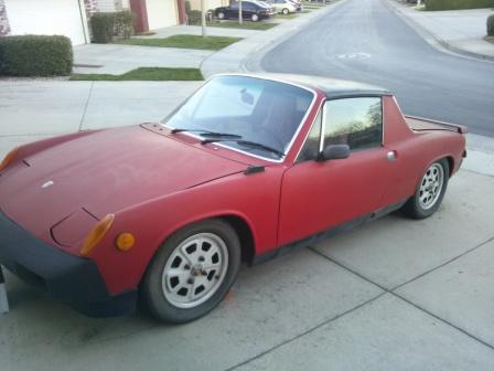

You will note items like that goofy antenna, crappy side-view mirror, wing, etc. Those are minor fixes. Also, that doesn't look like a 1973 front bumper to me.
What would you think is a fair price for this car, based on the pix?
Per seller:

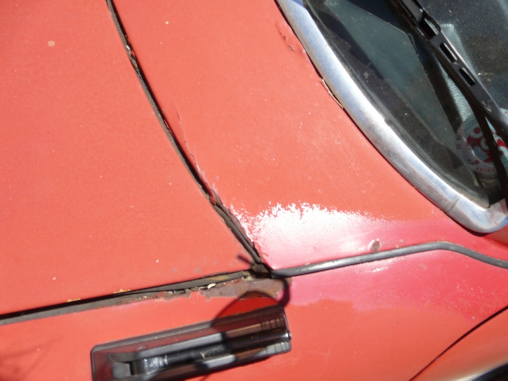

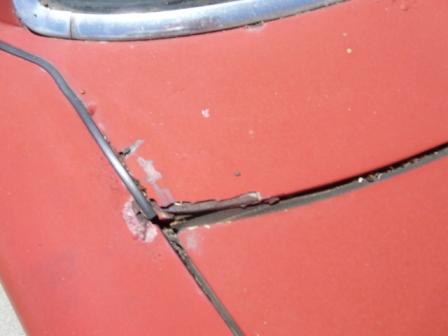

"Battery tray is not great but suspension member is solid as is body under the battery tray. Surface rust on edge of trunk lid and driver a pillar."
"I bought the car from an older couple who spent a ton of money on new clutch, tires and other stuff then just let it sit. I got it, got it running and here we are. Odometer says 23,xxx but it's a 5 digit odometer. Engine runs strong, no idea on mileage. Has stock fuel injection."
"New clutch, ignition coil, tires, fuel pump, fuel pressure regulator"

Big Len   First, it has 75-76 front clip with earlier rear b...   May 28 2014, 03:47 AM
Cuda911   First, it has 75-76 front clip with earlier rear ...   May 28 2014, 03:51 AM

Porschef   Uh, no. :barf: Keep looking. How many cars have y...   May 28 2014, 04:21 AM
Mikey914   I think you can do better. There are alot of greml...   May 28 2014, 04:30 AM

bulitt   You read the replies but are blinded by the overwh...   May 28 2014, 04:48 AM
ripper911   :agree: much better cars for 5k out there. I...   May 28 2014, 05:09 AM
hot_shoe914   For $4500, you will only be over paying by ...   May 28 2014, 05:12 AM
mepstein   I bet it's been hit and it's very rusty. J...   May 28 2014, 05:12 AM
carr914   $1500   May 28 2014, 05:22 AM

Java2570   Pass on that red car....too much wrong with it and...   May 28 2014, 06:02 AM
Cairo94507   You should pass on that unless you really want a p...   May 28 2014, 06:19 AM

brant   You have to pull the rockers before you buy a car....   May 28 2014, 06:56 AM
bandjoey   $500 or pass. You will be disappointed. Go to...   May 28 2014, 07:34 AM
tornik550   Most I would pay is 1k and I probably wouldn't...   May 28 2014, 07:36 AM
Tom   The picture looking down the drivers side looks li...   May 28 2014, 07:40 AM
lsintampa   I'd not buy this car. Don't rush to jump...   May 28 2014, 07:59 AM
rhodyguy   The rust pictured is not "surface" only....   May 28 2014, 08:05 AM
ben*james   Bumper mismatch = bad sign or very poor taste Batt...   May 28 2014, 08:11 AM
toolguy   That is a parts car at best, as you'll easily ...   May 28 2014, 08:19 AM
