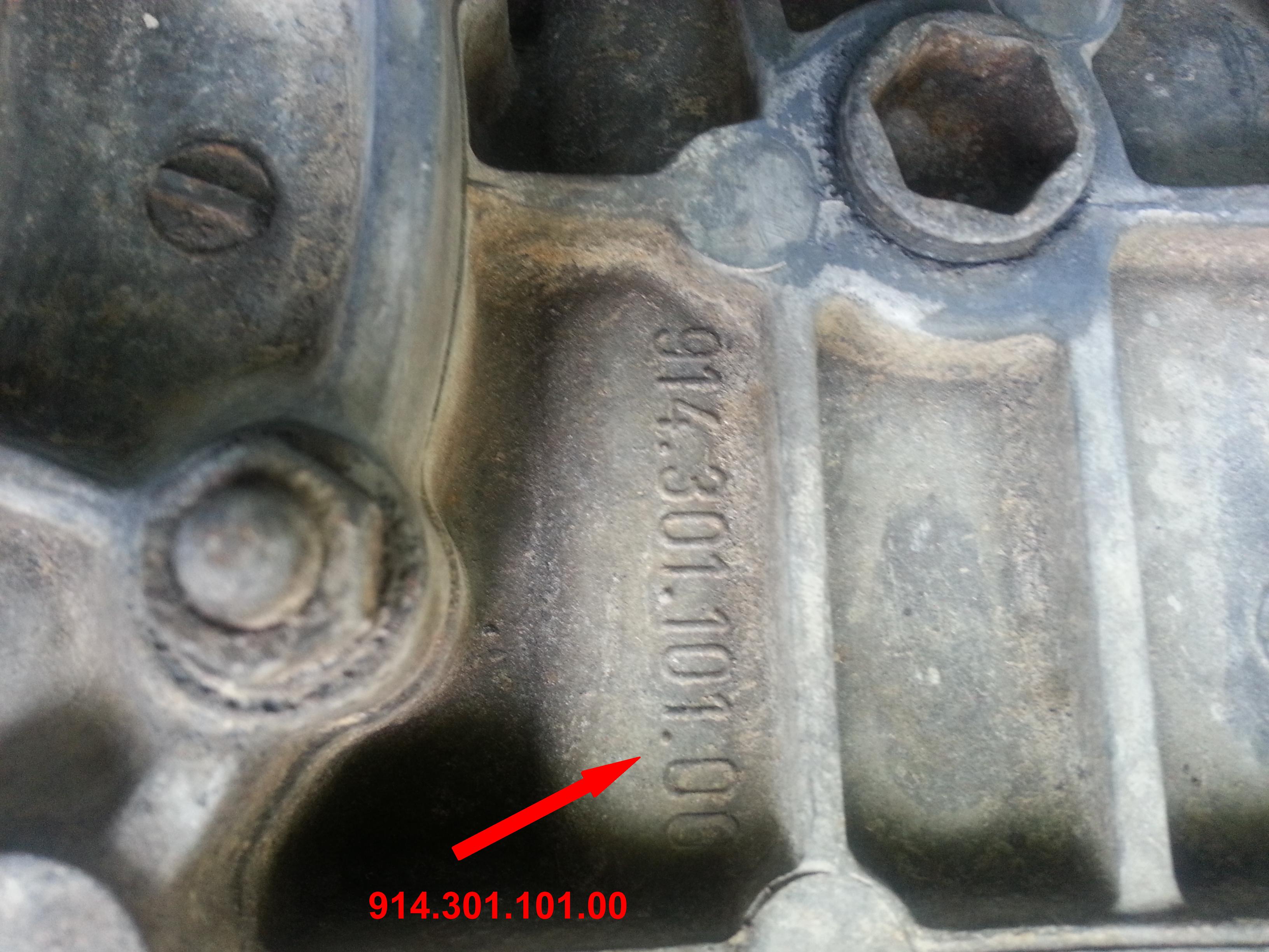

My 1974 914 I bought did not come with an engine or transmission. I bought this off craigslist titled as '914 transmission for sale'
Guy didnt know anything about it. Said it was a 5 speed that was pulled from a running 914 and shifted fine, no known issues, blah blah... Oh he said this is a tail shift? I only found two numbers on it. Cant seem to locate a manual for specifications. I need to get a clutch for it, replace the seals since its out, replace the oil, etc. Are there manuals for this?? With these numbers is there a way to reference what year/type etc? Also, what is the little two prong switch? backup/reverse switch or vacuum sensor? 914.301.301.03 914.301.101.00 Im slightly confused about the numbering of the transmissions. Did a Porsche 914 car come with a 901 trans, a 914 trans, or either depending on year? This first number 914. designate this is a 914 trans? or for a 914 car? Attached thumbnail(s) |
zdaxxy Transmission identify/info Jun 30 2014, 07:10 AM
zdaxxy other side... Jun 30 2014, 07:13 AM
CptTripps I BELIEVE the 914 means it was for a 914 car, or o... Jun 30 2014, 07:17 AM
dlee6204 It's definitely a tail shift which is also in... Jun 30 2014, 07:59 AM
Dave_Darling Originally, the 911 was called the "901... Jun 30 2014, 08:42 AM
Cap'n Krusty All 914 clutches are functionally the same. The o... Jun 30 2014, 08:54 AM
Dave_Darling Oh--the two-wire electrical connector is indeed fo... Jun 30 2014, 03:02 PM![]() ![]() |
