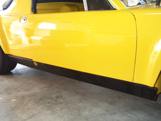

Here's a pretty simple way to flare your steel rockers. They come out pretty nice.
13 pictures to follow:
Start by marking a line on the rockers that matches the flare on the car:
Series9   Flare your steel rockers.   Jan 23 2005, 06:45 PM
Series9   snip the top and bottom lips:   Jan 23 2005, 06:46 PM
Series9   Remove this extra metal from the front bottom:   Jan 23 2005, 06:47 PM
Series9   Bend along the lines:   Jan 23 2005, 06:48 PM
Series9   Bending the rocker outward creates a gap at the to...   Jan 23 2005, 06:50 PM
Series9   another:   Jan 23 2005, 06:51 PM
Series9   Cut some metal and put a 90 degree lip in it:   Jan 23 2005, 06:52 PM
Series9   Filler piece in place. Scribe it's shape on t...   Jan 23 2005, 06:54 PM
Series9   Prep for welding:   Jan 23 2005, 06:55 PM
Series9   Say hello to my little friend:   Jan 23 2005, 06:56 PM
Series9   http://www.914world.com/bbs2/...   Jan 23 2005, 06:57 PM
Series9   Mark the fender arch and cut:   Jan 23 2005, 06:58 PM
Series9   Last one. Cut out some metal to make an end cap a...   Jan 23 2005, 07:00 PM
Series9   The V cut at the bottom is welded now as well. Th...   Jan 23 2005, 07:03 PM
Series9   Third last one. Here's the DS rear on the car...   Jan 23 2005, 07:09 PM
