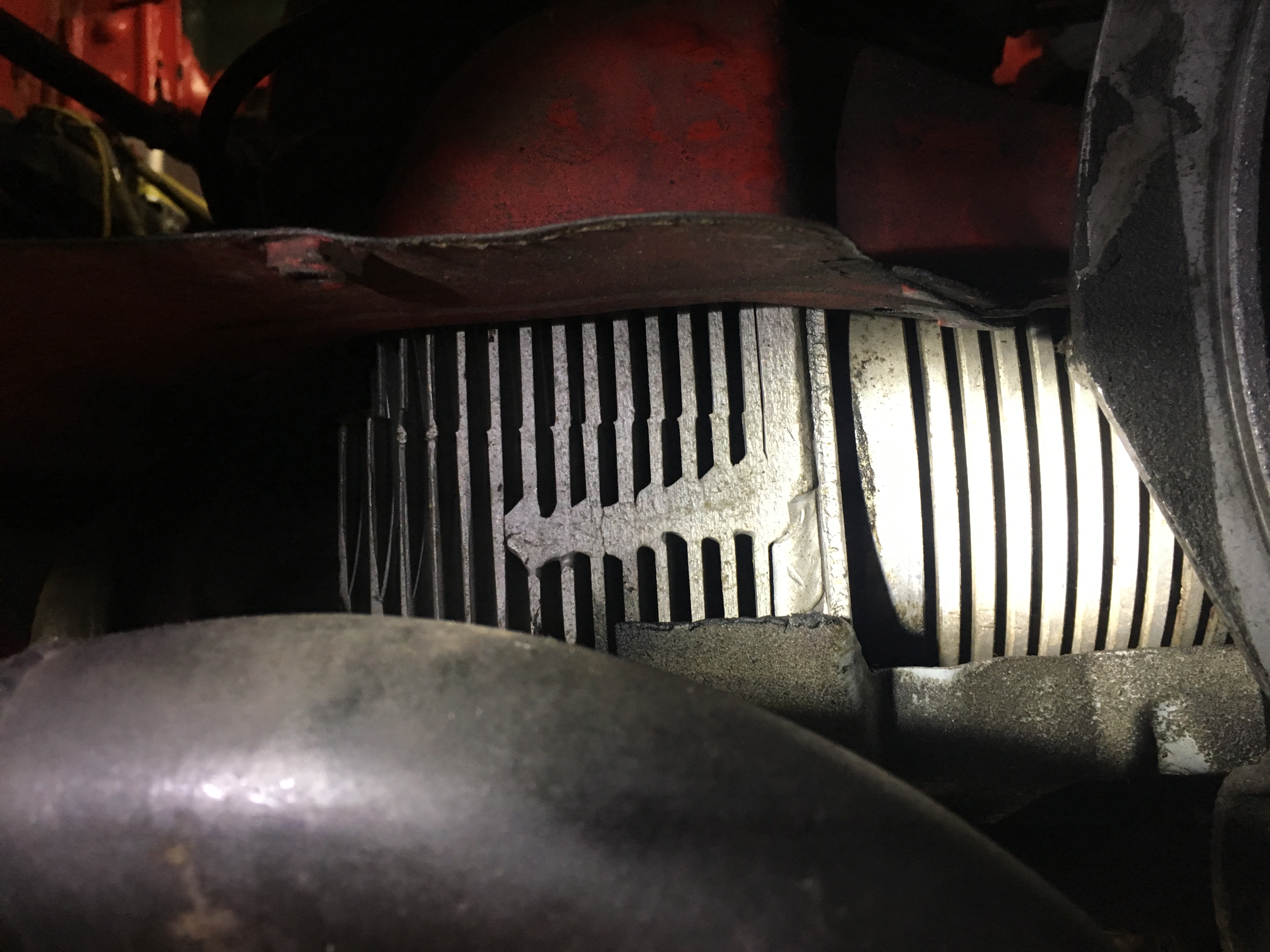

Hi guys-hope everybody's having a good day. I was fortunate off to get a ton of help from Forest and Keith today getting the "turbo" clutch issue sorted out. I can't say enough about how helpful they were and gracious with their time.
One of the things that I suspected, but it appears we now have proof of, is that this engine was built up from the original 2.0 GC case spec.
Can anyone identify these heads or help make a guess as to displaceme

mepstein   Guess displacement with a picture!   Aug 15 2018, 05:08 PM
Tdskip   Guess displacement with a picture! Yep - th...   Aug 15 2018, 05:23 PM
mepstein   Guess displacement with a picture! Yep - t...   Aug 15 2018, 05:45 PM
jcd914   You can't tell engine displacement from pictur...   Aug 15 2018, 05:39 PM
Tdskip   You can't tell engine displacement from pictu...   Aug 15 2018, 05:41 PM
Spoke   I've heard you can measure the stroke with a c...   Aug 15 2018, 06:16 PM
Rand   I've heard you can measure the stroke with a ...   Aug 15 2018, 06:40 PM
Vacca Rabite   I've heard you can measure the stroke with a ...   Aug 16 2018, 09:45 AM
ClayPerrine   I've heard you can measure the stroke with a ...   Aug 16 2018, 10:58 AM
Larmo63   Let's ask Carnac............   Aug 15 2018, 06:25 PM
forrestkhaag   As you and everyone else can read into this thread...   Aug 15 2018, 06:38 PM
Tdskip   As you and everyone else can read into this threa...   Aug 15 2018, 11:14 PM
forrestkhaag   If OGeez are Old Jesus freaks, Yes. Thou Shall app...   Aug 15 2018, 06:41 PM
Cracker   Going out on a limb here but I suppose it is no le...   Aug 16 2018, 07:31 AM
Tdskip   Going out on a limb here but I suppose it is no l...   Aug 16 2018, 09:20 AM
ValcoOscar   Tom- From all the replies it appears you have a s...   Aug 16 2018, 09:31 AM
bretth   Interesting looking cylinders, definitely not cast...   Aug 16 2018, 10:39 AM
Mark Henry   Interesting looking cylinders, definitely not cas...   Aug 16 2018, 12:09 PM
Mueller   Put cylinder 1 at BDC, fill with liquid, measure h...   Aug 16 2018, 11:14 AM
Dave_Darling   The cylinders don't look like cast iron. Chan...   Aug 16 2018, 11:49 AM
brant   There is a test that is used by race organizations...   Aug 16 2018, 01:21 PM
