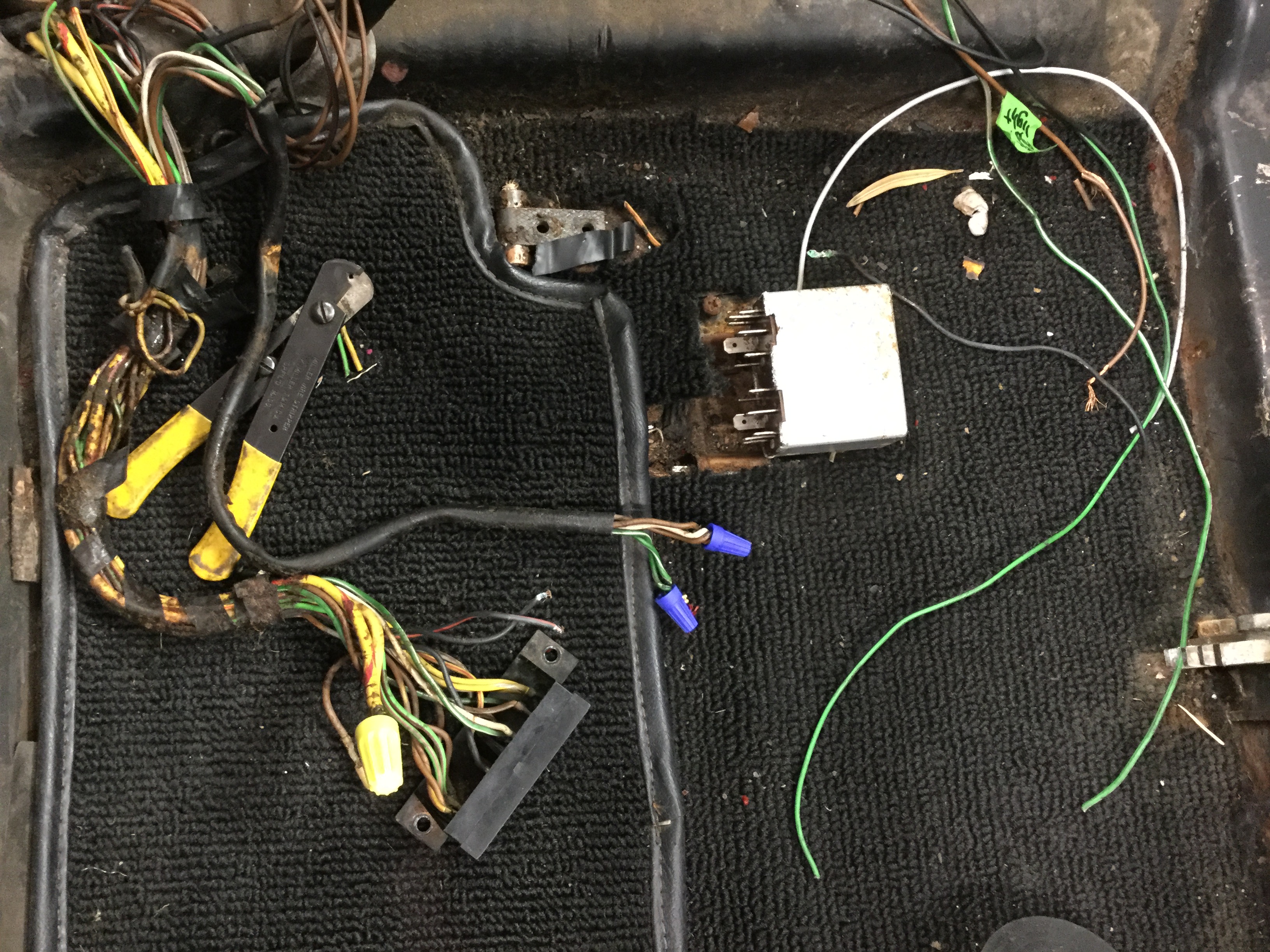

Hello! I am trying to ID these wires:
![]() I am not good at wiring diagrams and I found no luck researching this topic (IMG:style_emoticons/default/confused24.gif) Enlighten me with your Jedi wiring knowledge @JeffBowlsby @Dave_Darling and anyone else who are pros at wiring 914’s. -Ed Attached thumbnail(s) |

jim_hoyland :agree:
I would like to know how the relay works... Aug 25 2019, 06:00 PM
Chi-town The ones with the wire nuts appear to be the buckl... Aug 25 2019, 06:46 PM
FlacaProductions Connect the black wire to the black/red stripe and... Aug 25 2019, 06:49 PM
FlacaProductions Here's a shot that I've saved from here th... Aug 25 2019, 06:50 PM
jcd914 I don't have details on how it is supposed to ... Aug 25 2019, 06:55 PM
FlacaProductions @jcd914 - I think you mean Yellow and Yellow/red ... Aug 25 2019, 06:57 PM
jcd914
[b]@[url=http://www.914world.com/bbs2/index.php?s... Aug 25 2019, 07:03 PM
JeffBowlsby It’s not a relay it’s a logic box. Diagrammed... Aug 25 2019, 07:01 PM
jcd914
It’s not a relay it’s a logic box. Diagramme... Aug 25 2019, 07:10 PM
It’s not a relay it’s a logic box. Diagramm... Aug 25 2019, 07:57 PM
jim_hoyland
It’s not a relay it’s a logic box. Diagramme... Aug 25 2019, 08:28 PM
Rand Cut it all. Join the big yellow because it's t... Aug 25 2019, 08:30 PM
JeffBowlsby Just bypass it by mating the two big yellow wires.... Aug 26 2019, 05:58 AM
porschetub Mines bypassed but I would still like to get rid o... Aug 26 2019, 02:06 PM
914werke Cut it all. Run away laughing happily.
:D @R... Aug 26 2019, 02:34 PM![]() ![]() |
