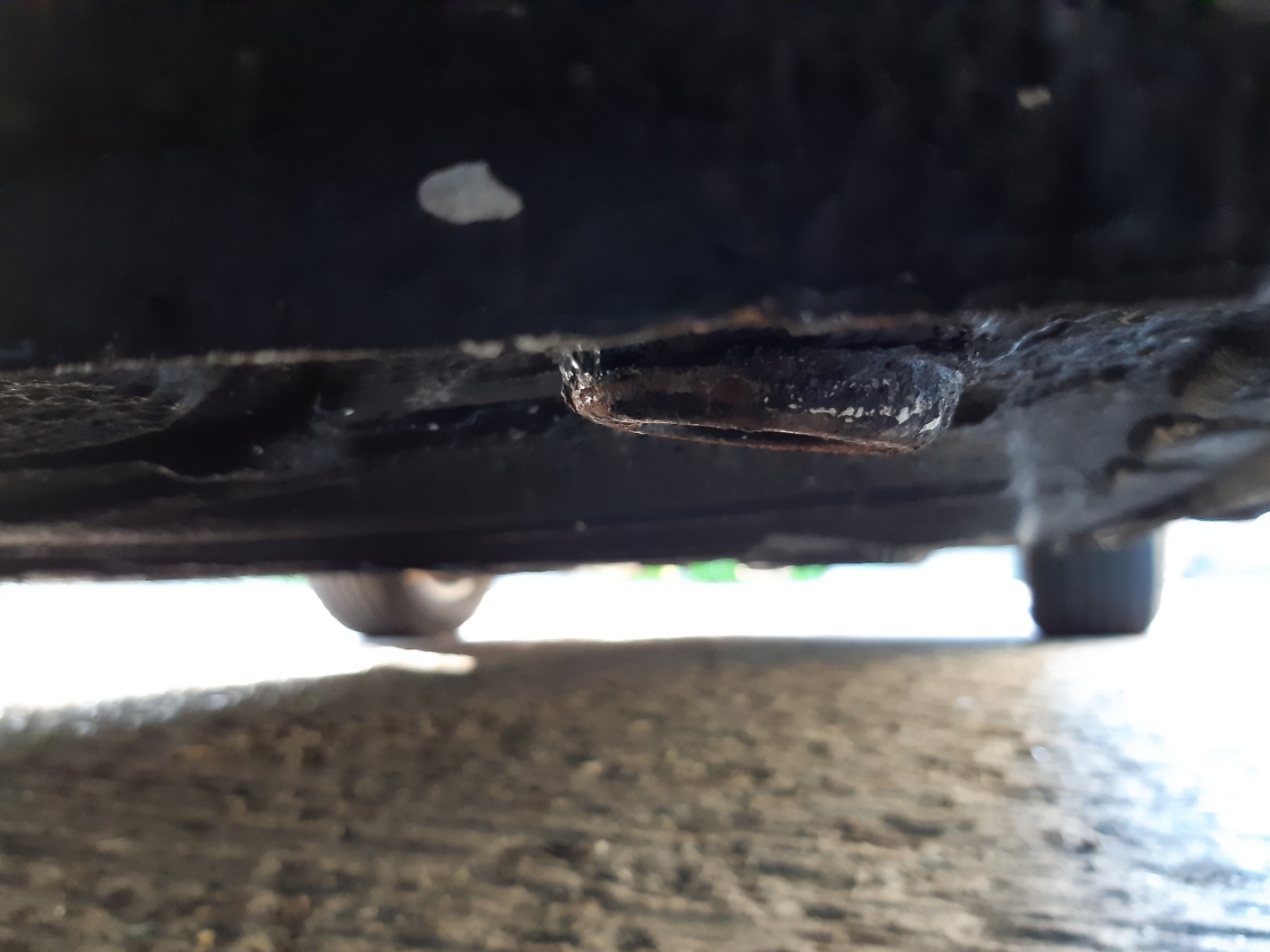

I've noticed that the front jacking points on my car aren't level, and wondered if they've gone up as the car has been lifted - thoughts? It all seems solid.

SirAndy   They are crooked because those aren't jacking ...   Mar 25 2020, 10:15 AM
Biggles   They are crooked because those aren't jacking...   Mar 25 2020, 10:29 AM
dr914@autoatlanta.com   jack under the engine mounting bar, or the front c...   Mar 25 2020, 10:37 AM
Biggles   Cheers George. No engine mounting bar. It's a ...   Mar 25 2020, 11:13 AM
bkrantz   They are crooked because those aren't jacking...   Mar 25 2020, 08:29 PM
914e   They are crooked because those aren't jackin...   Mar 25 2020, 09:32 PM
bretth   I thought all four doughnuts were for jacking up/s...   Mar 25 2020, 11:05 AM
SirAndy   The donuts were used to suspend the cars on the as...   Mar 25 2020, 11:17 AM
Biggles   The donuts were used to suspend the cars on the a...   Mar 25 2020, 11:18 AM

SirAndy   And if you check the location of the donuts in the...   Mar 25 2020, 11:19 AM
kroelofsen   And if you check the location of the donuts in th...   Mar 25 2020, 02:12 PM

mbseto   So aside from accuracy, there's no reason to r...   Mar 25 2020, 04:59 PM
bretth   I think if it was designed to hang the whole car o...   Mar 25 2020, 06:13 PM
drem914   If those are not where we are suppose to jack the ...   Mar 25 2020, 06:49 PM
cuddy_k   If those are not where we are suppose to jack the...   Mar 26 2020, 12:10 AM
drem914   If those are not where we are suppose to jack th...   Mar 26 2020, 10:02 PM
SO.O.C914er   I agree these are the jack points if they are not ...   Mar 25 2020, 07:25 PM
Biggles   Based on the responses, the fact the rear donuts /...   Mar 26 2020, 03:25 AM
