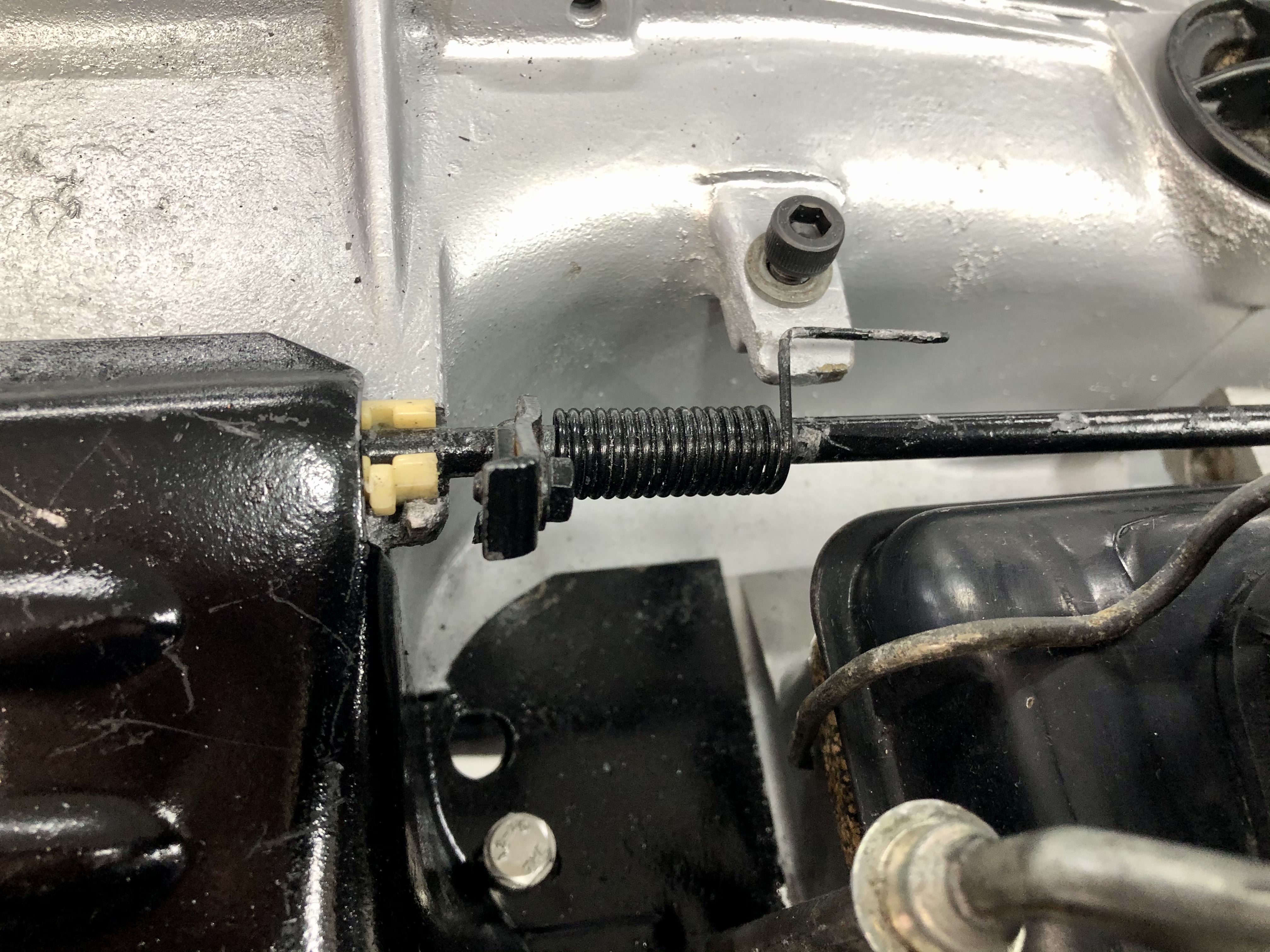

I am installing the engine tin etc. I believe this spring is also held by a piece of metal that is attached to the top of the fan housing with the hex nut. I also assume the spring end goes under not over the plate. But is the spring to be 'Loaded" such that it has tension? I know the thermostat wire attaches also....

There is a black metal tab that holds the rod in ... Oct 12 2020, 02:19 PM
iankarr Yes, the end of the spring goes under the post. It... Oct 12 2020, 02:38 PM
JeffBowlsby You also need the rubber grommet for the wire pass... Oct 12 2020, 03:35 PM
simonjb Thanks all....Does that black tab have a part numb... Oct 12 2020, 03:46 PM
cary 021119729A NLA
We just make them out of 20ga. Oct 12 2020, 11:25 PM
bbrock I cut mine out of a salvaged piece of steel pallet... Oct 13 2020, 07:01 PM![]() ![]() |
