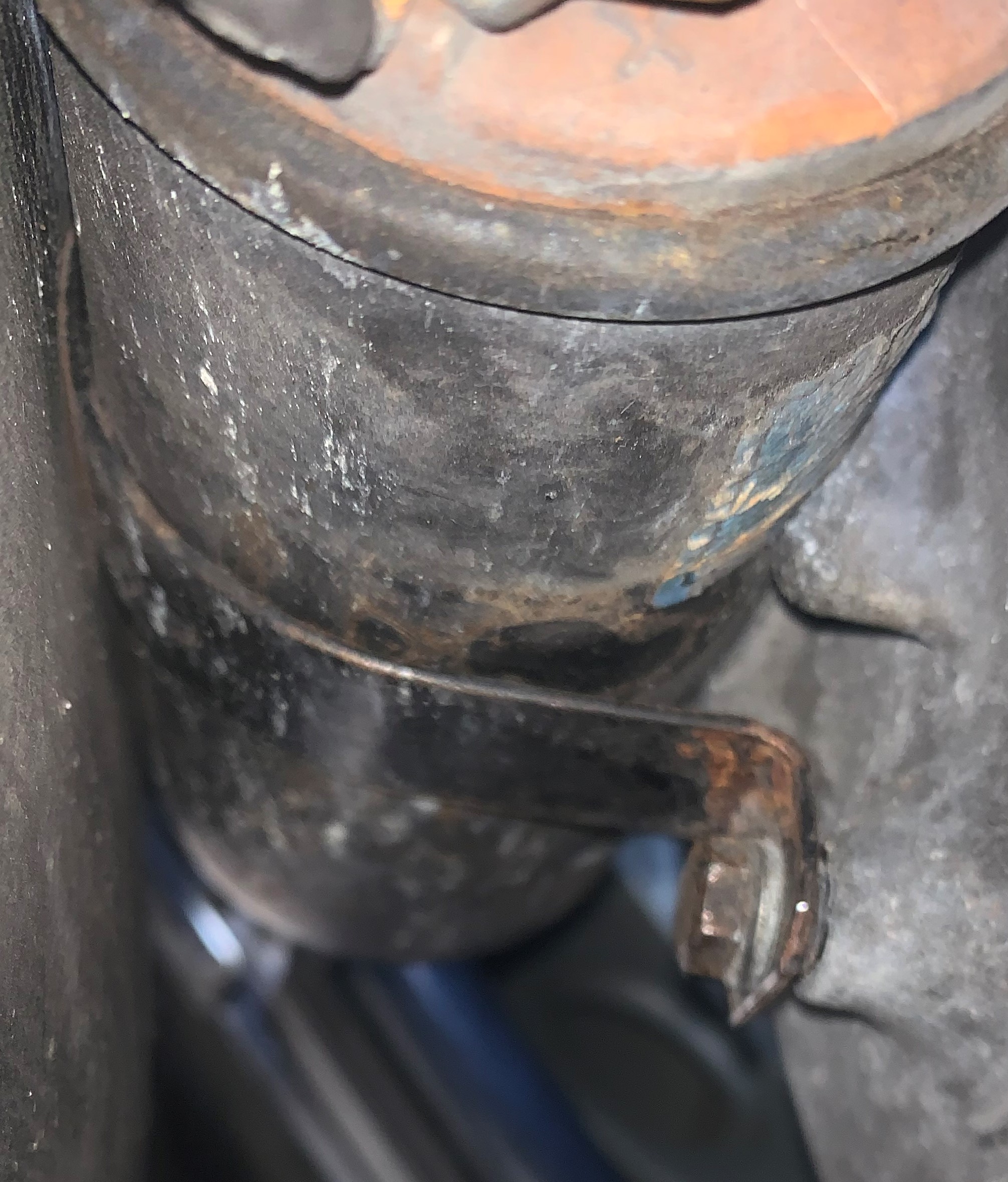

Hello All,
I have a '74 1.8 car and I recently replaced my old black coil with a new Bosch blue coil. The new coil is a bit smaller in diameter than the black one and does not fit properly in the original coil bracket. The front side of the coil bracket is mounted with a bolt and the back side just hooks under a slot in the fan housing. I prefer not to relocate the coil bracket and have to run different lengths of wires to reach the coil in a new position. I am leaning toward an original look by having my factory coil bracket made smaller to fit the new coil, or place something between the coil and the bracket to create a tight fit that would withstand the heat from the coil but still appear original looking so as to not stand out. The car runs but is parked for now, so I just put a shop rag around the new coil temporarily until I figure out a solution that works. What have other folks done? Any suggestions? Thanks! Attached thumbnail(s) |
JamesJ Coil bracket Dec 8 2020, 08:54 PM
Mike D. I have done the same thing and used a thick piece ... Dec 8 2020, 09:02 PM
bdstone914 @jamesj
I have a roll of some 1/16 x 1 cork/rubb... Dec 8 2020, 10:16 PM
914sgofast2 Cut a section or two out of an old bicycle tube an... Dec 8 2020, 10:23 PM
JamesJ
Cut a section or two out of an old bicycle tube a... Dec 8 2020, 10:26 PM
JamesJ Thanks @Mike D. and [b]@[url=http://www.914worl... Dec 8 2020, 10:24 PM
Superhawk996 Anybody have a part number and/or source for this ... Dec 9 2020, 07:27 AM
914sgofast2
Anybody have a part number and/or source for this... Dec 9 2020, 12:17 PM
BillC A strip of 16ga aluminum makes a great shim -- pla... Dec 9 2020, 07:48 AM
914Sixer Use the same piece of rubber that is used in the m... Dec 9 2020, 11:32 AM
rhodyguy 100%. :agree: perfect. The single outlet version f... Dec 9 2020, 12:10 PM
djway You can also get silicone sheet in various thickne... Dec 9 2020, 12:15 PM![]() ![]() |
