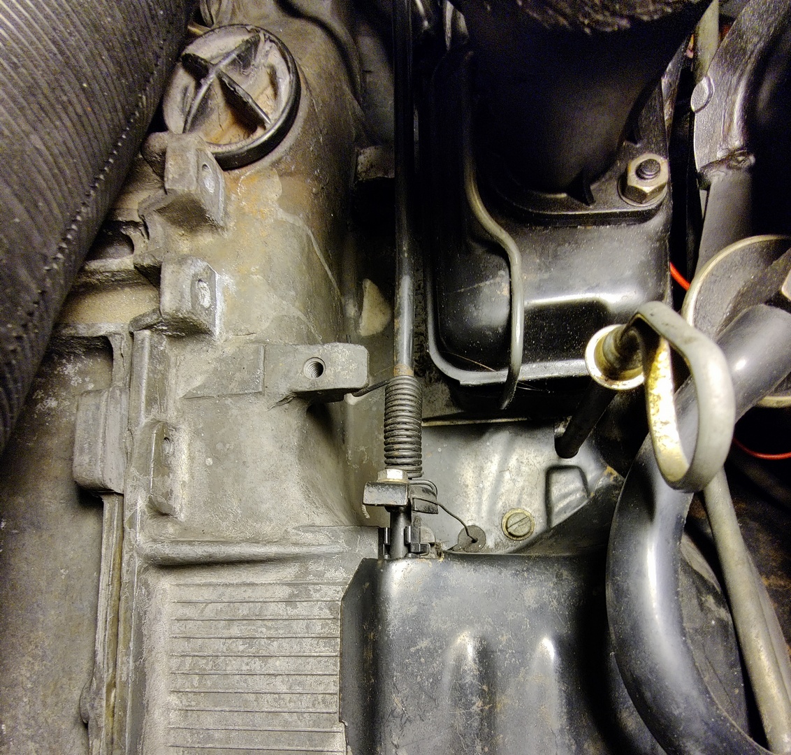

My 914 overheats on the highway. I had concerns about the air flap, but I think the thermostat has broken and it stays in the open position. I thought something might be clogging the fan but it looks clear. I wonder about the heater air hose that goes over the motor. It could be blocking some air possibly. I may try to tie it out of the way. After exiting the highway and stopping at a stopsign the idle was extremely low, I was surprised it was still running. I turned the engine off for a while and it ran better after it cooled down. Any ideas would be appreciated.

JamesM   My gut (and my eyes with limited pictures) are tel...   Jun 6 2022, 02:25 AM
