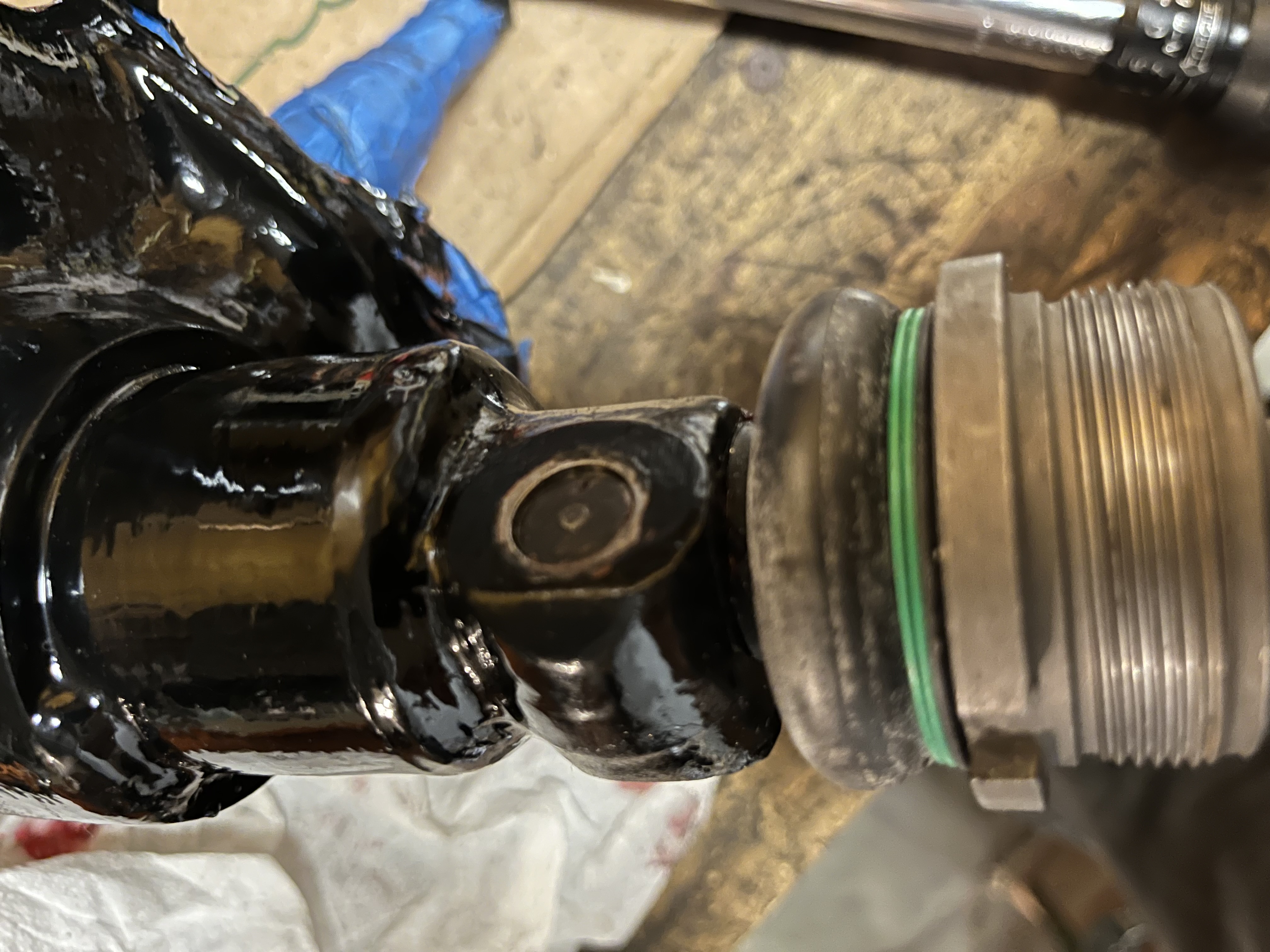

So I got one of the ball joints installed into the strut housing without any issues. Went to do the other one and got the wedge pin tapped almost flush and then went to tighten the nut and got to 20 foot pounds (spec is 33) before the wedge pin started pulling through. WTF?!
Is it safe to leave it like this? This is a wedge pin from Porsche. |

mepstein Is the nut bottoming out on the pin. I would do so... Jun 12 2024, 06:01 AM

technicalninja The pin is compromised, nothing else.
I'd rep... Jun 12 2024, 08:02 AM

technicalninja The possibility of the resultant ball of metal (le... Jun 12 2024, 08:39 AM
technicalninja I disagreed with your method of ball joint to stru... Jun 12 2024, 09:02 AM

Superhawk996 By design the wedge pin cannot pull through though... Jun 12 2024, 10:01 AM

sixnotfour correct ball joint ? v notch versus radius groove.... Jun 12 2024, 12:13 PM

rhodyguy Do not attempt to draw the wedge pin in with the n... Jun 12 2024, 01:37 PM

914sgofast2 Are you sure that the hole in the strut housing wh... Jun 12 2024, 07:27 PM

rjames So I ordered a supposedly Porsche wedge pin lock n... Jun 16 2024, 01:07 PM
Superhawk996 You’re totally overthinking this which isn’t b... Jun 16 2024, 01:49 PM

rjames So this is where I ended up at when tightening the... Jun 17 2024, 05:24 PM
Superhawk996 Splitting hairs:
I would drive the wedge in with... Jun 17 2024, 05:58 PM

rhodyguy The taper shape of the hole self stops the wedge s... Jun 18 2024, 05:45 PM![]() ![]() |
