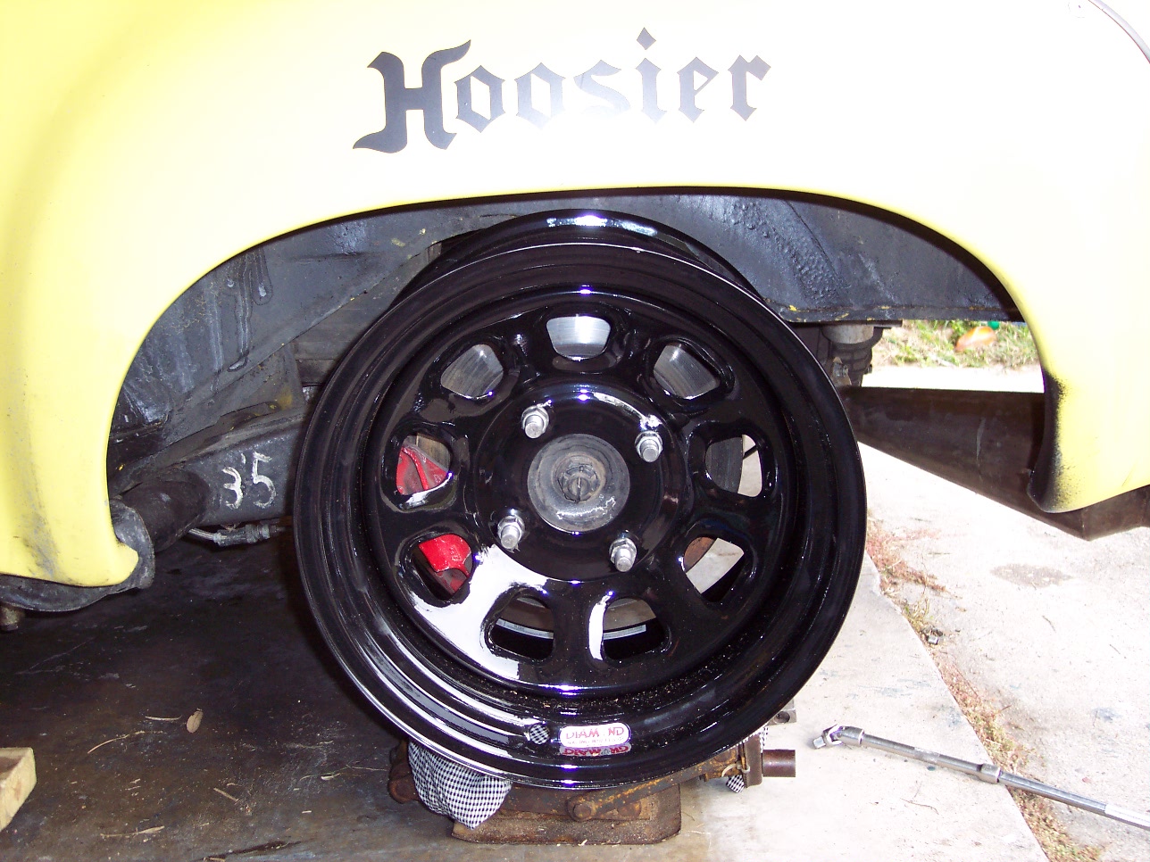

15 x 10 wheel and a 22 x 9.5 x 15 Hoosier slick PERIOD no bigger
I got my new wheels for the rear in Saturday. Diamond Racing made me a custom set in 6 days with shipping. Backspace is 5.75" and that's all that matters. 19 lbs and $295.00 for the pair shipped.

Joe Ricard   inside   Nov 19 2007, 05:50 AM
Joe Ricard   ain't this sexy...............   Nov 19 2007, 05:51 AM

URY914   What does the wheel and tire weight together?   Nov 19 2007, 07:33 AM
Joe Ricard   tire is 15 wheel is 19   Nov 19 2007, 07:38 AM

jhadler   Hey Joe, I'm curious to hear how close the in...   Nov 19 2007, 03:41 PM
Joe Ricard   Right now I am worried about ripping the suspensio...   Nov 19 2007, 03:41 PM

Joe Ricard   Fiberglass GT flares are held on with large head p...   Nov 20 2007, 05:54 AM
chris914   Fiberglass GT flares are held on with large head ...   Nov 20 2007, 09:13 PM
crash914   I would worry about sidewall flex....   Nov 20 2007, 06:31 AM
Joe Ricard   Shouldn't be too much as this is the size rim ...   Nov 20 2007, 07:23 AM

flesburg   We use 245-45 16s on our DE car. We cannot go wide...   Nov 21 2007, 07:47 PM
woobn8r   A 245 should be around 9.6" wide, a 255 about...   Nov 21 2007, 11:18 PM
