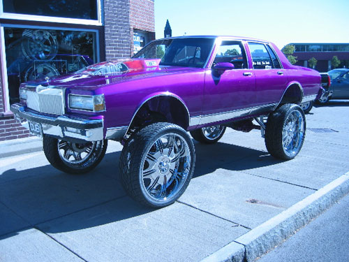

So.Cal.914
post Mar 5 2008, 03:43 PM
"...And it has a front trunk too."
Posts: 6,588
Joined: 15-February 04
From: Low Desert, CA./ Hills of N.J.
Member No.: 1,658
A DONK...Attached Image

You can't DONK a 914
A Donk is a mid 80s (non bathtub) Caprice
