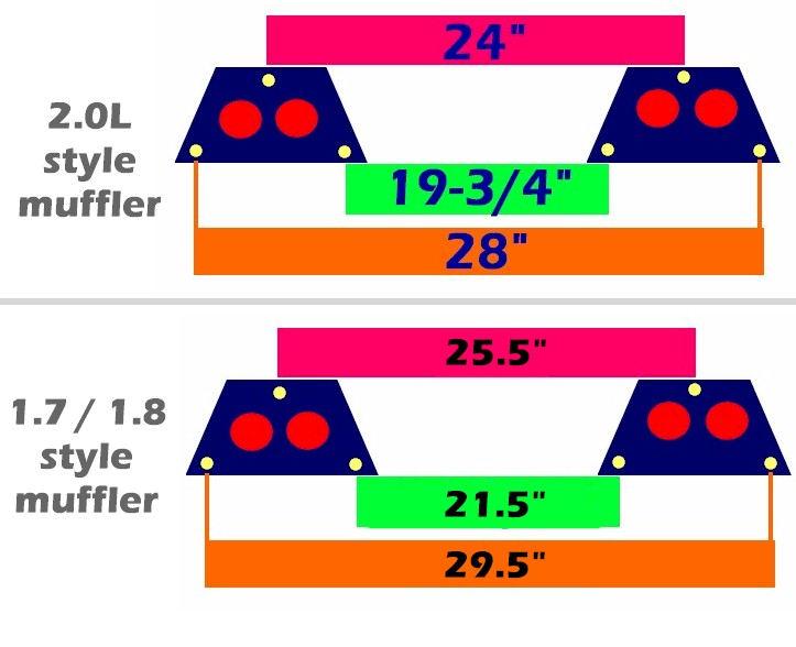

All stock Type IV cases have the same spigots for the cylinders. The registers in the heads are smaller on the 1.7s, but that's it.
The 1.7 exhaust (also the 1974-only 1.8) is smaller diameter than the 73-74 2.0 exhaust. The muffler ends of the pipes are also a different distance apart.
That said, any of the 914-4 exhausts will fit any of the 914-4 motors.

2.0 and 1.7/1.8 style heat exchangers will fit on any engine but you will need a 2.0 muffler and 2.0 muffler hanger to use 2.0 he's - and a 1.7/1.8 muffler and a 1.7/1.8 muffler hanger to use 1.7/1.8 he's.
there are several dimensions of difference between the two styles at the muffler end - at the heads end they are the same.

Here's a great diagram. Not mine but someone posted it here previously. If my memory worked... I'd remember who!
