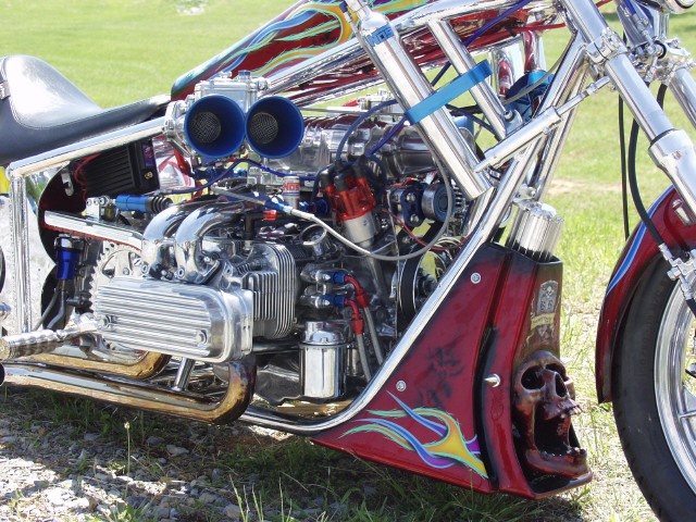

this guy has a supercharged type4 on his bike.

That's cool, Jim!
Thats what I want but I need to find some one who has built the intake manafold for a T-4 setup? Need pic's, and how-to info?

Hi, I will probably be disagreed with but a supercharger is driven off the engine, does basicly the same thing as a turbo. But the supercharger gives you instant boost. The turbo is driven off the exhaust, it use's no power from the engine to drive it. There is a 'Lag' but unless you are building a dragster or something like that chopper, I would sudjest talking to the fella's here that have turbo'd their teeners. Just My .02

(IMG:http://www.randakks.com/Randakk%20Supercharger%20Final%20Prototype%203.JPG)
I know, not a TIV. You might have to blaze some trails. Practically, I think you would be better off with a known 2270 build. But I'd sure be interested in seeing your experiments. (IMG:style_emoticons/default/popcorn[1].gif)

that setup would be E-Z to adapt to a t4 me thinks. looks darn sweet too.
but i bet it costs more than my entire car.

whoa, that chopper has a chrome oil filter....
bet you don't get those at Pep Boys (IMG:style_emoticons/default/screwy.gif)
