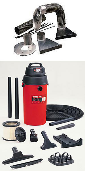

QUOTE(race914 @ May 20 2008, 11:24 AM) *
Heat buildup can cause alot of problems.
Thats a good kit, Or you can get the Home Depot version. (IMG:style_emoticons/default/biggrin.gif)
