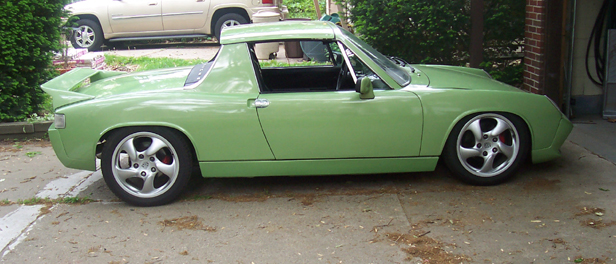

Just got home from a little vacation with the family, went to pull the teener out to take to the store and noticed that the pass side front was extremely low to the ground. Checked the height adjuster and it it loose, I can move it by hand, so I can only assume that the torsion bar has snapped. Good thing it happened in my garage I guess. Seems kind of wierd that it would just go like that.
Anyhow, what size bars should I get? Its a SBC car with 200# springs in back, mostly a street car with an occasional trip to the track. I have a 19 mm sway bar in the front as
well. I liked the way it rode/handled with the stock bars.
It has the stock 914 suspension with 911 struts.
Any sources?
Any tips for the removal/intstallation?
Will any 911 bars go right back in there?
Thanks

Thanks everybody, I think I will keep it stock, it rode pretty nice, even with the 17s. The car sees more street/big track time than autocross, so I will leave it softer. the swabar is adjusrable, so I can do some dialing with it.
I just had the car aligned after the turbo tie rod install, here goes another pile of money....
Mark
Wannabe 914-6 owner
post May 28 2008, 10:01 AM
Posts: 190
Joined: 3-July 07
From: Prather CA
Member No.: 7,866
I really like the look of your car, especially the spoiler. Is that a off the shelf piece, or something that you fabricated. Very nice car (IMG:style_emoticons/default/biggrin.gif)
