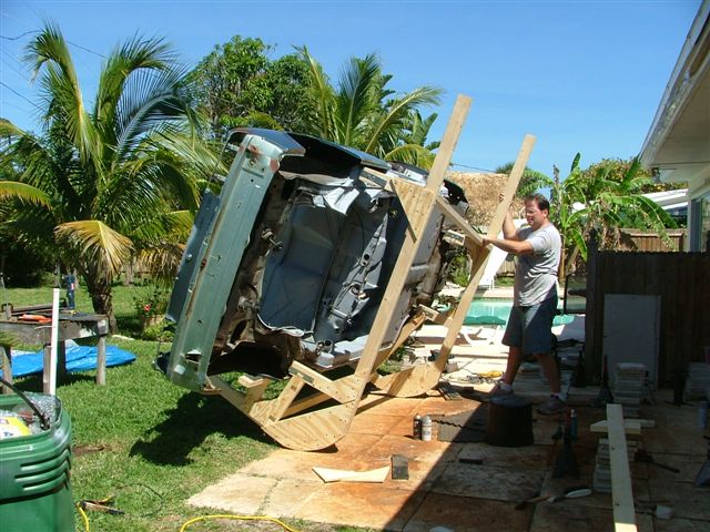

Anybody got a picture of the wooden "Rocking Chair Rotisserie" that was posted a while back? That was pretty cool! (IMG:style_emoticons/default/aktion035.gif)

Anybody got a picture of the wooden "Rocking Chair Rotisserie" that was posted a while back? That was pretty cool! (IMG:style_emoticons/default/aktion035.gif) You mean this one from FourBlades? ![]() Here is a link to more pics in his progress thread FourBlades Rotisserie(?). Pics start at about post #57. Jim |

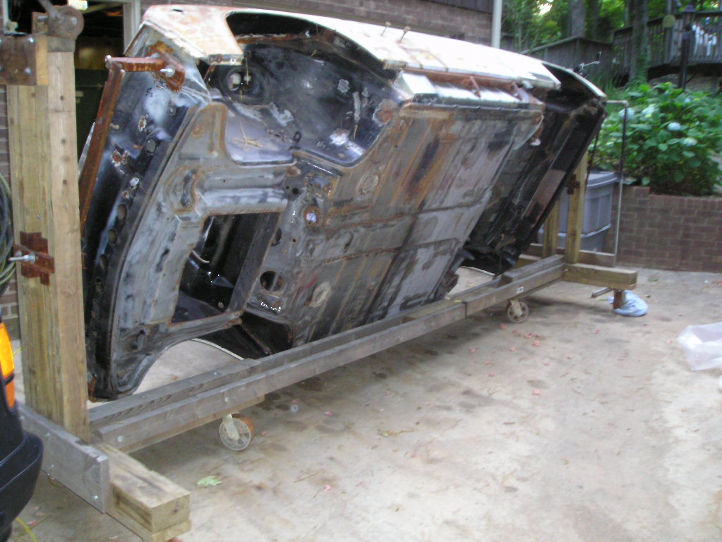

I remember seeing pics of a steel "rolling" type that bolted to the wheel hubs. Anyone remember that?

Anybody got a picture of the wooden "Rocking Chair Rotisserie" that was posted a while back? That was pretty cool! (IMG:style_emoticons/default/aktion035.gif) You mean this one from FourBlades? ![]() Here is a link to more pics in his progress thread FourBlades Rotisserie(?). Pics start at about post #57. Jim That's the one. Probably the most innovative non-welding approach I've ever seen. And damn funny too! (IMG:style_emoticons/default/av-943.gif) |

I like how he has it in the back yard next to the patio and pool.

I like how he has it in the back yard next to the oatio and pool. (IMG:style_emoticons/default/agree.gif) If things don't work out, he can make it into a giant pool toy! |
