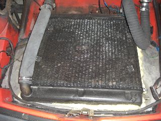

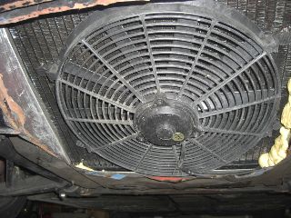

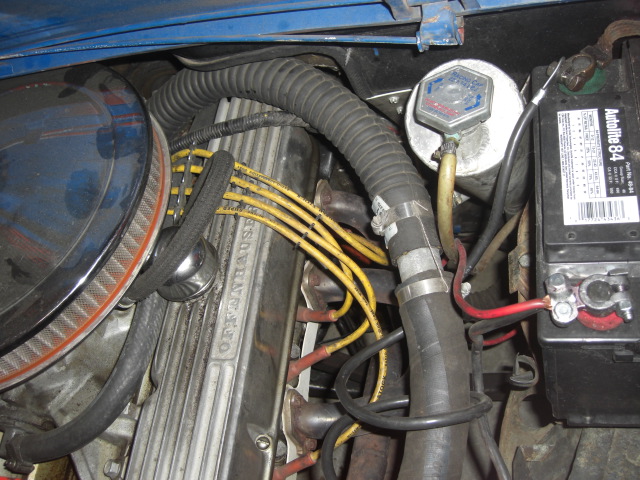

Here are a few pics of the setup. Shoot I think I replaced a thermostat in high school once? I can't even remember where the dang thing sits in the system. I'm hoping my buddy with the shop isn't taking next week off. That will screw with my plan no doubt. I'll have to bone up on flushing my radiator if I have to do it myself (IMG:style_emoticons/default/blink.gif)

man...is that radiator pointed down and where the AC condensor used to be?? If thats the case, you need some CFM to cool that baby down.....especially where I live from all the radiated heat off the asphalt!
Also any better pics of your overflow setup? The thermastat should set in the housing of the elbow where your radiator hose enters the block...

It is angled down for sure. It basicaly starts under the bumper. Just the valance is cut. I definatley want to get a better radiator setup. Just not enought time before WCR. I'd like to get it servicable for all the drives. I can replace the whole setup later. Don't have the cash to do a complete new setup right now anyway.

That setup is not the best way to go about it. When the air temps are at 100 deg the cement in bumper to bumper will be like 120 or so and the radiator is pulling from that extreme heat situation. You also dont have optimum flow at speeds either as the air will take the least difficult way around.
Best advice I can give is to do a system flush, check for lean running of carbs, check spark plug gaps and timing, move your fill tank higher, and save your pennies.
You should also switch to a puller fan VS a pusher fan so that the physical fan does not block the airflow either. Maybe run a small pusher as a backup for bumper to bumper. Also add a can of Water Wetter by redline, dont run antifreeze (its less efficient than pure water), and run a higher pressure cap(19lbs?). Oh and change your oil to a synthetic with a good filter (mobil 1 is good)
