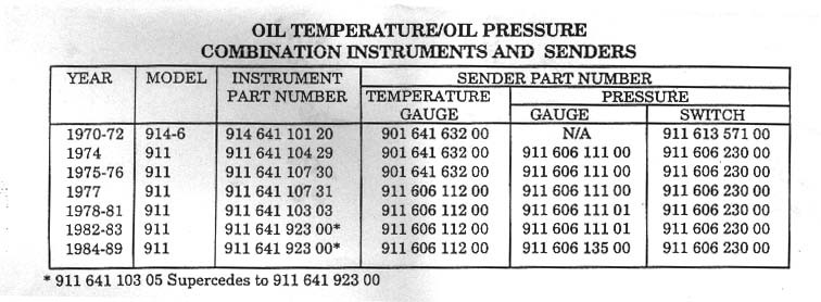

QUOTE(ClayPerrine @ Jul 5 2008, 04:36 PM) *
Get me the part number off the gauge. I can get it cross referenced to the correct sender.
part number of the gauge, then look up in the chart below ...

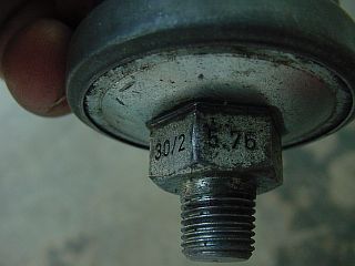

Here's what the 911SC guy from the bird board sold me with his NOS gauge for my Ghetty dash. Won't swear it's correct...just going off his advice.

That's a pressure and idiot light sender, which is what I'm looking for. Does it have a VDO serial number?

VDO Dual sender units
VDO 360-006 = 0-80PSI for gauge 7PSI for light #30/2
VDO 360-023 = 0-150PSI for gauge 7Psi for light #30/23
Thread size is M10X1 on both
Hope this helps you
