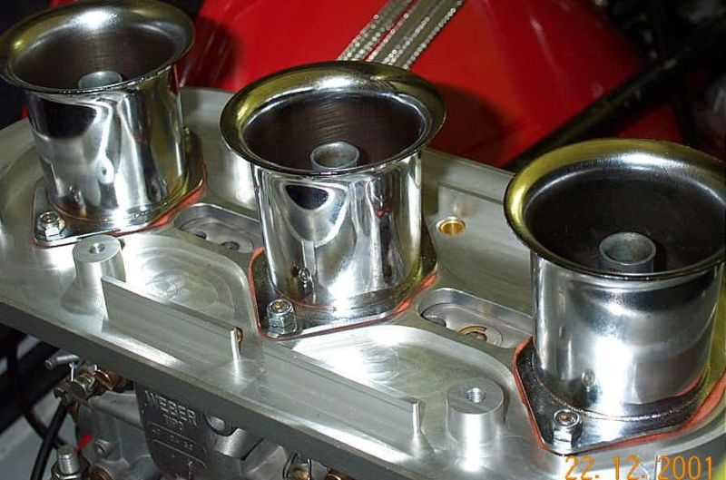

The best place is Pelican's 911 classifieds, IMO. The classifieds of Panorama also has a some old style stuff. My Solex cams came from there....one NOS-sill-in-the-box & the other fresh from a touch-up by Web Cams.....center-oilers. My latest find on Pelican was a NOS set of Mahle 10.5 :1, 90 mm P/Cs. They were posted about 15 minutes before I bought em'. (IMG:style_emoticons/default/biggrin.gif) Stuff like this does not come along often but the timing was perfect.....blew my rebuild budget to hell tho.
I forget exactly where I got these....no matter, these are not often seen F/S. I think they are a good torque booster.....old pic. of long aux venturi peeking out the stacks.
That's what I remember mine looking like, so here's the $46 question - is that picture of 40's or 46's? (I can't -quite- read the data tag on the body...)

40s...sorry about the lousy pic. (IMG:style_emoticons/default/biggrin.gif)
Actually it's a great pic, it's just a lousy data plate. I have a hard time reading the little numbers on the real carb when it's in my hand.
With scant evidence to go by, I think I'm about to conclude that the aux vent height on both the 40's and 46's is (about) the same but the 46 stacks are taller and the aux vent's don't come up as high into them.
One of these fine days I'm gonna hafta actually inventory what I got in that buy so I'll know what parts to be on the lookout for. I'd probably spend stupid money for something it turns out I already had (and I hate when that happens...).
I'd love to see a picture with a 40 and a 46 aux vent side by side - with a millimeter ruler...
