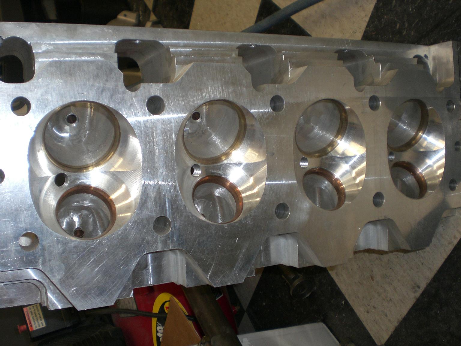

sample

not do discredit anyone, but a real question.
Is the picture just funky or is there a significant texture to the bottom of the combustion chamber?
If there is a texture, please explain what the benefit is and the rational.
Rich

I should have clarified what it was I posted, sorry.
That is a CNC milled 2L chamber. The texture is what is left behind by the mill and is very very fine.
Possible Applications for this 2L program would be,
1. CNC matching combustion chambers by milling both heads in sequence then surfacing both heads in sequence. The end result is perfectly matched chambers
2. Restoring heavily damaged and welded heads to their stock shape, matching in the process.
3. Creating 2L chambers on 1.7L/2L bus heads, after welding and relocating the spark plug hole.
This is one of Don's heads.

oh, cool.
So he has a CNC program all setup to replicate the chambers in the heads....that is cool.
I assume that the finish would be different in the final product???
Does he do welding? Fix cracks?
The price seems really low for seats, welding, CNC, etc....
Is there a full monty price for a standard 2.0 liter head that has cracks?

He can bead blast them lightly for a fine texture, the finish you see there is quite smooth.

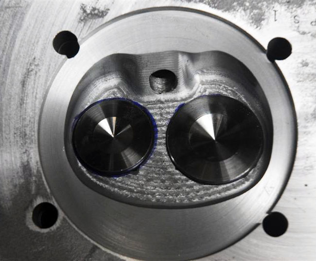

I don't think I've seen many (if any) CNC heads (not just VW) that have the milling marks removed. The depth of the highs and lows is probably less than stock casting texture.
Check out the CNC pattern on these guys (view the full size image).
