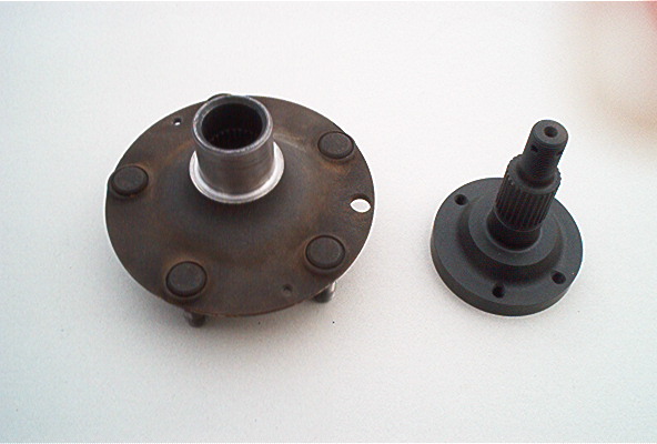

post Jan 9 2004, 02:49 PM
Posts: 158
Joined: 21-August 03
From: Venice, CA.
Member No.: 1,056
No need to get them from germany we have them right here in Venice beach. Early Hub shown with our 914-6 Stub axle made by Aerospace Machine Shop for us.Otto

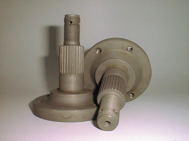

post Jan 9 2004, 07:04 PM
Posts: 214
Joined: 9-November 03
Member No.: 1,324
The stubbs are Made from a Super duty M 30 Alloy they are $245 each Here are the ones Sven's selling At 1 euros to 1.28 dollars they are $ 242 + shipping and customs fees. Steve
