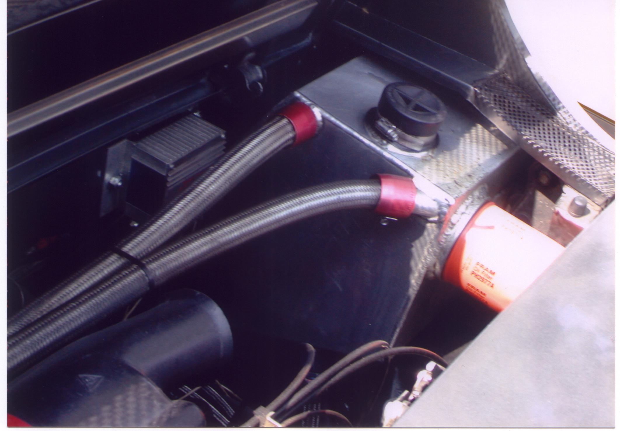

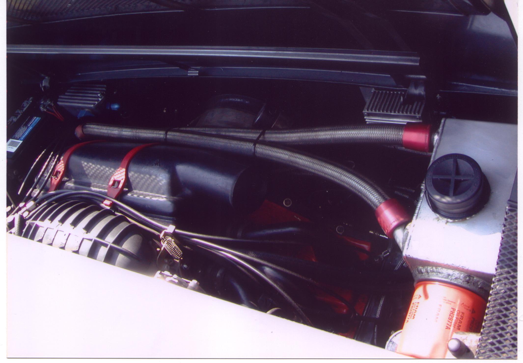

The 'Aftermarket' tank is a Stevens Machining 20QT. tank, designed to use diesel oil filters. When I talked with Mark Stevens about this (waaay back when in 1987), he preferred the diesel engine filters because of their greater flow capacity & finer particle filtration. I've never tried a Mahle filter on it (have several Mahles since we have a bone stock 911SC). The o-ring diameter is the wrong size and the threads don't match either.
I have Mark's prototype pre-production oil tank. After 20 years, ~200K miles, ZERO engine failures, I guess the 'Aftermarket' oil tank and the FRAM diesel oil filters really 'SUCK'. I lost the original filler cap and haven't found a decent replacement yet.
Yep, that's a Permatune, too. Been there for 20 years, ~200K miles. One time I thought it had failed, I was mistaken.
