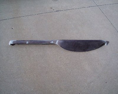

I just used Bondo's bumper repair kit to fix the targa seal on the 73. Actually really nice to use. The seal had 2 4" long flaps that were sticking straight up. The bumper repair kit comes in a 2 cylinder epoxy syringe. Just mix up and apply lightly, then sand it down to match. Two or three applications and now you can hardly tell that the tears were there. Fairly flexible, so I am confident it will last a while. We will see.
