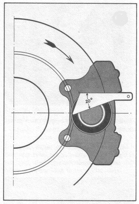

3. The pistons have to be installed (rotated) as shown in the following diagram.
(IMG:http://www.performanceforum.com/wesvann/914a/piston-angle.jpg)
This places the lower "stepped" surface of the piston in the upper position.
It's not due to the pad having an "index'd" matching surface (the pad just has a flat surface), and as such I've got to ask why it matters? (I have to assume it's so that the initial "bite" of the pad is lessened on the leading edge)

3. You are correct. By lowering the face of the pad slightly into the oncoming rotor this helps stop squealing and bed the pads properly. Others recommend chamfering the pads when re-padding the brakes, but with the step piston ATE made sure this is not needed. Put them back in properly. If you don't have the clips (which no longer come in the kits) then look at your drawing above and place the lower edge of that notch on the centerline. Clips are not necessary.

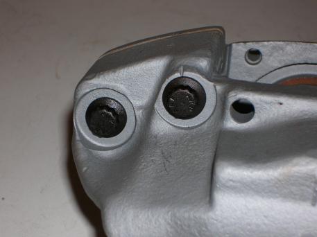

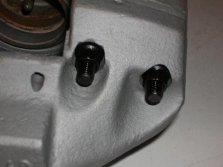

So, here is what I did;
I went by ARP and picked up 1/4"x28 bolts and nuts. 1/4" is slightly larger than the original 7mm.
(IMG:http://www.performanceforum.com/wesvann/914a/bolt1.jpg)
(IMG:http://www.performanceforum.com/wesvann/914a/bolt2.jpg)
They are installed with the head of the bolt on the opposite side from the original configuration due to the the shoulder on the bolt head being larger than the shoulder on the nut. The shoulder on the nut just barely fits within the cavity on the caliper body. The shoulder on the bolt head doesn't fit.
No special tools. Just a 5/16" 12 point deep socket.
Total cost for both calipers was $22.35
Now I expect to hear about them not being strong enough!
Wes

I measured the shank on the original Ribe bolt and it has a diameter of 0.248". It steps down from the 7mm threads.
The shank on the bolt from ARP is 0.249". It's pretty much the same diameter as the threads.
My wording of 1/4" being larger than 7mm was wrong.
