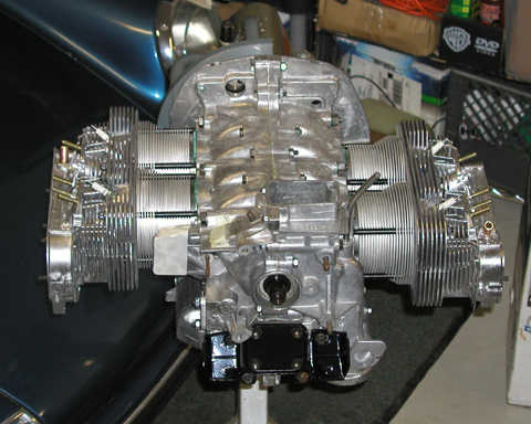

96mm Biral Barrels $650.00 Ebay
96mm Cast Pistons $265.00 Type 4 Store
78.4mm stroke c/w crank $530.00 Type 4 Store
Type 1 Billet Rods 5.4” $340.00 Type 4 Store
Custom Camshaft $180.00 Type 4 Store
Modified Cam Gear $ 42.00 Type 4 Store
Manton push rods $ 52.00 Type 4 Store
Pushrod Tubes $ 25.00 Ebay
Main Bearings $ 52.00 Type 4 Store
Rod Bearings $ 22.00 Type 4 Store
Gasket Kit $ 45.00 Ebay
Rear main Seal Viton $ 10.00 EBS Racing
Cam Bearings $ 11.00 EBS Racing
Type 1 30mm oil pump $ 50.00 Gene Berg
Oil Pump Cover $ 10.00 Type 4 Store
Oil Strainer $ 12.00 Type 4 Store
Rocker Arm Spacers $ 25.00 Type 4 Store
.090” Cylinder Shims $ 70.00 Type 4 Store
Curil K2 Sealant $ 15.00 Type 4 Store
Curil T Sealant $ 15.00 Type 4 Store
Dirko Sealant $ 15.00 Type 4 Store
Camshaft Oil Plug $ 4.00 Type 4 Store
Intermediate Balancing $180.00 Type 4 Store
Machine work on Case $150.00 Local Machine Shop
Total Engine Parts/labor: $4870.00 (your costs may vary)
