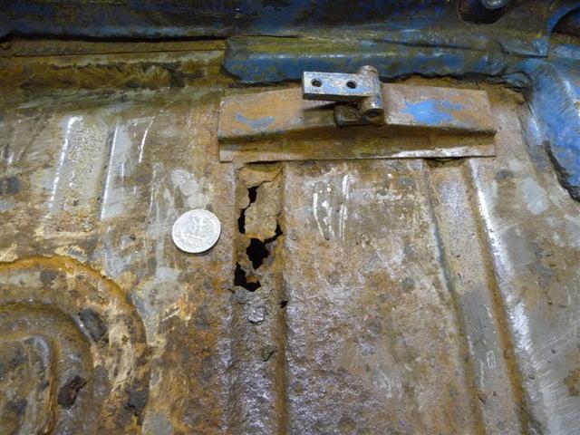

I have some rust under the seats (surprise!). I had planned to just use "POR15 Patch" on.
But maybe I should get a couple of these patched with steel&weld?
Welding is beyond my capabilities so I'd have to find a local shop to do it - I don't like others messing with my car plus $$ (IMG:style_emoticons/default/sad.gif)
Opinions?
Driversside...

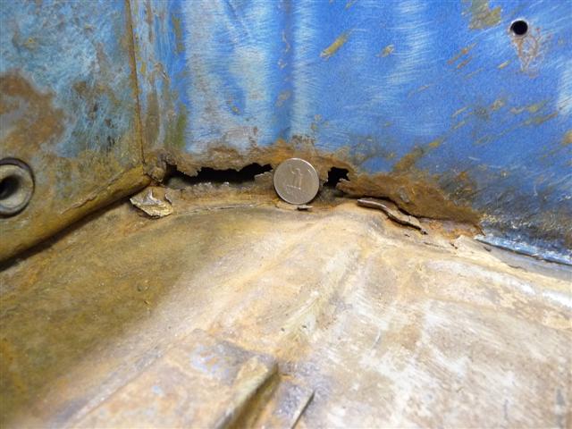

Driverside firewall...

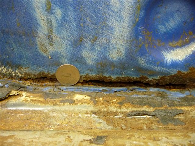

Pass. firewall/door corner...

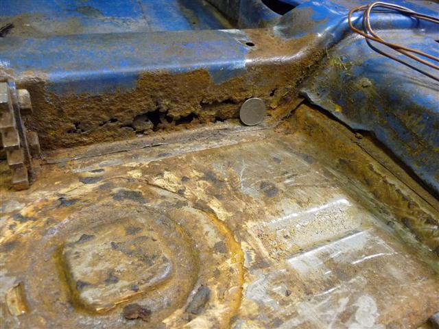

Possible structural issues with this one...

Looks like you had some water sitting on those floor pans for a while ...
That needs to be welded! (IMG:style_emoticons/default/welder.gif)
Find someone who is good with a welder and preferably has worked on a 914 before. I'm not sure who's out there with you in "the schticks" but if the car runs, drive it up to Napa and drop it off at McMark's Shop. His work is top notch and affordable.
http://www.paintandmetal.com/
(IMG:style_emoticons/default/bye1.gif) Andy

Looks to me that you don't have much of a choice - that needs to be repaired by welding. If it was the rear trunk area, then who cares? But this is where your Butt sits. You certainly don't to experience a floor failure here.

That needs to be welded. I second the McMark nomination... But be warned. He sometimes dresses funny. By the way, someone dropped a bunch of quarters in your car!

To big for POR.
Cut and Weld.

That's way beyond anything you can buy from POR15. You've got a lot of corrosion there, and I'm 100% sure there's more you haven't found yet, or just can't see. If I was in CA, I'd try to find a solid southern CA donor chassis. Yes, it can be repaired, but it ain't gonna be cheap!

Sealer has been dug out and there isn't anymore inside - the pictures show all of it. No problems with the "hell hole(s)". I'm afraid to look under the rocker panels.
