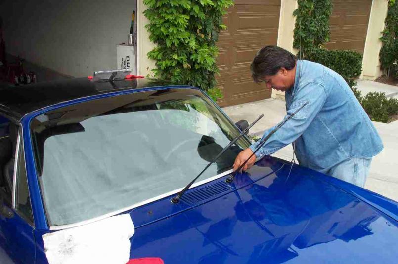

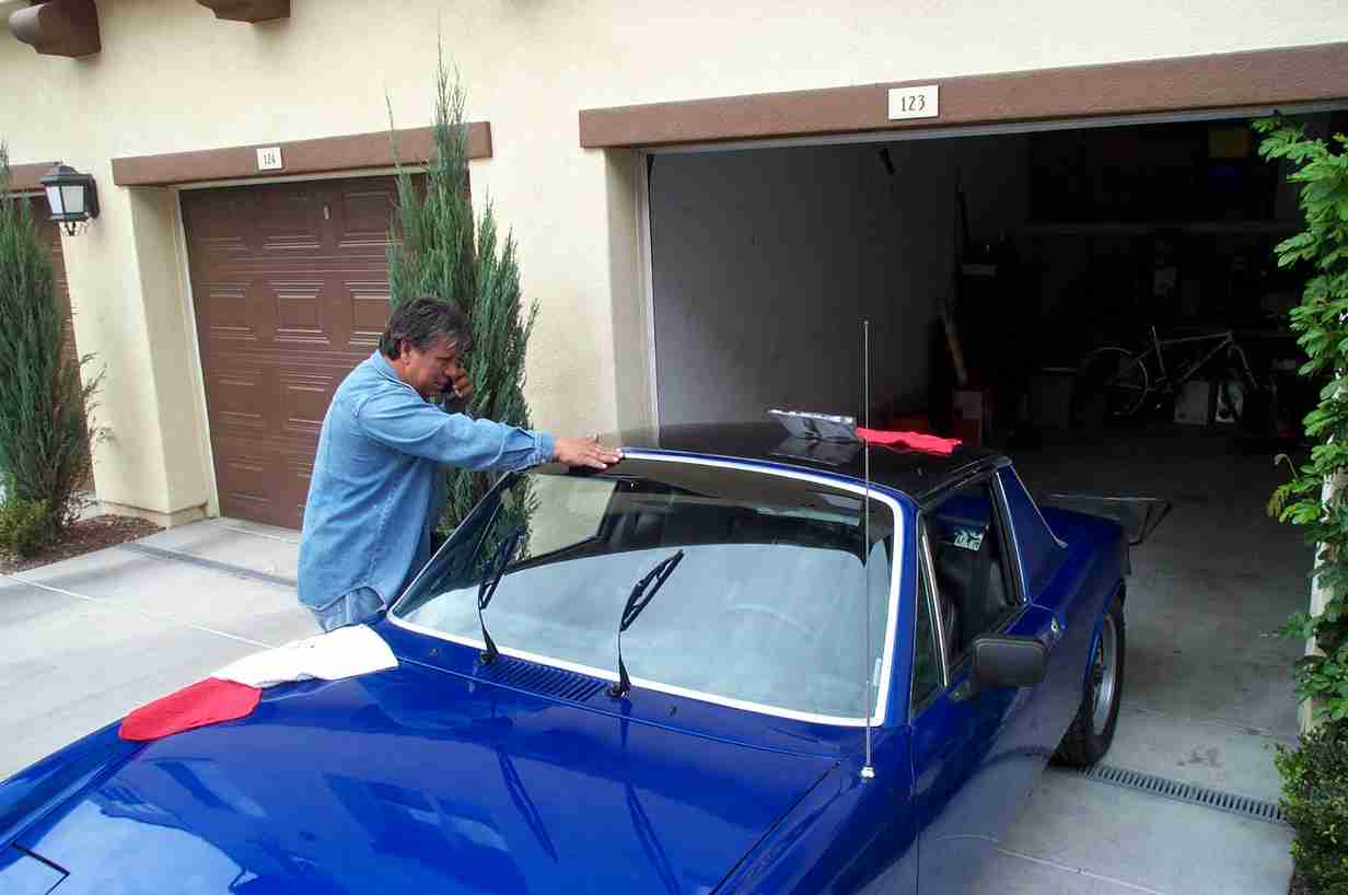

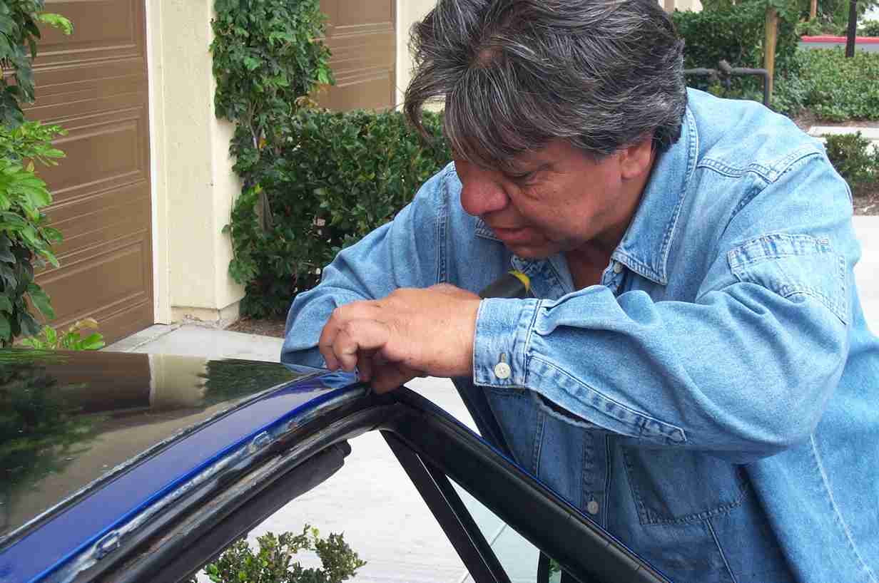

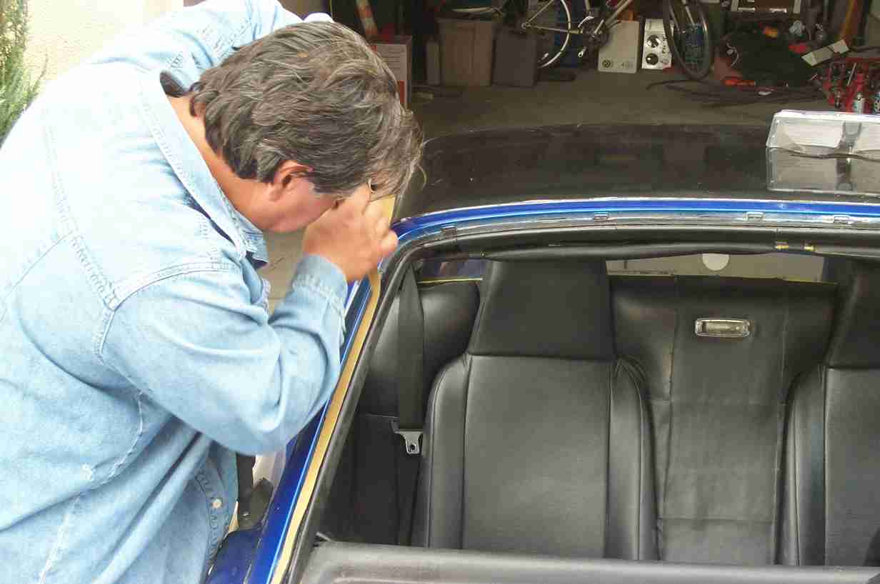

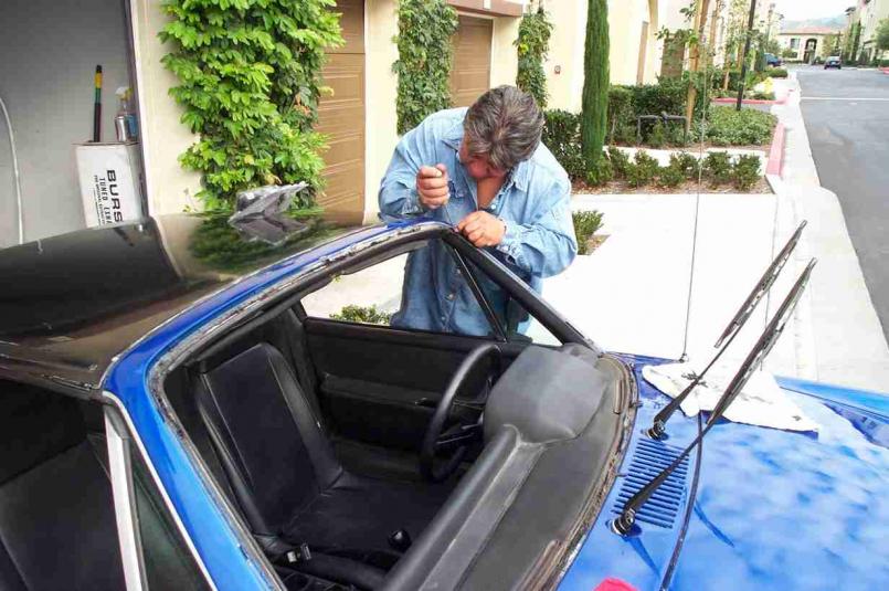

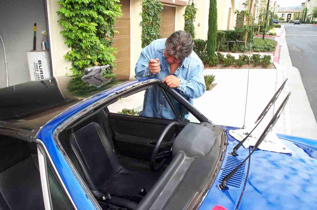

I got my 914 out of the paint shop on Saturday morning, and spent the weekend replacing all the pieces parts. My window was badly pitted and hard to see through in night driving. I know the window had been removed about five years ago when some major work was done, but Rufino confirmed that the old windshield had been replaced.

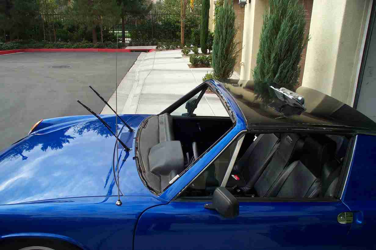

Car with windshield removed.
Rufino cleaning all the channels and making sure the clips for the trim are solid.

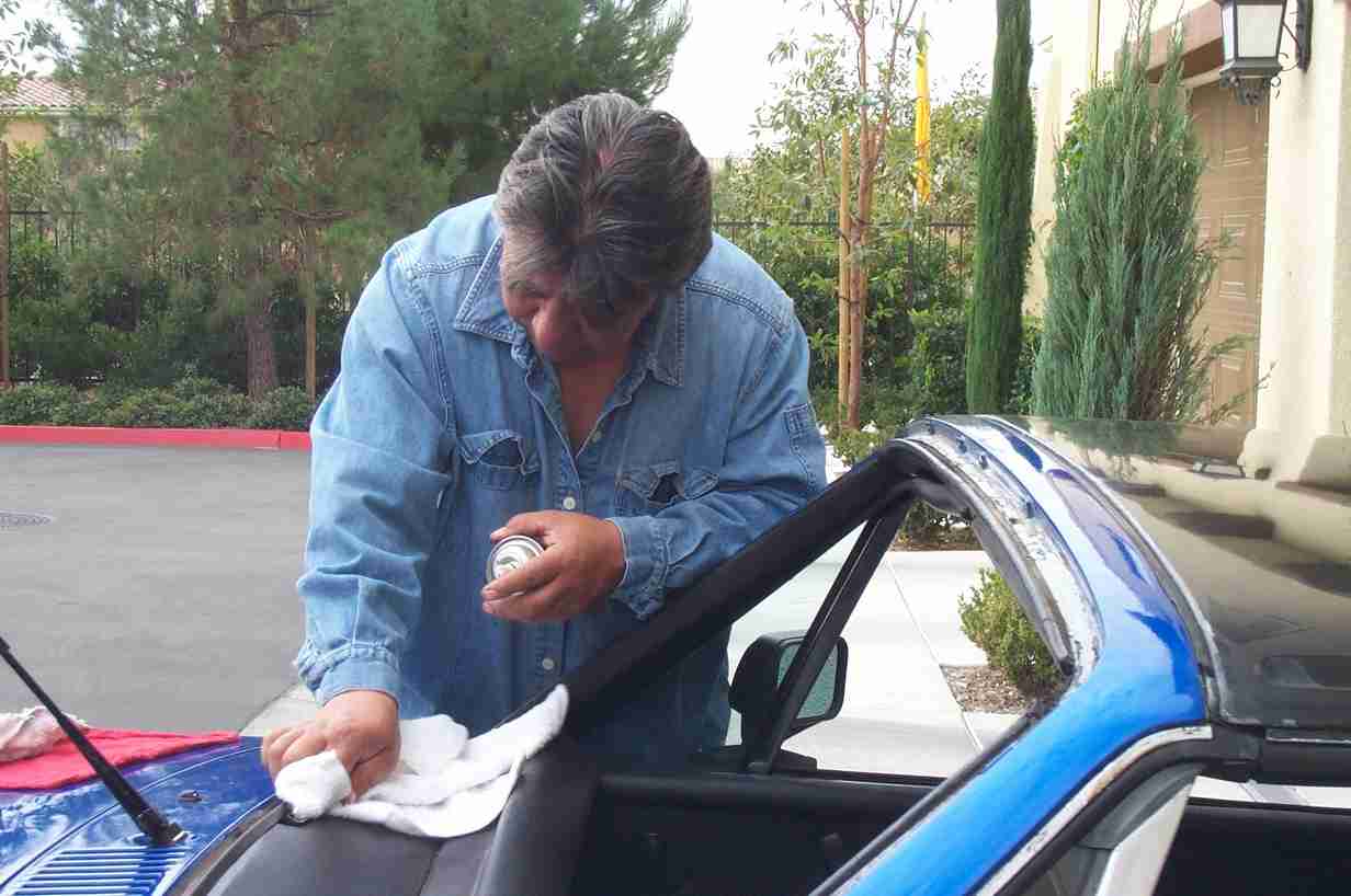

The channel all gets cleaned and primed with rust resistant primer.

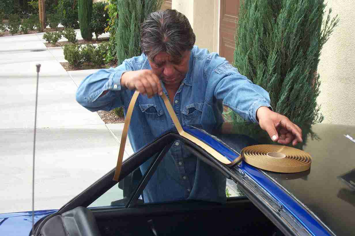

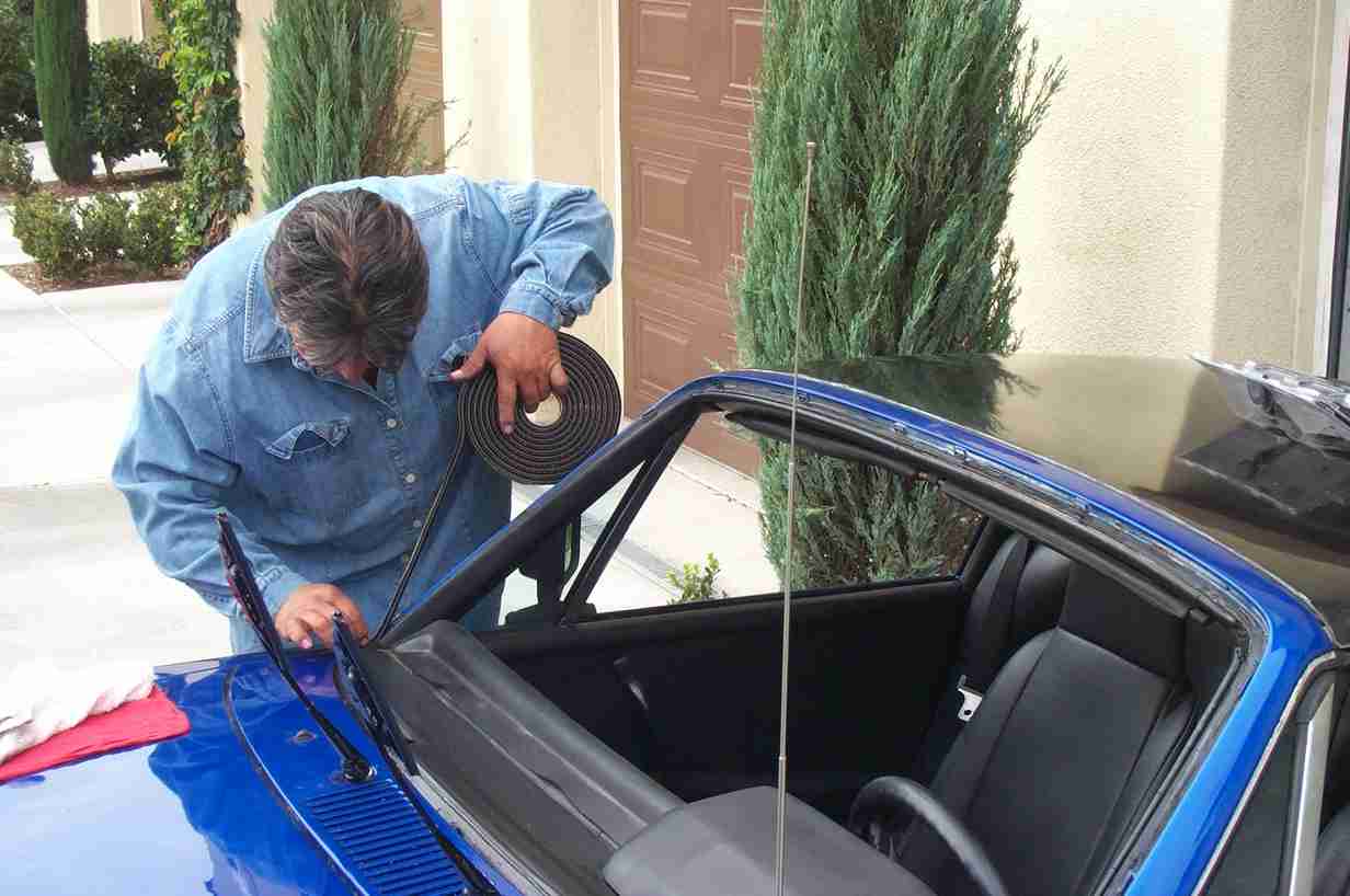

Installing the butyl tape.

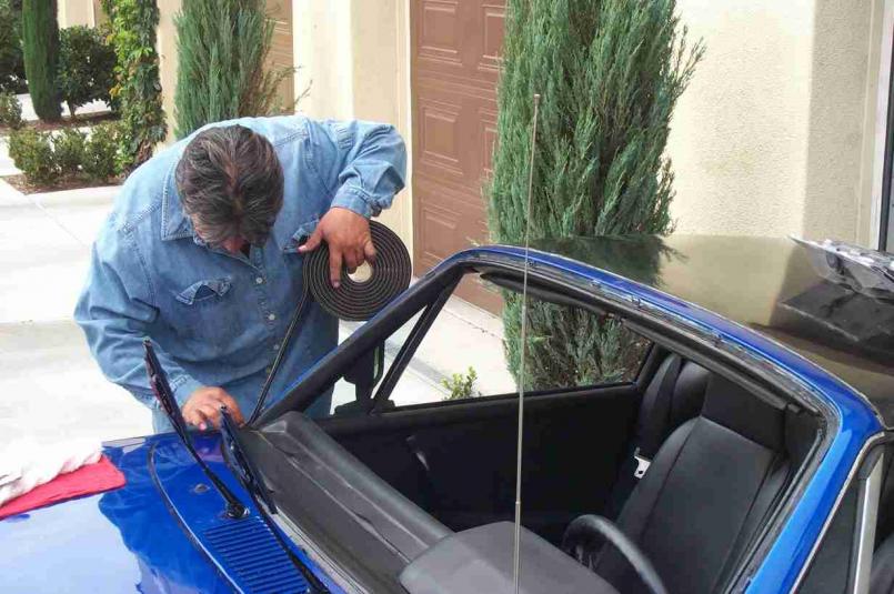

More butyl tape.
And another of the tape installation.
Rufino found a missing trim clip, so he reams out the attachment hole, and installs a new clip.

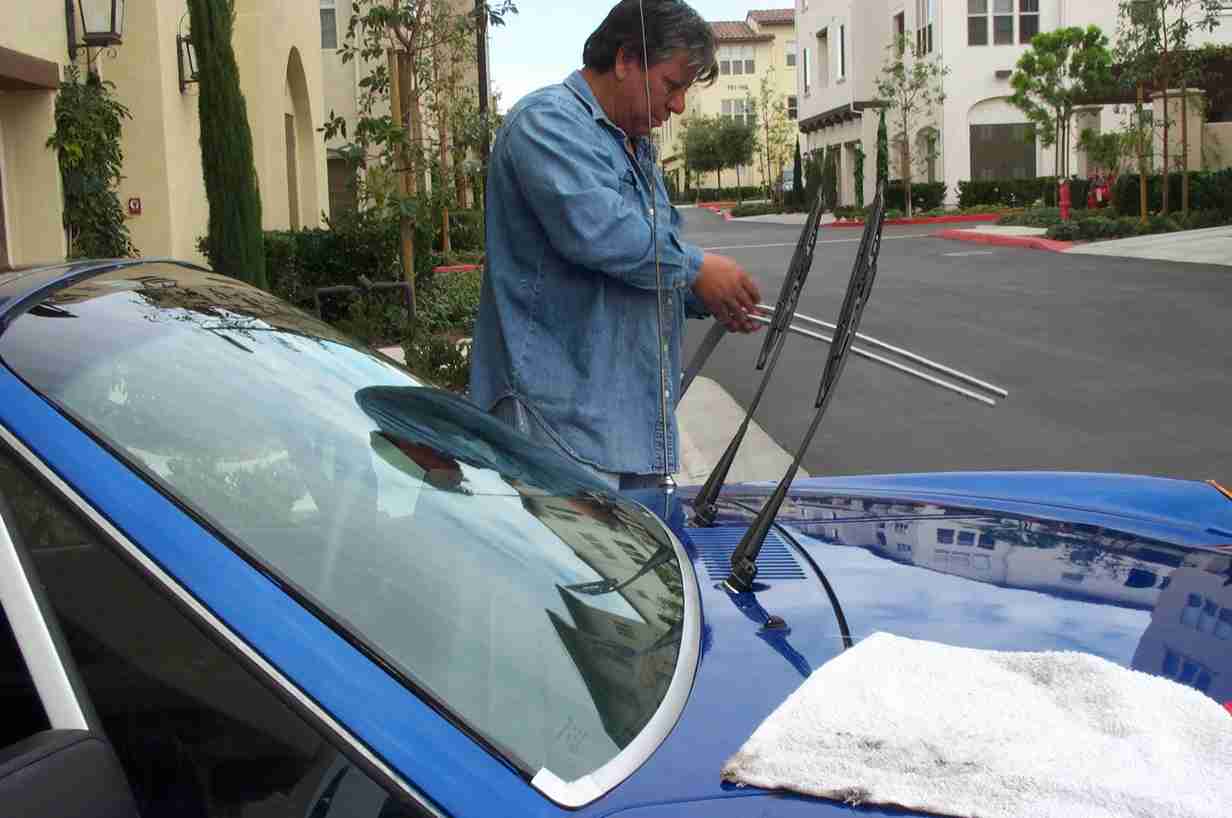

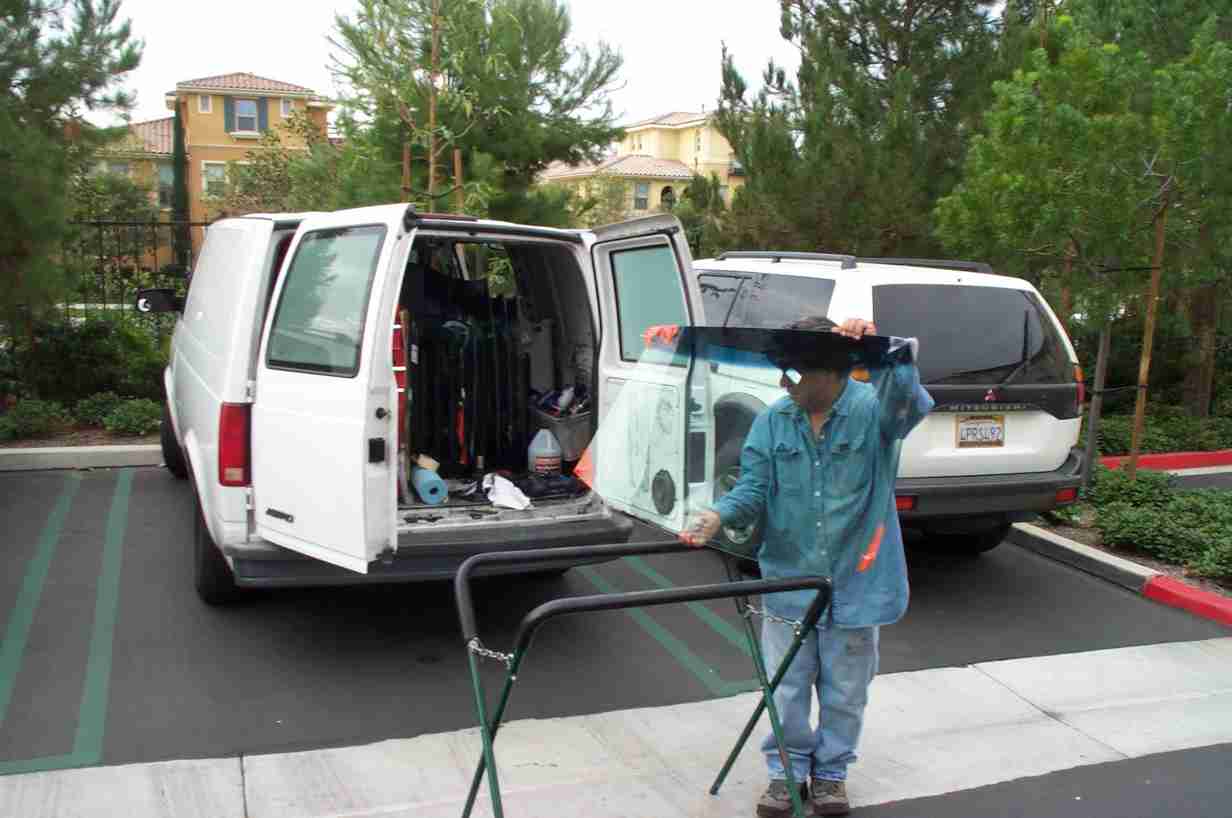

Windshield Replacement - Part Two

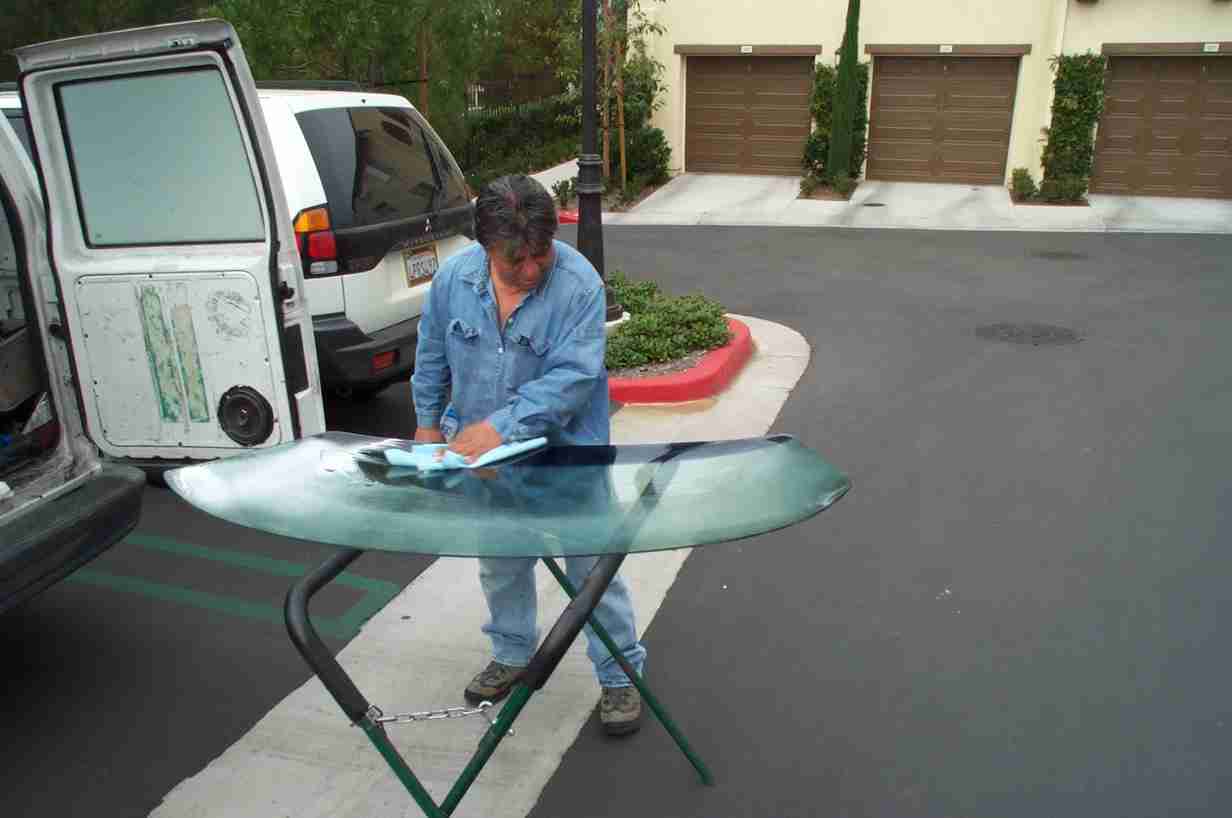

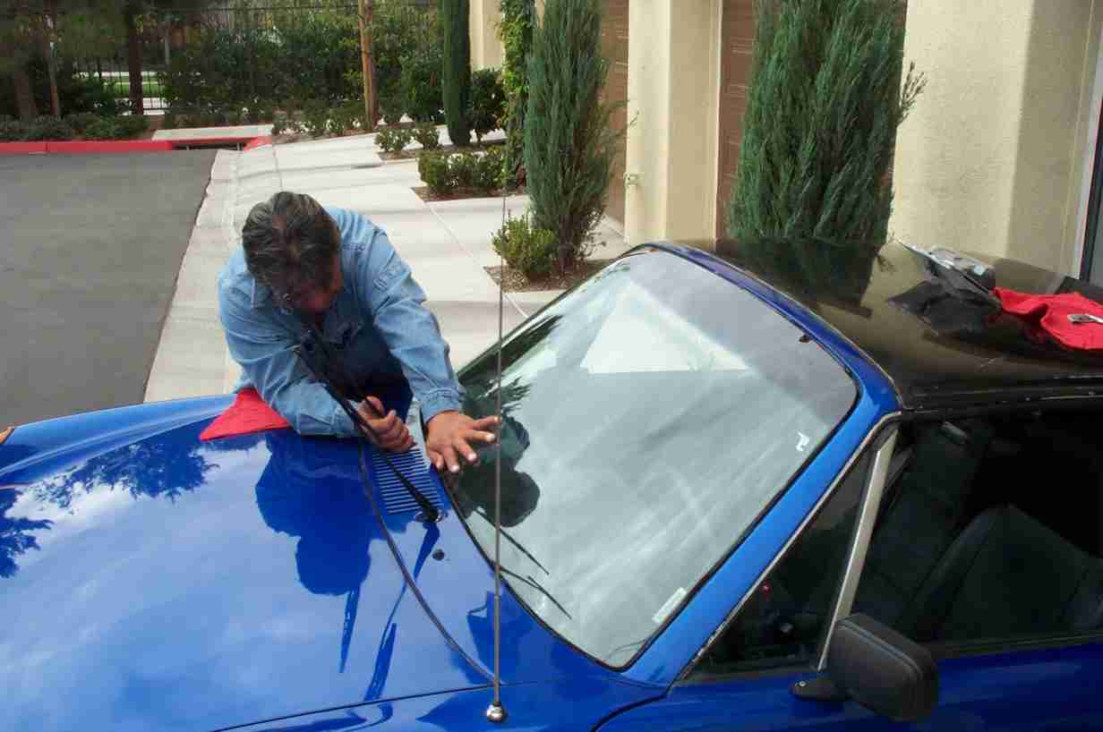

The windshield is thoroughtly cleaned.

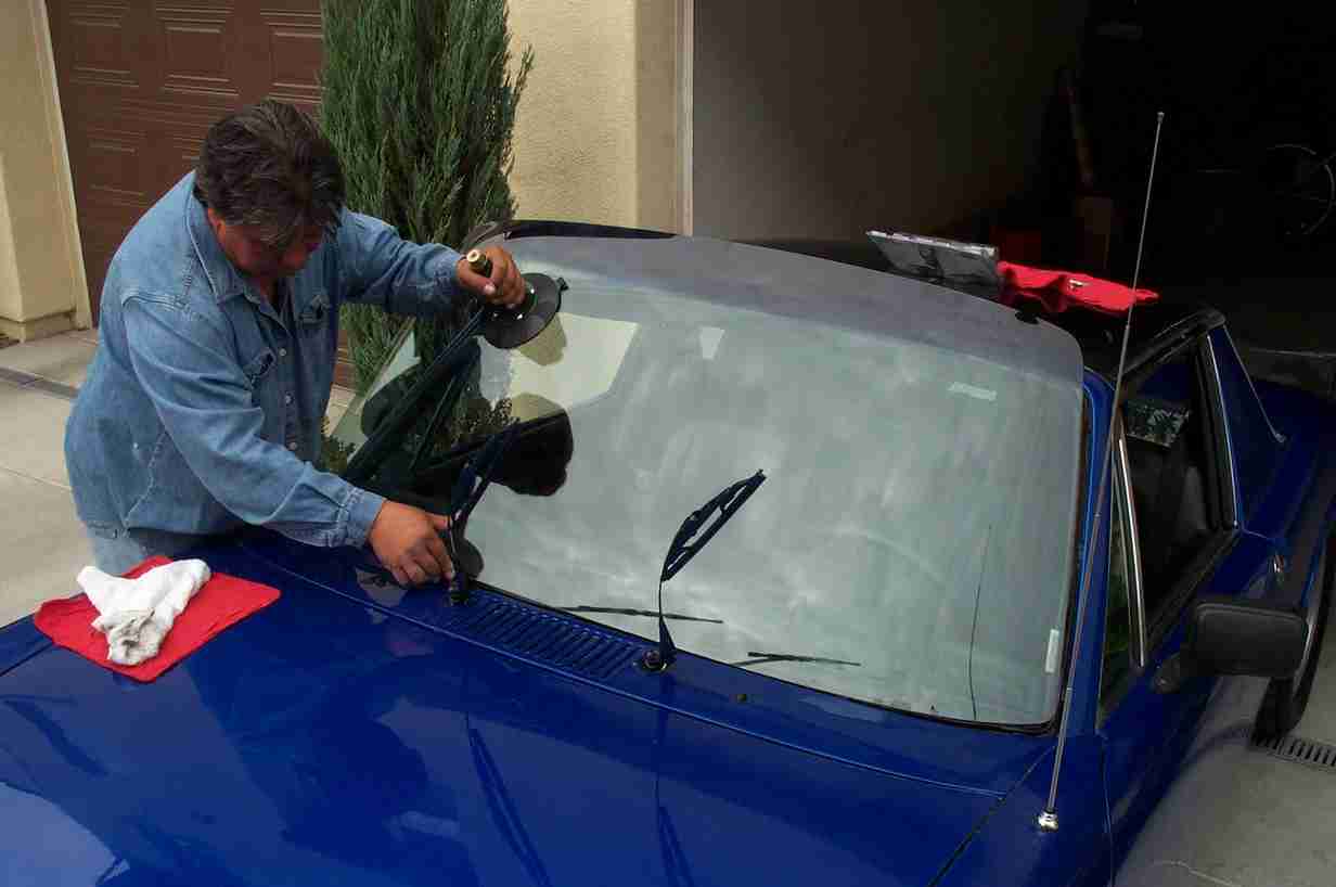

And carefully positioned.
Pressing the windshield into place so that the butyl tape holds.

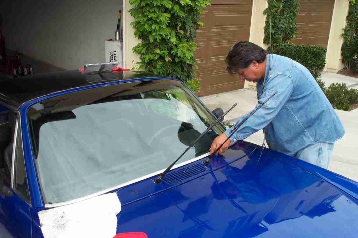

The window trim had been painted black by the PO. I sanded the old paint off, and rattle-can sprayed it with a high-reflective silver paint. After carefully straigtening the trim, Rufino presses the trim onto the clips
I probably should have labeled the right and left trim pieces when I removed them...
And the job is completed.
Rufino carefully cleaned any smudges, and installed my new rear-view mirror.
So, including the cost of the tinted windsheld (which prerfectly matched the size and shape of my old windshield), what was the total price out the door? $205 for parts and labor, all performed at my residence.

The butyl tape used comes off the roll as a tube of the butyl compound which is about .3 inches in diameter. The tube of butyl seals the windshield to the frame.

"The black painted border, or frit as its called, was betaprime 5500SA. It comes in a tube with a shoe polish like applicator. No masking was needed. Just a steady hand."
Rufino installed the "Frit" immediately prior to installing the Butyl tape. That's one thing I didn't take a picture of... (IMG:style_emoticons/default/confused24.gif)
Rufino initially tried to install it using the square applicator pad, but found it didn't cover well enough. He then went over the channel again with a small amount of the compound (which he had poured into a small container) applied by use of what looked like a cotton ball on a stick.
