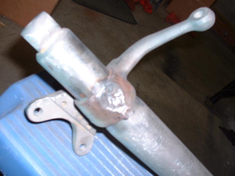

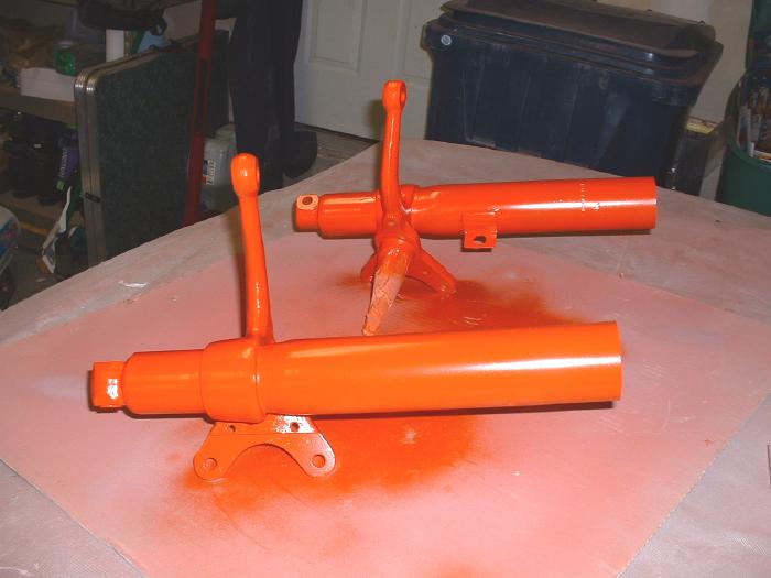

I have fairly early (still have the late model ball joint pins though) Koni struts on both of my cars. Both have had the spindles raised. I say this because on a Koni strut, you have a reduction in the tube where the spindle slips on. You can literally only raise it 18mm before you hit the flare. Boge's are different.
A 911 Boge strut is basically the same as any 914 Boge strut except the spindles are beefier on the 911 variety.
The main difference between the two is the fine (Koni I believe) threaded top and a more coarse threaded top on the Boge. That and the caliper mount spacing of course.. the Koni and Bilstein struts have the 3.5" mounts.
I'm no expert on this but, from working with mine, that's what I saw.
If you are planning on buying Koni's new, you may want to have them special ordered with the 914 valving. It's not "that" much different (only the high-speed rebound is different from what the Koni engineer told me) but it may make a difference.
Here's a bad picture that shows the difference in the tube (that old camera was actually dying Aaron... so don't post the flower icon macro bla,bla,bla (IMG:style_emoticons/default/biggrin.gif) ):

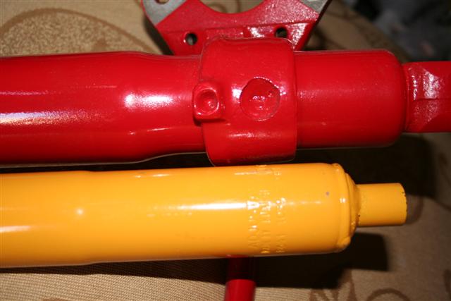

Here is a photo of my KONI strut and the 8641-1039 Sport insert. You can see the where the strut necks down. The insert also has a slight neck, but it is high up enough to not bump into the neck on the strut. I wish I had the 914 specific insert so I could see the difference, but my understanding is that the neck on the 914 insert just barely hits the neck on the strut. But just enough to not make it work.

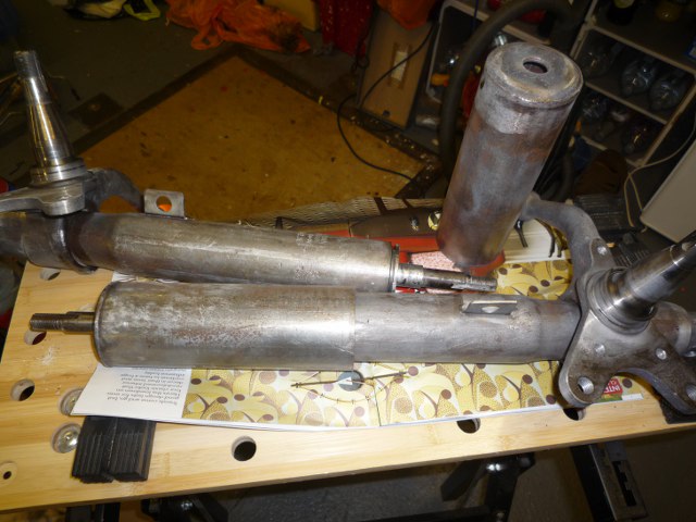

Apologies for the hijack but I think I might be able to learn something from you guys. I have acquired a pair of Koni struts with the 3.5" spacing. I have had these soda blasted. These are the adjustable type where you have to turn the whole thing. Is there an insert I can put into this which is no longer adjustabke or is adjustabke at the top? If so any suggestions as to the part number. I have read this and another thread and I am more confused then before. The part number on my struts is 911 341 042 10.
Or should I just get a replacement pair and set them to the softest setting?

Eric_Shea
post Feb 10 2009, 02:40 PM
PMB Performance
Posts: 19,304
Joined: 3-September 03
From: Salt Lake City, UT
Member No.: 1,110
Those are non-usable junk. Please send them to me for proper disposal.
Page 2. (as Paul Harvey would say)
If the inserts are still good, I would set them at the softest setting and forget them. Keep in mind, that is my personal recommendation for "street" driving. This gives a firm yet compliant feel. YMMV.
If they need a rebuild, I would send them to Koni and have them both revalved for the 914 and have the top adjustable shaft installed at that time. I believe the cost on the adjustable shaft was around $70.00. Revalving is not "needed" but, the high speed rebound values are a little different for a 914 as mentioned herein.
