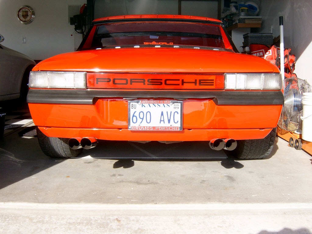

I just installed the AA Italian Tail Light Lenses.
Now I need to find the correct red bulbs for it. My local FLAP had nothing. Has anyone done this and what bulbs did you use? I am thinking LED bulbs.
Thanks!

There are no italian tail light lenses - they used the standard Euro lenses (amber turn, red brake, white reverse)....

Without red reflectors showing to the back your car is not DOT legal and wouldn't pass a state safety inspection (or vehicle code check) in many localities. Maybe that's not a concern where you live.

Right off the bat, KS requires TWO red reflectors in the rear. I don't think the man's gonna like the 2 white ones, either. I think the whole idea is a clear case of "rice" and "bling" gone horribly wrong. I concur with Rich; In my old age I've grown weary of tempting cops. It NEVER works in the best interests of the tempter .........

Isn't that a great big red reflector right in back? I agree with the craft store, I have used it on flood lights. Held up fine with the heat.

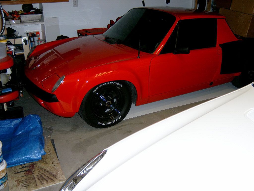

I have had the front turn signals done (no side markers) for a few months. This is no concours candidate - it is a bastard at best - but it is fun. Fiberglass flares - Tinted Windows - Cragar Wheels - etc - but it isn't on jackstands and I can drive it. I have a '72 that is box stock - showroom original (other than motor) that I would not dream of putting any lenses on that it didn't ship with. Hell I won't even put a hood emblem on it! The Wild Child is different.
Excuse this bad picture of the front - the garage gets messy in the winter.

The KS vehicle code says TWO red reflectors. Not one, two. I know, I looked it up.

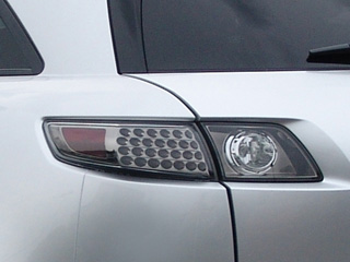

Now this car loks a bit like the back of my FX45:

I think you car looks great. Not sure why everyone must chime in with an opinion. If you look at half the modern cars they all have clear lenses.
I think it looks good too.
It's just not legal.
-I- don't care, but i feel it's the community responsible thing to do to at least mention it to the owner so he knows what he's set himself up for.
Lots of modern cars have clear lenses and - like that picture a couple of posts back - legal red reflectors - one per side...

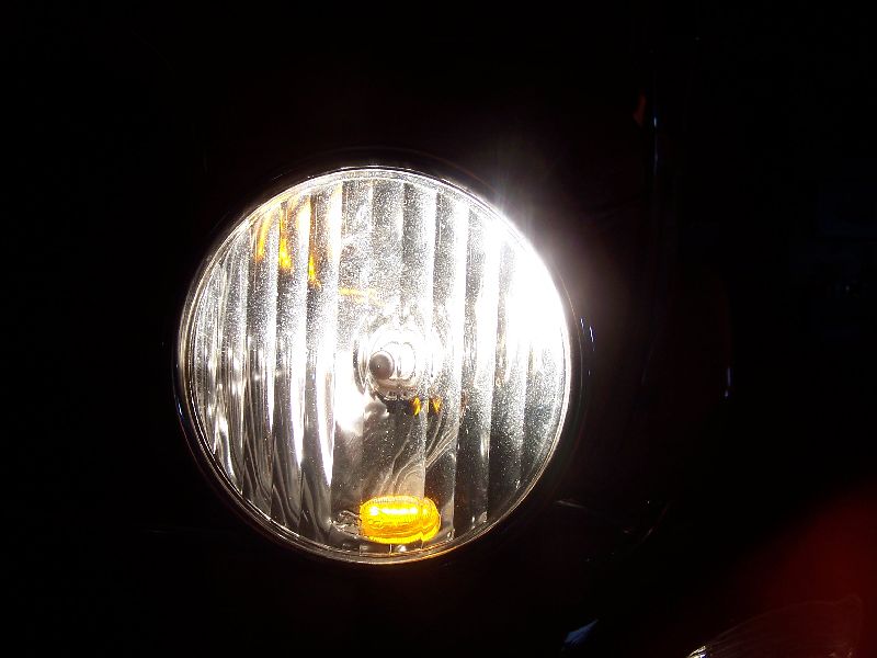

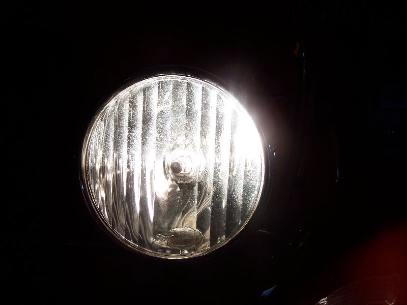

Just use red and amber standard bulbs from the local car parts places. I tried everything and that is the only thing that worked well. The LED bulbs just shhot a cylinder of light where the regular bulbs fill the lamp. i also painted my reflectors silver to get a more even dispersal of light. I will see if I can take some pics.

Here are some pics with standard colored bulbs.
Yes, they are not legal, but I really don't care. At work we go by 2sq in reflex per corner front, side and back. So technically you need 4 sq in amber on the front, 2 sq in amber reflex on the front side, 2sq in red reflex on the back side and 4 sq in red reflex on the back (50 state US spec), but oh well
