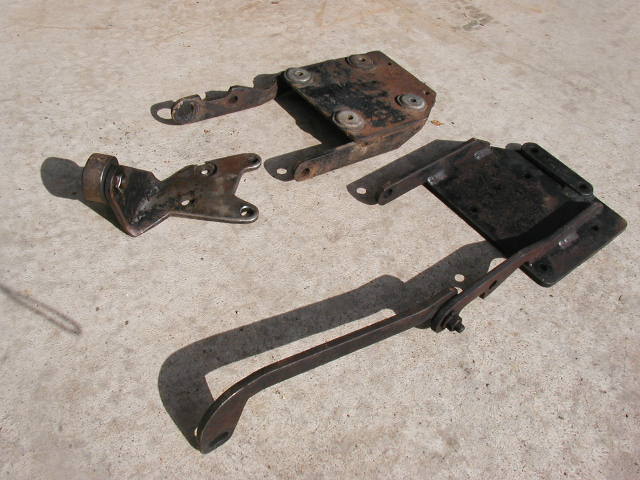

Hi Roy,
AC in your 914 is a great project. I've collected everthing for a future installation when I move to a warm place. Here's some photo's of brackets, etc you will need. I strongly recommend you do not use the old style "york" compressor. Check out a small rotary type Sanden brand compressor to eliminate cutting into the sheet metal. Check the Street Rod magazines for installation informatin on these modern compressors. I believe everything else is ok.

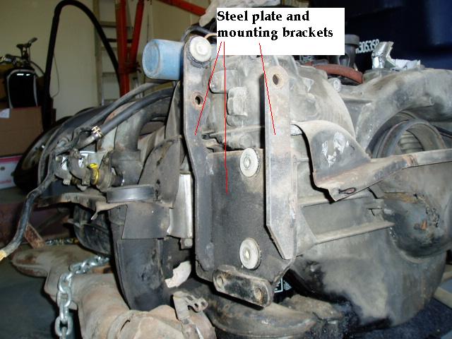

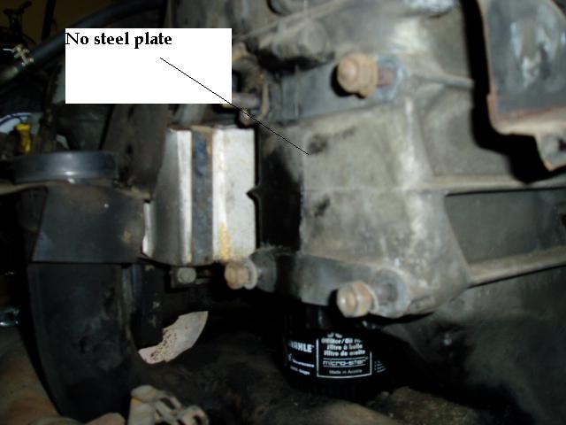

How ironic that you're putting one in. I'm taking mine out. I need some help. When I take the condenser off the engine what is the purpose of the 4 bolts used to mount it? Do these bolts not have anything attached when the mount is removed?
904svo
post Mar 27 2009, 08:55 PM
904SVO
Posts: 1,129
Joined: 17-November 05
From: Woodstock,Georgia
Member No.: 5,146
There is nothing that goes on there. It was only used for the A/C compressor
mounting. Some 914 have a oil cooler bracket attached to the upper rear bolt.
