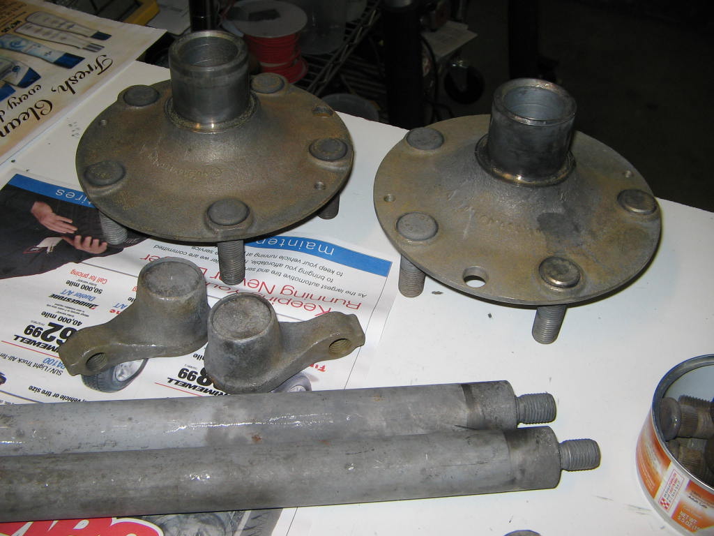

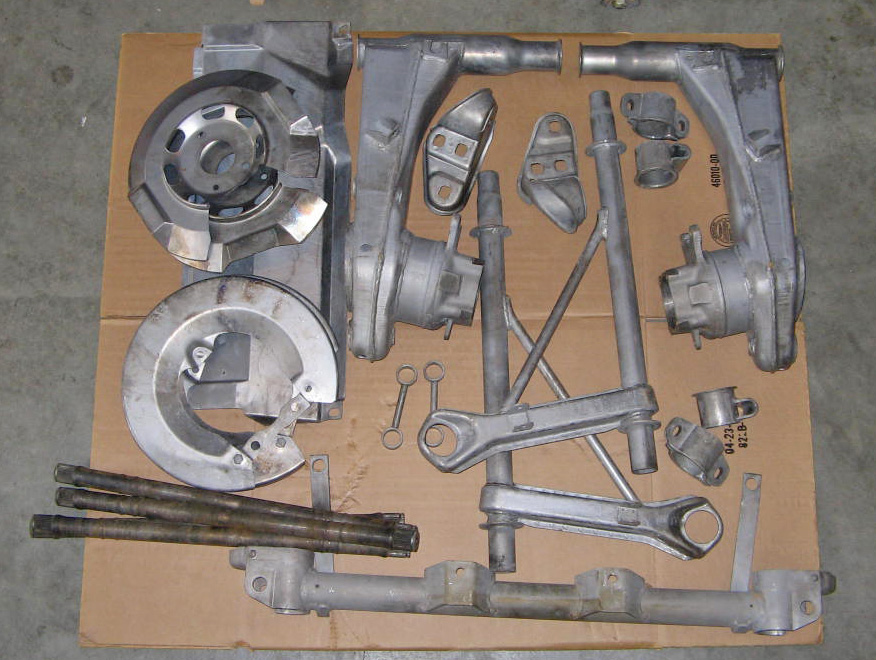

Just got a pile of parts back from the metal cleaner today. I'll deliver these to the powder coater next week. The trailing arms in particular were covered with CV grease and caked dirt. All gone now.
I also had a rusty front cross bar and A-arms for the front done, as you can see. I'm pretty happy with how nicely they cleaned up.

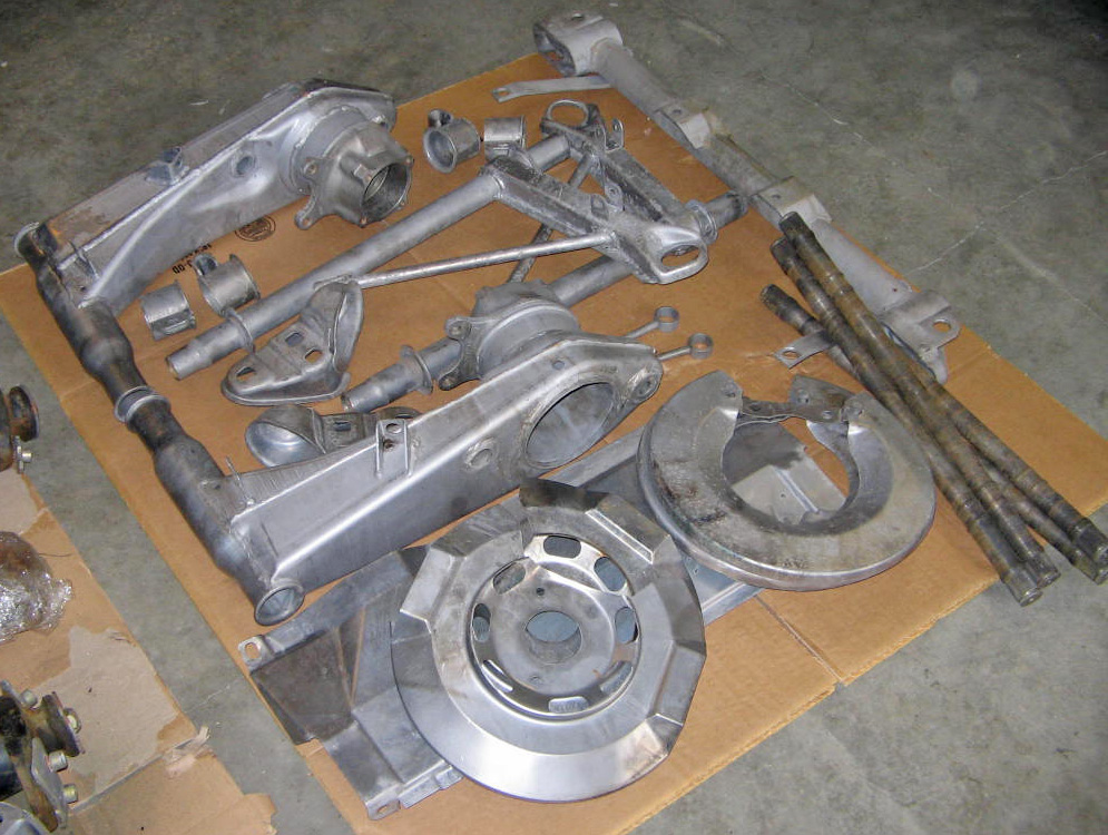

Another...

Also had the hubs cleaned. I'm going to blast off some surface rust that's beginning to form and paint the back side.

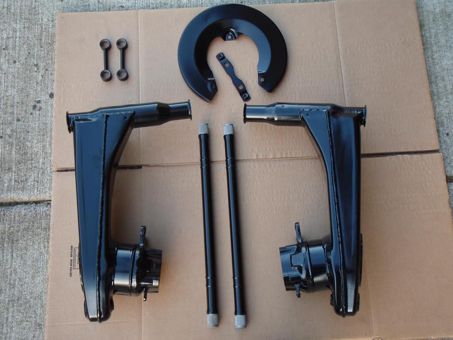

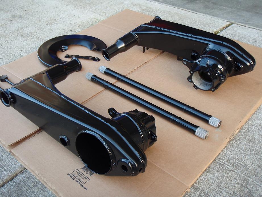

I have front and rear suspension projects going, so I'm going to merge them into this thread. The front suspension project is here.
I picked up powder coated parts today. As funds free up, I'll install new bearings, bushings, and hardware. My goal is to have my car back on the road this summer. It's been way too long since I've had this thing on the road.
Unfortunately, as I readying parts for the powder coater, I discovered that one of the rear brake dust plates was cracked at the middle bolt hole. I then took both plates of my car - and both of them were cracked too! I'm going to hold off on coating until I can find one that is not cracked.

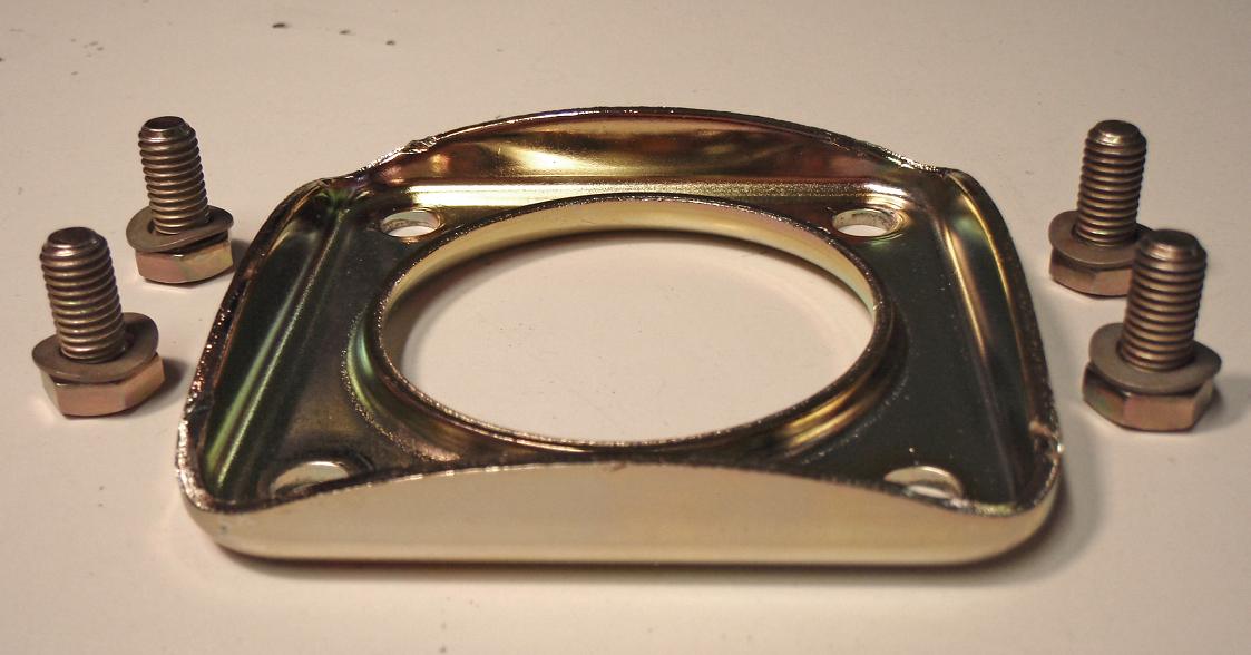

I had the bearing caps cleaned and zinc plated and I'm really happy with the results. Finished it off with new zinc plated bolts and wave washers, torqued to 18 ft/lbs.
