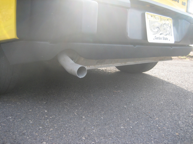

Here be a (I hope) saisfactory pic showing correct color and finish. This is a OEM spec item on a '70/4.

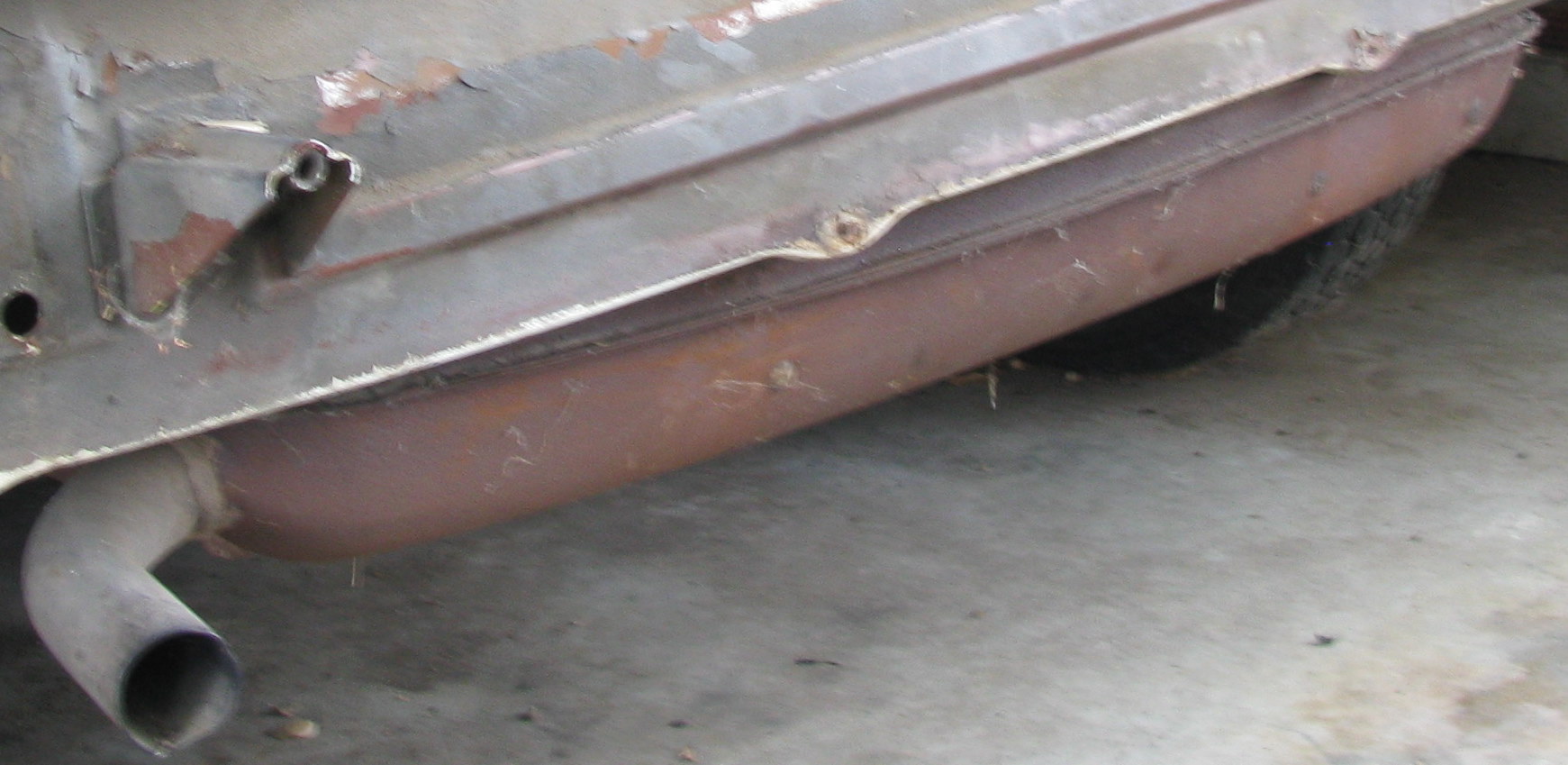

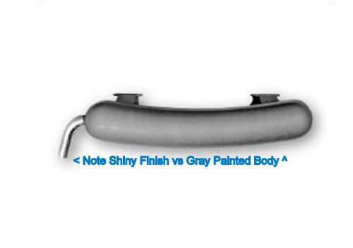

I have a question about the OEM Muffler for a `73 2L that I need to clean-up & repaint -
Did it originally or ever have a chromed or polished or semi-polished or stainless steel tailpipe section?
In the photo at the link below for PP's Dansk "OE style" below, it sure looks "shiny" to me!?
http://www.automotion.com/product.asp?pf_i...mp;dept_id=4573
I bought the 2.0 OE style Muffler in the pic below from Midas back in 1980 with a Lifetime Replacement Guarantee. I think I recall that they sourced it from either Dansk or whomever was the Porsche OES at the time, so it was good quality. Pat - this one was also not painted at the time it was installed, but had some sort of a protective coating on it, which has obviously failed at this point. So priming & painting seems like a good idea to me!
I suppose that they'd still be on the hook to get me a new Dansk whenever it should fail, but it's still solid at this point - the car having been stored in my SoCal garage since 5/85 due to the body damage above it (& a new family back then).
Although it looks rusty - its just surface crud that I can steel wool off & refinish with the hi-temp primer & grey paint noted in this thread - at the time I have to pull it off to redo both sides of my rusted-out heat exchangers - but I'm unsure how to do the tailpipe section?
Anyone out there know how I should finish the tailpipe on this? (IMG:style_emoticons/default/confused24.gif)

tod914
post Apr 17 2009, 11:55 PM
Posts: 3,755
Joined: 19-January 03
From: Lincoln Park, NJ
Member No.: 170
Tom, no chrome tips. Just grey.
Tom_T
post Apr 19 2009, 04:34 AM
TMI....
Posts: 8,321
Joined: 19-March 09
From: Orange, CA
Member No.: 10,181
QUOTE(tod914 @ Apr 17 2009, 10:55 PM) *
(IMG:style_emoticons/default/huh.gif) REALLY - ALL GREY !?
Tod - Look at the pic below & note the "silver" or "shiny" look of the tailpipe section, vs. the grey painted body. Is that just an unpainted or clear coated natural steel finish? I seem to recall that mine looked that way at first, and this is the 3rd on my car - including the OE one when new.

DANSK OE-STYLE 914-2.0 REPLACEMENT MUFFLER:

Tom, what Tod means is the original mufflers where grey. The pic you've posted of the 'OEM' replacement from Dansk; somewhere along the way they decided to chrome the tip. I suppose they have fallen vicitim to the Bling mentality.
When new, back in the day, no chrome.

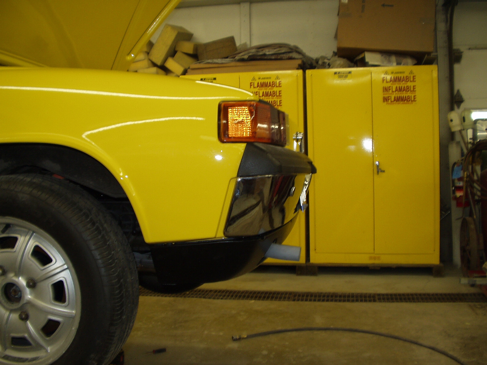

My muffler is NOS, with the grey coating, also I have a gray tailpipe.

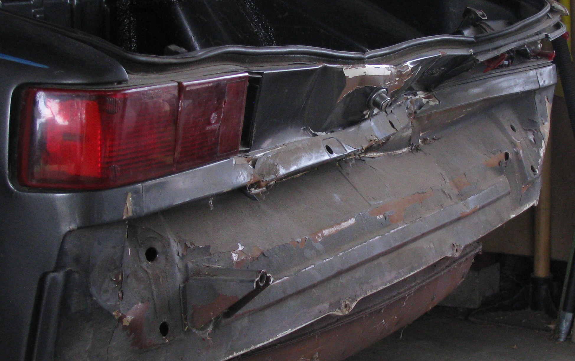

FYI - Here's a couple of glimpses of what bodywork I'm up against, in addition to getting all of the mechanicals back up to speed after sitting on blocks for 24 years since 5/85.....
REAR END DAMAGE
