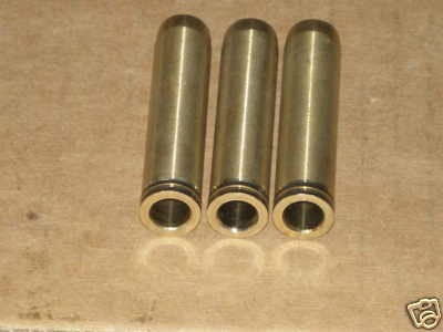

Hello,
My machine shop has informed me at least one valve guide needs to be replaced with an oversize guide. I can't seem to fine a good source for oversized guides. Anyone know of a guide supplier?
Thanks.
Dave

just a minute ago saw some os exhaust valve guides listed on ebay new! just listed too!

Call Engine Machine Service, (310) 641-7019. It's likely you'll have to get guides that are "machine to fit". They sell Technovance guides, the ones you oughtta be using anyway.

PART#021 101 417 A10,MFG.TECHNOVANCE
US $6.00
VW,PORSCHE,O/S EXHAUST VALVE GUIDES,QTY 3,914/4
http://cgi.ebay.com/ebaymotors/VW-PORSCHE-...bayphotohosting

Regarding missed cracks, my father is overseeing the rebuild. Since he is a retired factory trained Porsche mechanic from the 60's/70's, I'm hopeful they will turn out ok. If I had the funds, I would be shipping them out but that blow out the budget on my's son's project car.
I've looked at the ebay listing. I didn't see any measurements and since the ads say they fit everthing from a '70 914 to a '92 Vanagon I've asked for measurements to make sure they are 2.0 guides.
