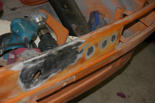

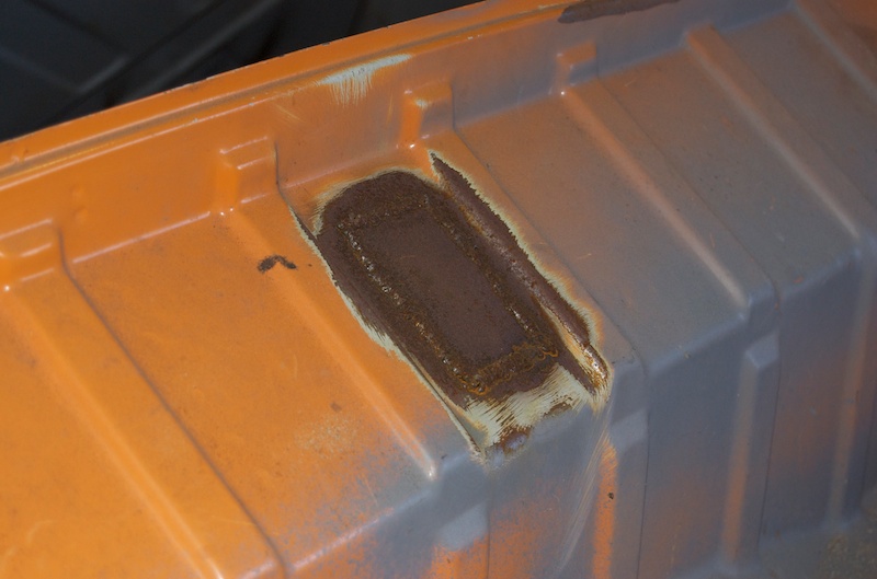

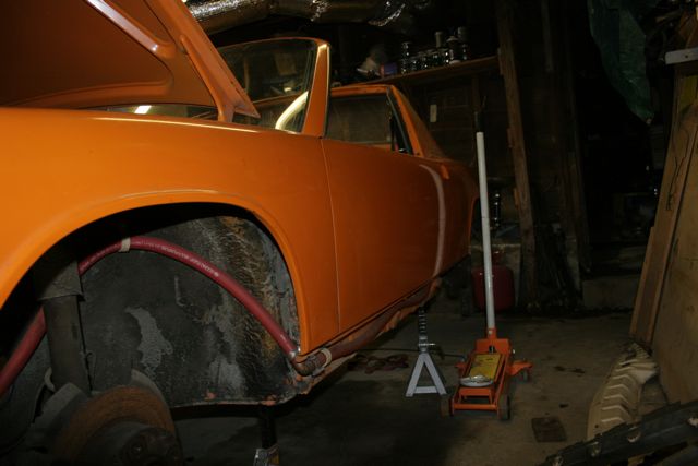

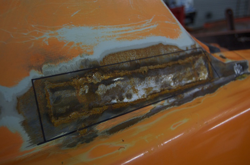

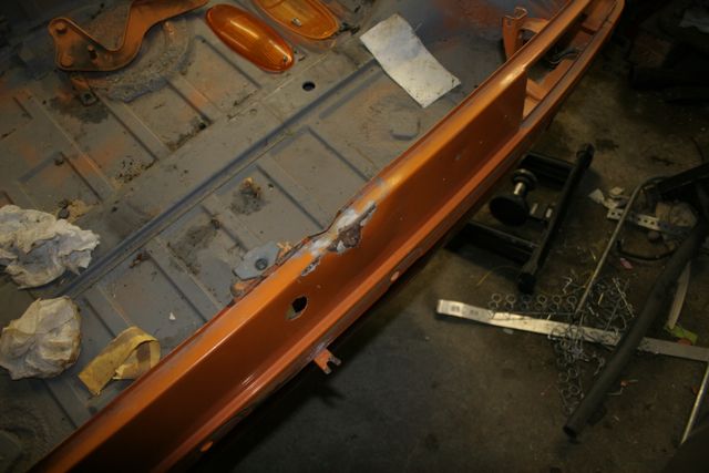

I've been working on dents and welding up holes in the new tub... progress is slow; however. This is a big project.

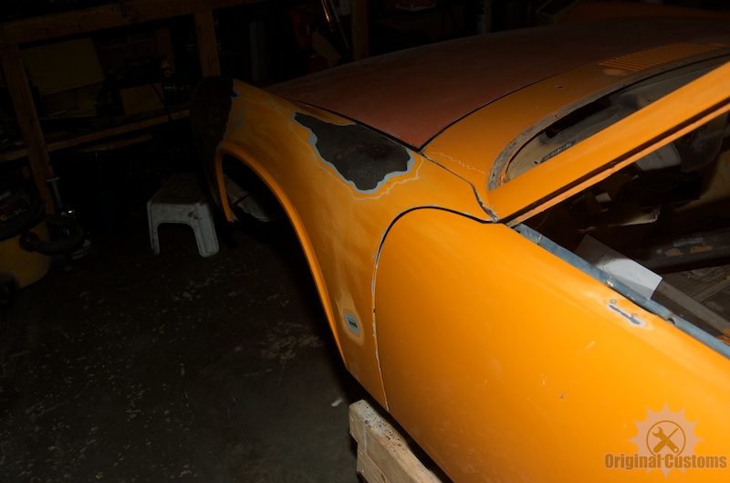

I've been working on hammering this dent out. I think the backend has been hit before. I'm planning to weld up the badge holes and go stealth with it.
The rear decklid, btw was toast, so we made these wings out of it for our lemons car....

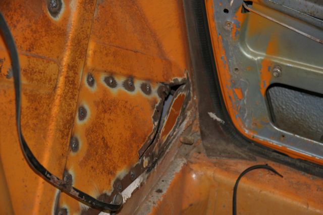

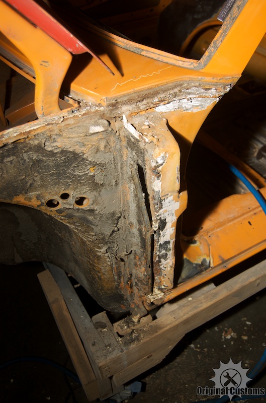

The PO had riveted panels in to cover up rust, so I removed all the rivets and am in the process of welding in new peices of metal where rust used to be. There's a few other places where the car has been cut and I'm putting it back the way it should be. I'm aiming for nice, tho, not concourse; so I don't mind a few weld seams here and there.

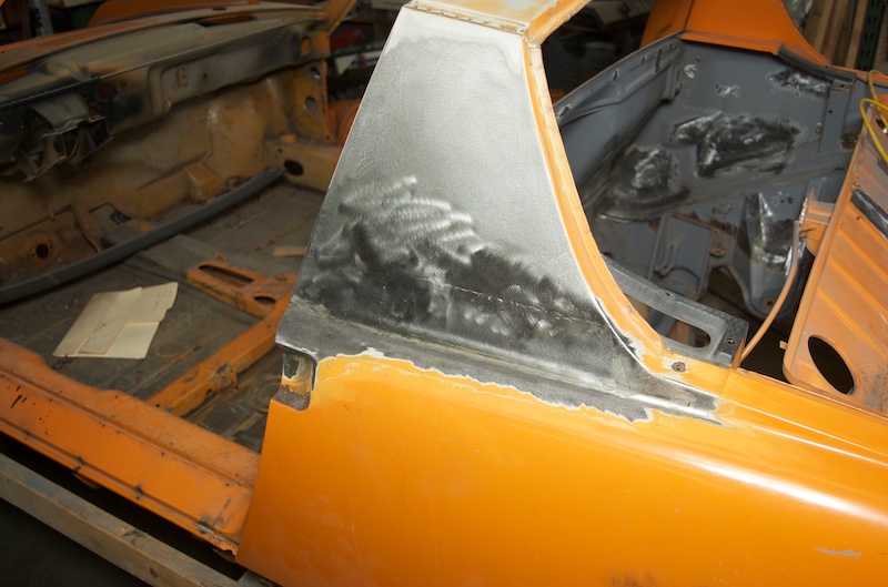

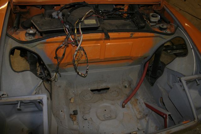

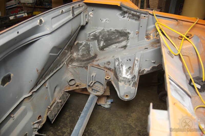

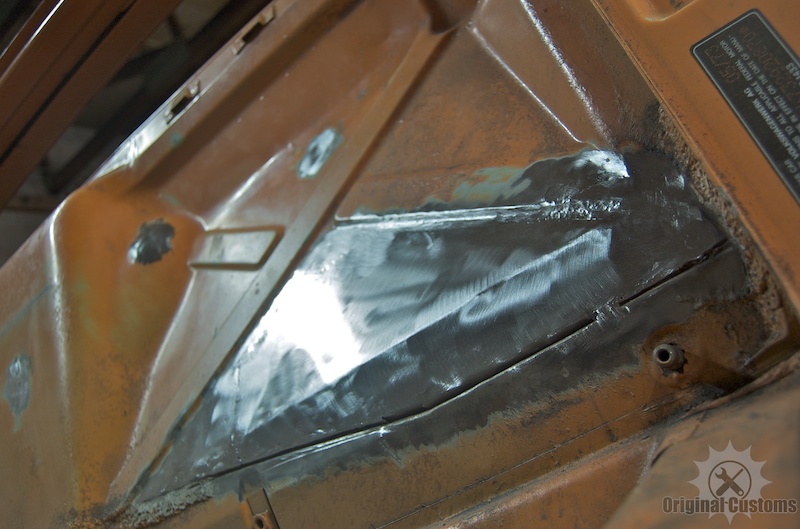

I've been working on Fiid's new chassis and I thought I should update this thread for him, since the body is almost ready for paint.

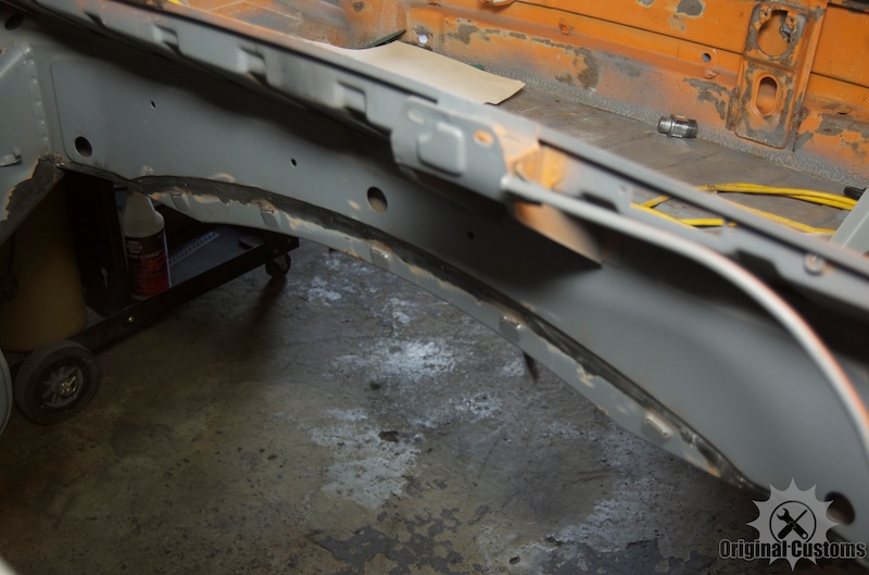

Cleaned up some previous patching.

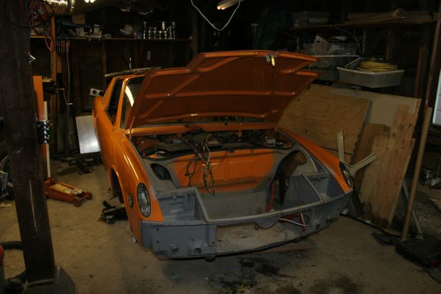

Member No.: 419

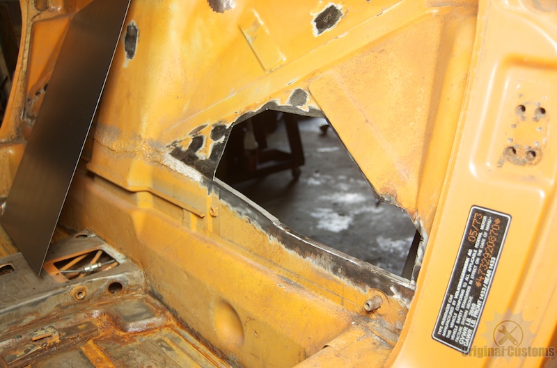

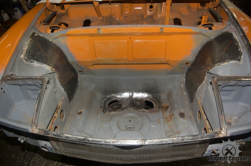

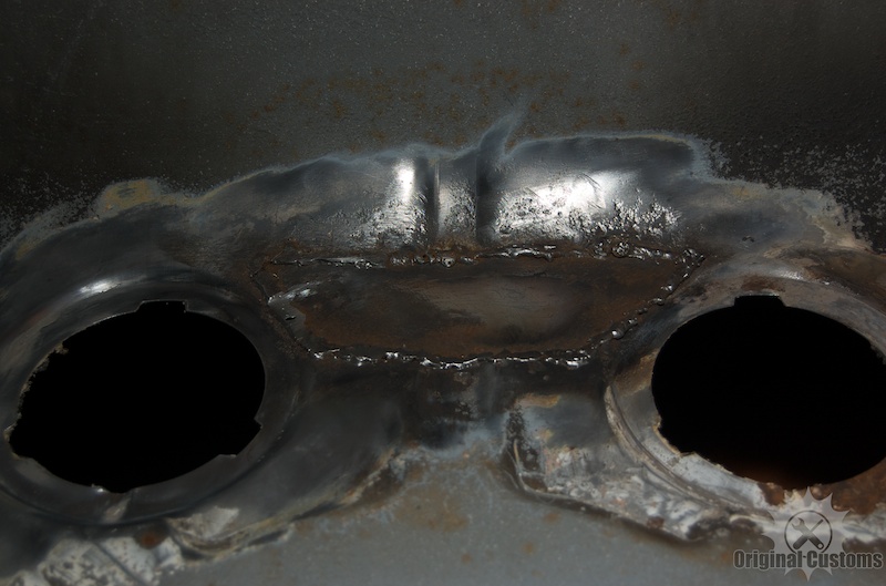

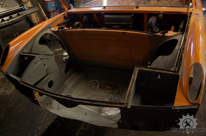

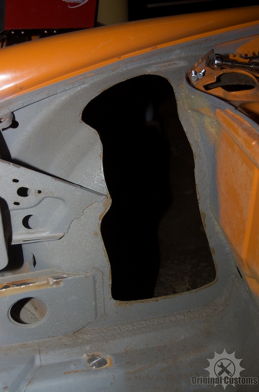

We completely removed the engine shelf, since it's worthless in a watercooled car. Once this is painted it'll look like it was never there.

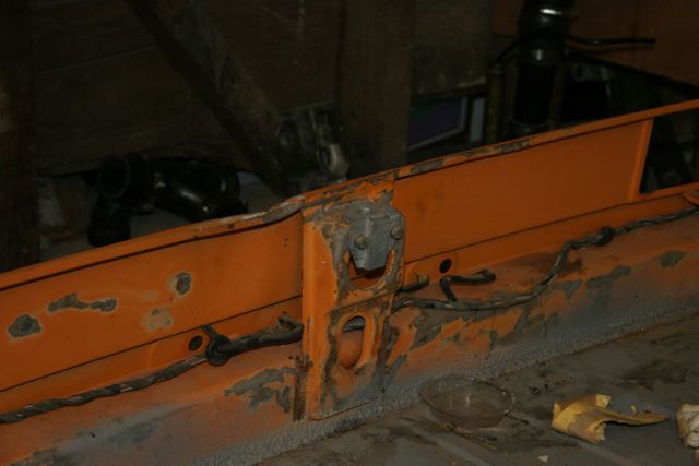

Member No.: 419

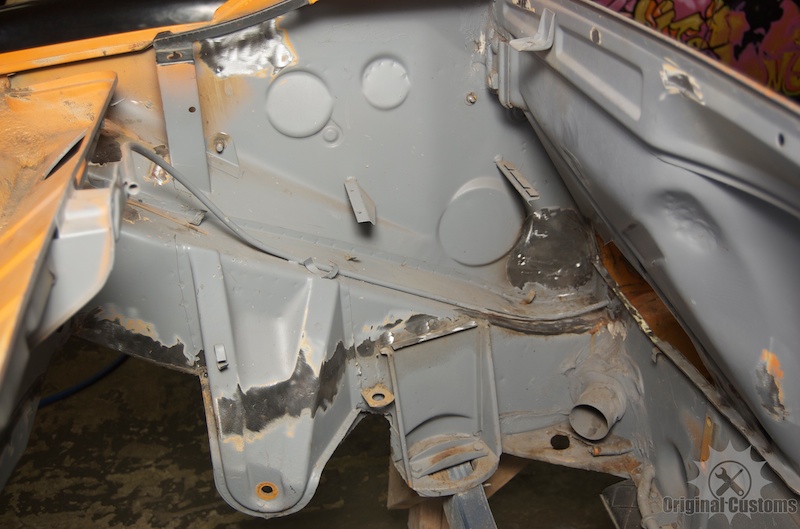

More patching holes...

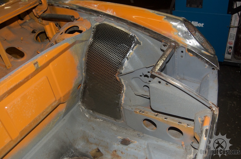

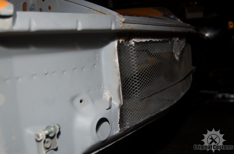

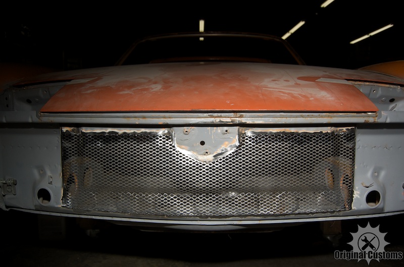

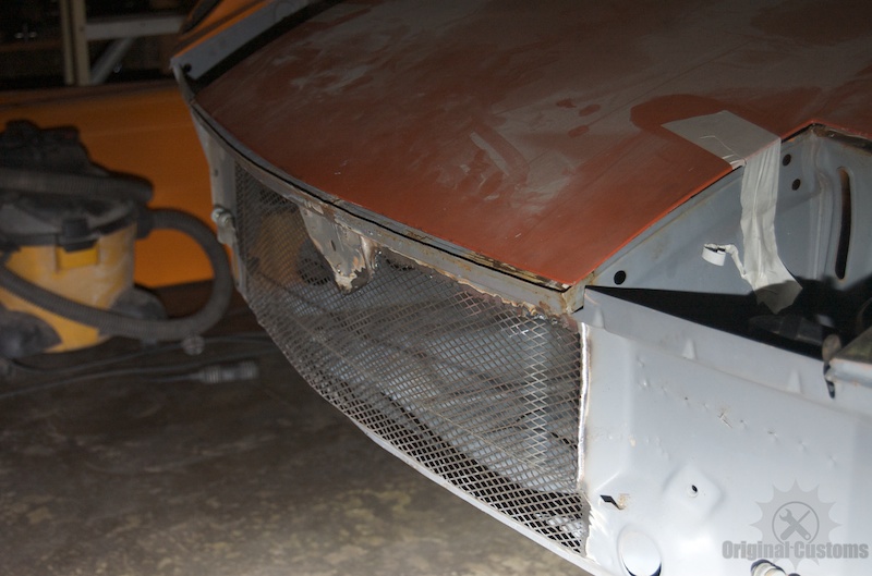

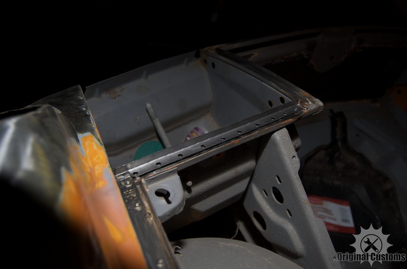

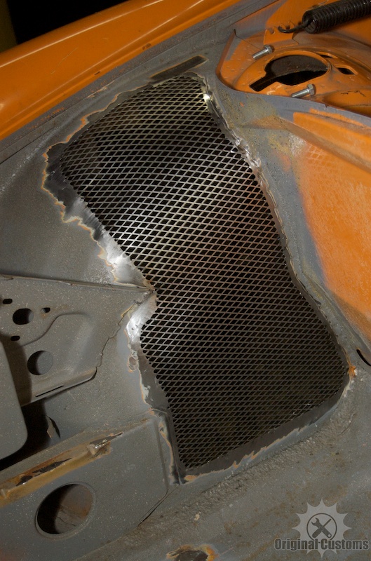

The first big custom project was to clean up the rough-cut front opening and then weld in diamond-punched steel. This ain't your hardware store expanded metal. (IMG:style_emoticons/default/barf.gif) Each little leg had to be welded and ground, but this stuff almost perfectly matches the stock engine grill. I used another 914 as a press-mold and formed the expanded metal to exactly the same as a stock 914.

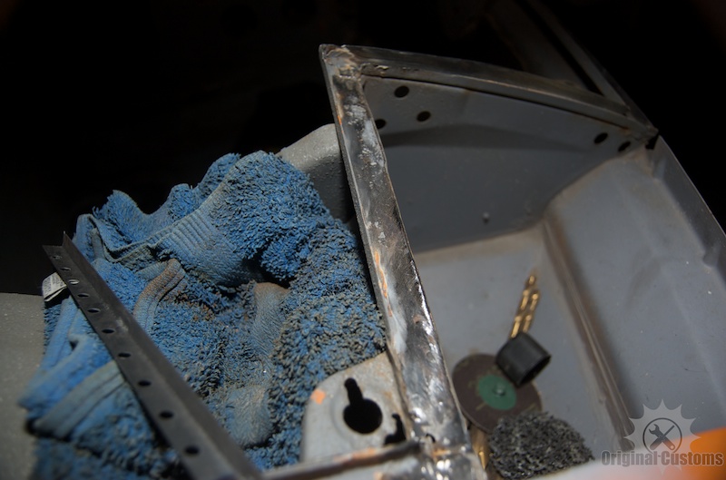

Replaced sections of the seal channel.

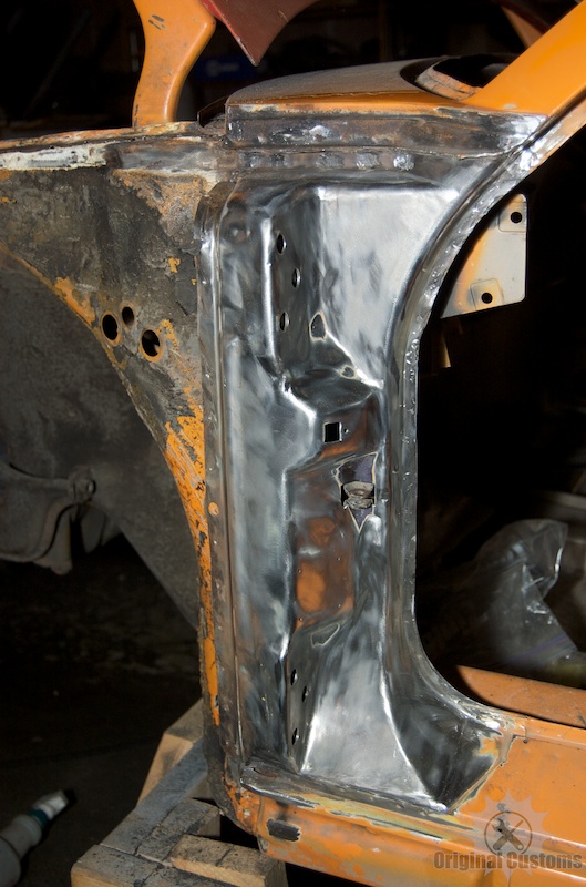

Got a little more work done. I'm not sure if anyone's reading this... (IMG:style_emoticons/default/unsure.gif)

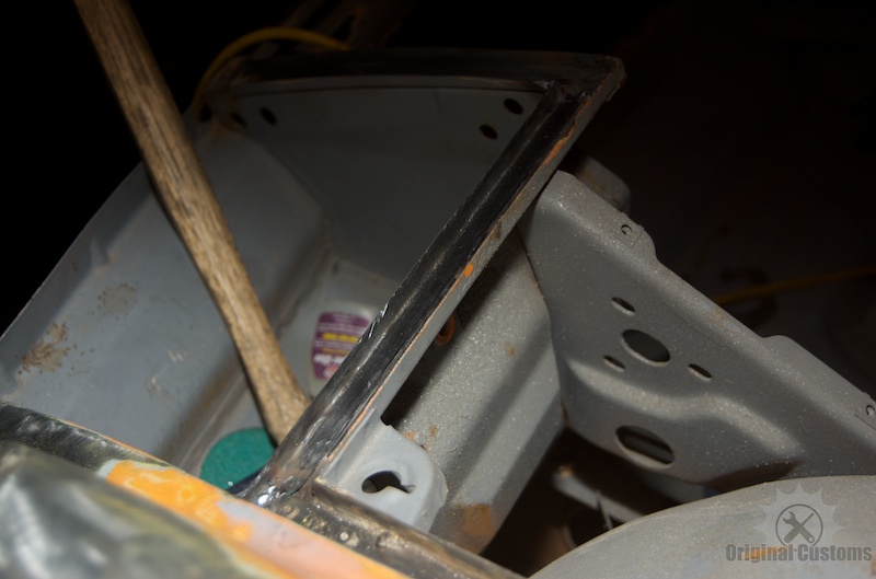

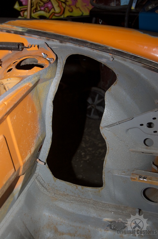

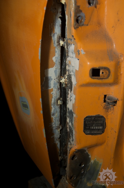

The driver's side door jamb had been crushed and a new fender 'installed'. It was pretty crappy work. So the fender came off, a replacement door jamb installed and then the fender was reinstalled correctly.

Member No.: 419

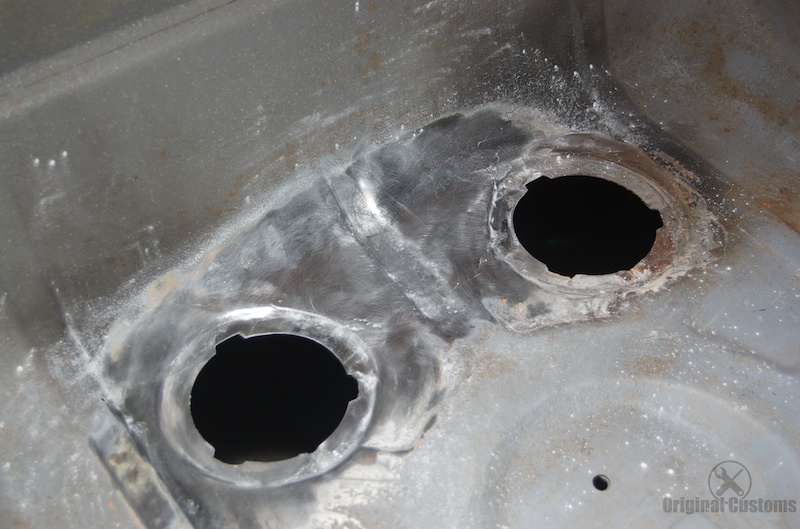

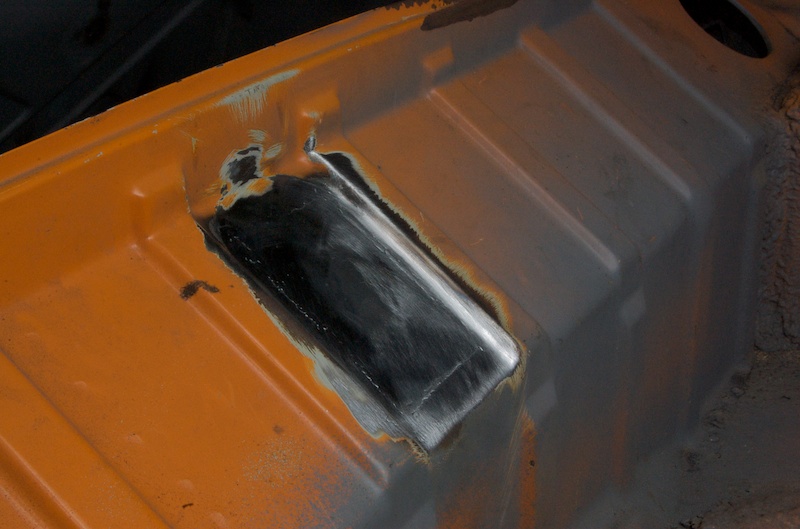

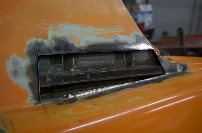

The front air inlet turned out so well, we decided to use the same treatment on the fender outlet holes. (IMG:style_emoticons/default/welder.gif)

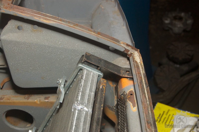

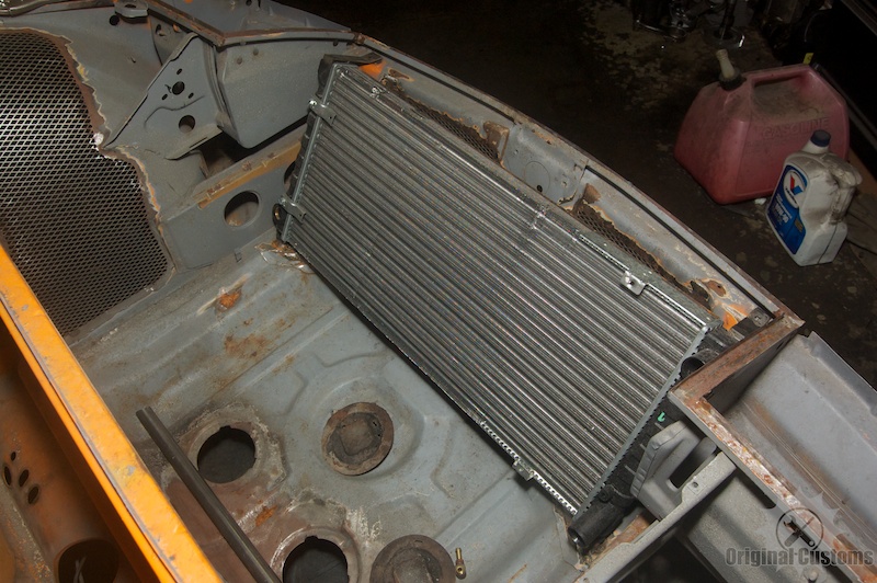

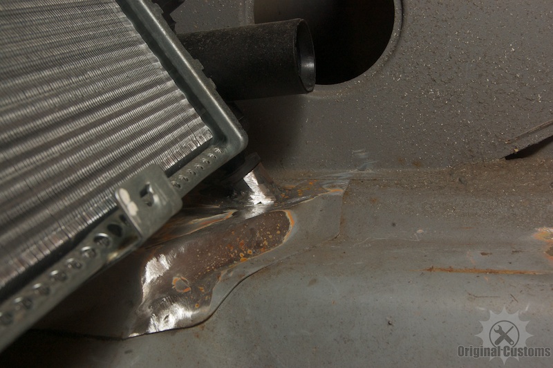

Finally, a minimalist approach to radiator mounting. Two tube sections were welded on the bottom, and two small brackets on top are all that's needed. And there is very little modification to the chassis. The radiator is off of a modern VW and is the same unit Fiid is using in his current setup. So we know it works.
