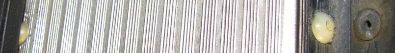

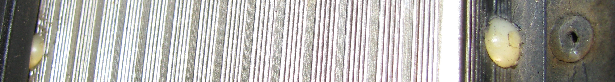

Below are the upper threshold to rocker rivets on right from mine. I'm pretty sure that they're OE - or at least were no later than 12/75 if they were changed out on an earlier repaint than my 2 (for which they weren't), but that's unlikely from what I can see under them as still being the OE L80E.
Zinc Plated Door Threshold to Upper Rocker Rivet at Right:

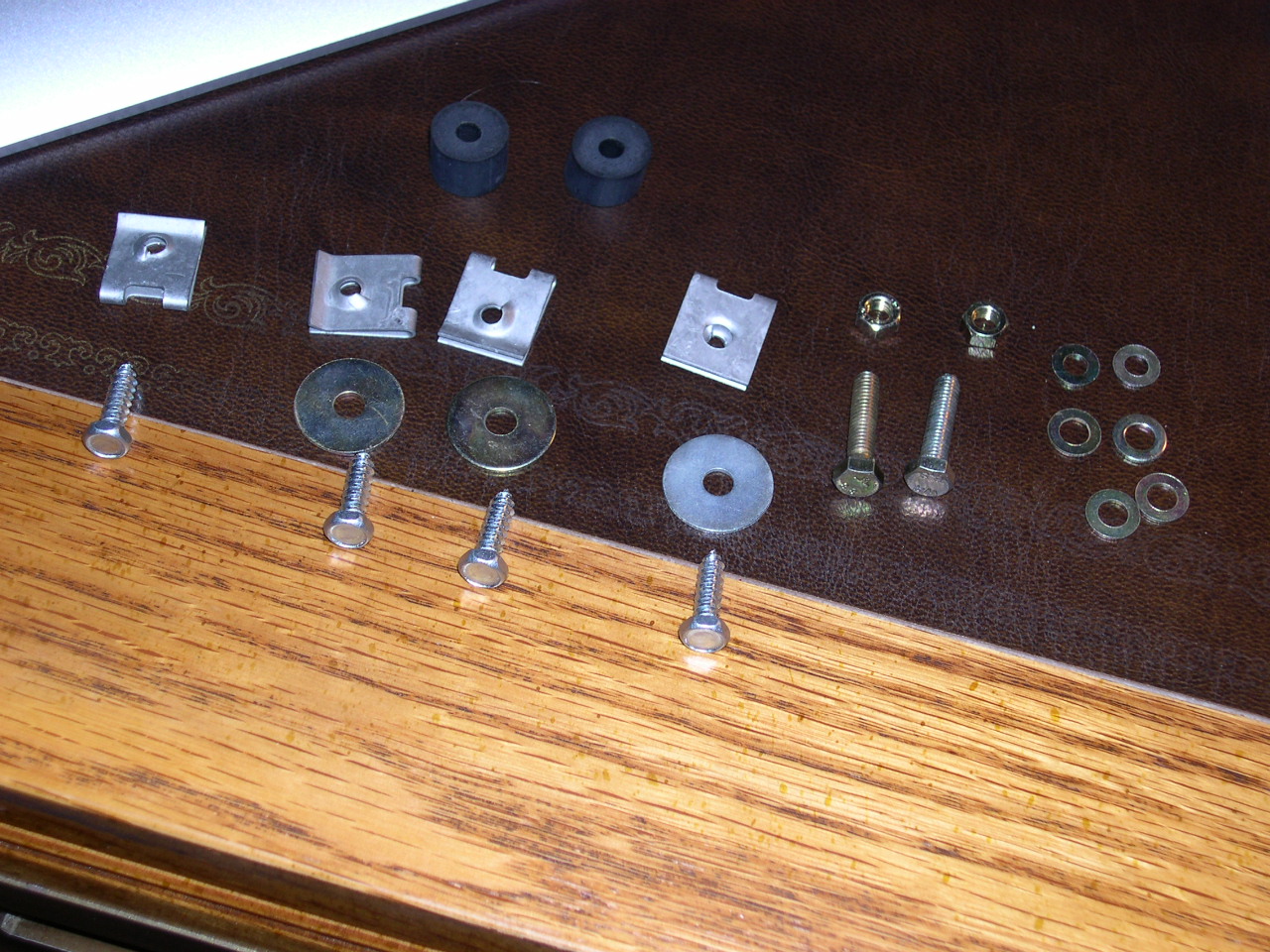

So....
Here we have the rocker fasteners, as supplied by Uncle George (AA). I have no problems with them, other than the transluscent rivets, and would have a problem with them if more correct ones weren't available.
Most of AA's parts appear to be zinc coated, though a minor few appear to have "cad" plating. All in all, it's a good kit (my opinion). To the right you'll see examples of TOD914's custom made rivets, which are about as perfect as you can get. The white rivets are white for the early cars. The blacks ar black for the later cars. You guys really need to PM TOD914 about these, as I think he still has more of each.

oo-oo!!! I need those for my valences & probably the rockers too when I get them off! It's great to see what AA is actually offering. BIG Thanx Pat!
Tod914 was also going to try to source the threshold to rocker rivets like the pic I posted above.
Sticking with your fasteners theme - I also found these other type of metal large & small rivets at Sierra Madre Collection online (good pix of the parts at the links below, unlike AA's guessing game):

Yup - Tod914's are better for either early or late! mine in the pix above (2 at center & left) are just like his white ones - for my alum. threshold!
btw - my rocker screws are rusty, but appear to be zinc coated at one time, & the clips could be either cad or zinc or both!?

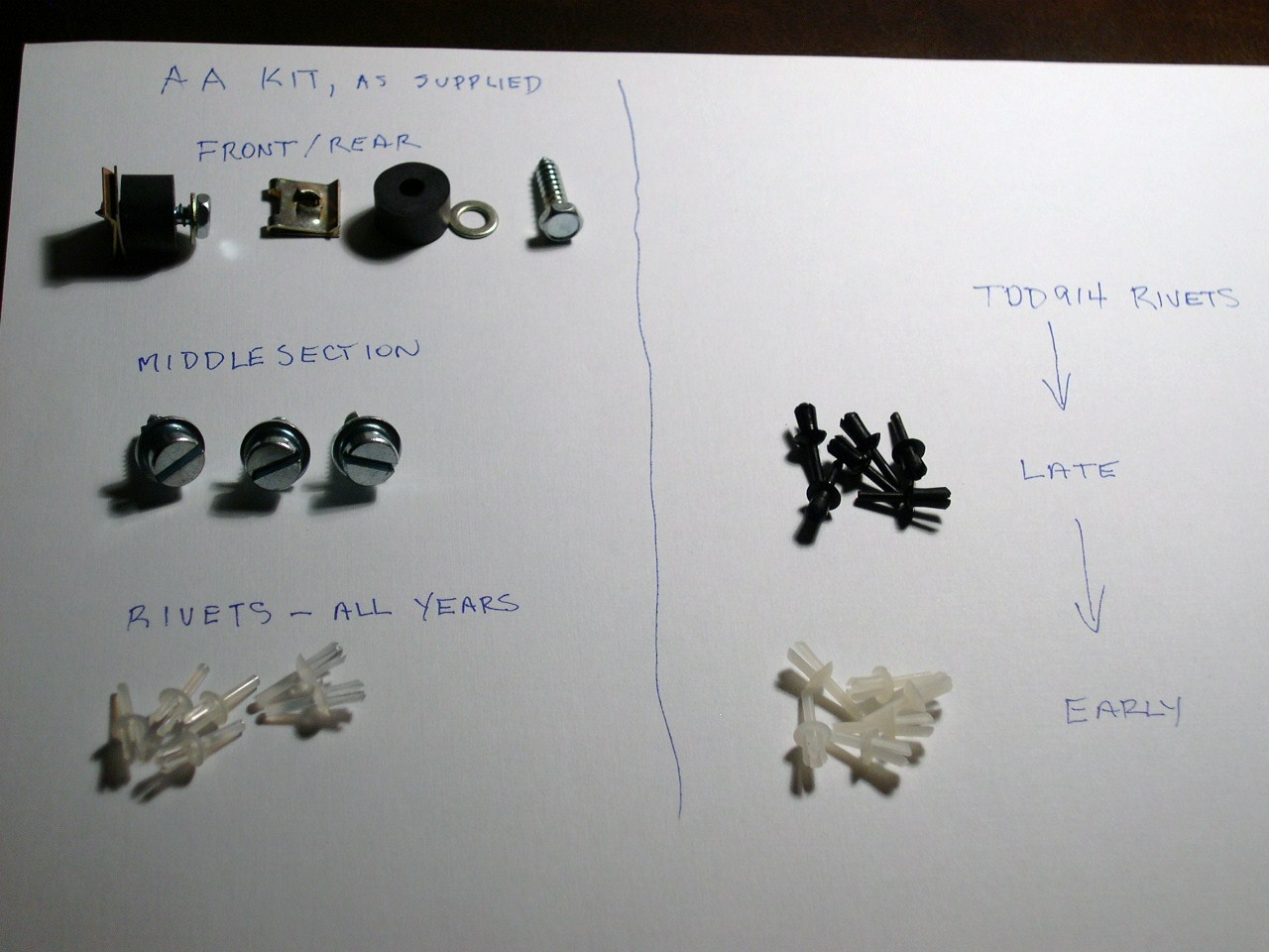

Still working on the F & R pan fasteners sent by AA. Comparing to PET & there seem to be some differences. Will post when certain.
OK, as promised, here is the AA kit for lower pan fasteners. They are the same from AA, for front or rear.
Tell me what's missing.

Should be 4 or 6 of the black nylon spacers I thought!?> (IMG:style_emoticons/default/confused24.gif)

There are 2 spacers for each panel - total of four, front & rear.
Now, here's my question.
Front pan - the hex head bolts mount from onside the trunk, to large speed nuts.
Rear is the question. Remeber, my original snowplow gave up the ghost over 30 years ago, so I mounted a later style rear Half-pan. I was in my early 30's then & mounted it expeditiously with screw from the rear, into speed nuts underneath.
So, my question(s) is/are....shoule the new snow plow be mounted the same as the front? i.e., bolts from the muffler side through to speed nuts on the front side? Am I missing a large washer? (IMG:style_emoticons/default/huh.gif)

Will do!
So....
Pat
Next, we'll view the AA F & R pan fastener kits.
Pat
Pat,
Mine's off the 73 (shrt) & might be different. I'd look at the Haynes or another 72 to see the correct OE. On mine I have a large washer for each screw/bolt in the back valence rear (in a baggie temp).
Re: black nylon spacer- washers, I was thinking there were the 2 on the ends plus 2-4 along the front or rear face (similar to the rockers), but forgot that it's hidden by the bumpers there! ...brain fart! (IMG:style_emoticons/default/blink.gif)
BTW - Do you know if they made an aftermarket STEEL short rear valence to fit 73-73 etc.? I was looking at a 74 shell for body parts, but it's valence looked different, had an extra steel brace behind & above the exhaust notch, & anmore krinckle-paint sort of finish!!?? (IMG:style_emoticons/default/confused24.gif)
