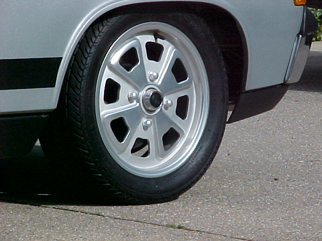

So McMark - on those 2L alloys - did they color the background to that matte or satin silver finish, then seal them???? (IMG:style_emoticons/default/confused24.gif)
If so, what is the correct dye & finish on that background area??? (IMG:style_emoticons/default/confused24.gif)
...as opposed to the semi-polished "petals" or "windmill blades" & rims or lips below:

I believe the wheel is not colored and the difference in appearance or "shading" is due only to the recessing of the areas between the spokes and in the level of polishing of the spokes. An optical phenomenon.

I suppose the background could be more of a raw unpolished (maybe just burnished or smoothed after casting/forging) - vs. the semi-polished on the blades & lip/rim.
I'm going over to Al Reed's on Monday to see a newly restored & re-anodized set, & will try to take a pic to post with restoration info. for his shop.
He was saying $140 each to restore/refinish & re-anodize.
