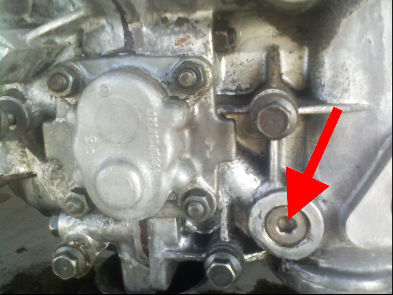

Well i went to do some more cleaning on my engine and found a decent sized pool of oil underneath it.. after inspection i found that the inner push rod tube seals are leaking ALOT.. soo looks like i have more work ahead.. and this thing is leaking too but i don't know what it is..Attached Image

That is an oil gallery plug, and is a good thing to have in place instead of the factory plugs.
Use an allen wrench to remove it, and replace it with a liberal coating of case sealant.
