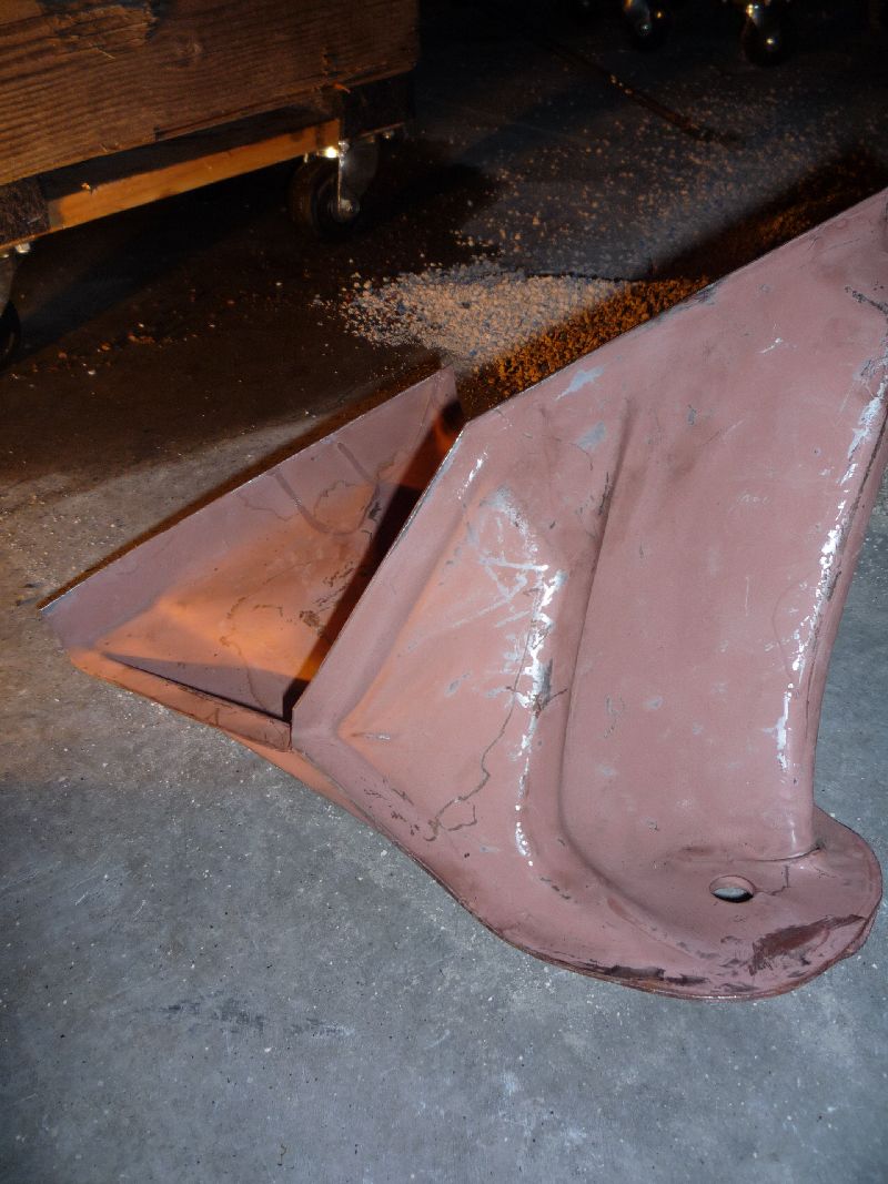

I ordered the brace & if not sent out today hopefully on monday. I'm pulling the drivetrain tommorow. Anyone have a step by step & pics for what to cut out?

I don't drill spot welds often anymore. I grind them out with a 3M #1991 disc in a die grinder. Much much faster and after you peel the junk metal off the good metal underneath is seconds away from ready to weld to instead of left with a bunch of holes or little round pads left behind.

(IMG:style_emoticons/default/agree.gif) with SW914. I only use the spot weld drills if I need to reuse a part that I'm cutting off...

Okay so I'd still like to see a how to thread. I am fairly confident I can do it with a friend welding it for me. I am a little worried about getting it in the proper position. I was thinking maybe drilling a few guide hole on around the one I am taking off (IMG:style_emoticons/default/confused24.gif) . What did you do? Thanks

All you care about is the final location of the hole...the hole that holds the inner suspension bolt.
Now...measure forward to the firewall.
That gets you in position front to back.
Measure from one hole to the other...
That gets you at the right width.
Lastly you need to measure down from the longitudinal to the hole.
This gives you the three measurements that you need.

In my experience, if the long is in good shape the console only fits well in one place, therefore pretty hard to get it wrong.
Since your console is broken already use the left side for the measurements that Rich suggested.

When the new part arrives it will be pretty obvious what you have to remove to make it work. Just measure the one that is in there in a couple of spots and record them. The new one will really only fit right where your damaged console is but just double check with the measurements.
You can drill out the spot welds if you want (about 50 on the engine bay side alone, more on the bottom) or just cut and grind the old one out. I would mark the old one's position with a sharpie and go to town.
You are lucky since you dont have to save the cooling tin shelf that goes around the ear. Is yours still there or already removed? That is the piece that gets in the way. Oh and the area around the motor mount on the long also, but that is easier than the engine tin shelf. Hope this helps, maybe you can do the tutorial and they will make it a classic! (IMG:style_emoticons/default/biggrin.gif)

I am going to pull my drivetrain satuday. The get to grinding off the many spot welds. May do a mixture of drill/grind depending on location. I hope to get it out & prepped for the new one. I will see if I can get the jig Rich mentioned too. Then I just need to bribe on of my buddies to come by & (IMG:style_emoticons/default/welder.gif) for me (IMG:style_emoticons/default/biggrin.gif)

Okay so eI went to start grinding welds. Looks like there was some metal added below. There is a piece that overlaps where the replacement goes underneath? SO I am not sure how much to take off. Not sure if my picture will show it that well (IMG:style_emoticons/default/confused24.gif)
