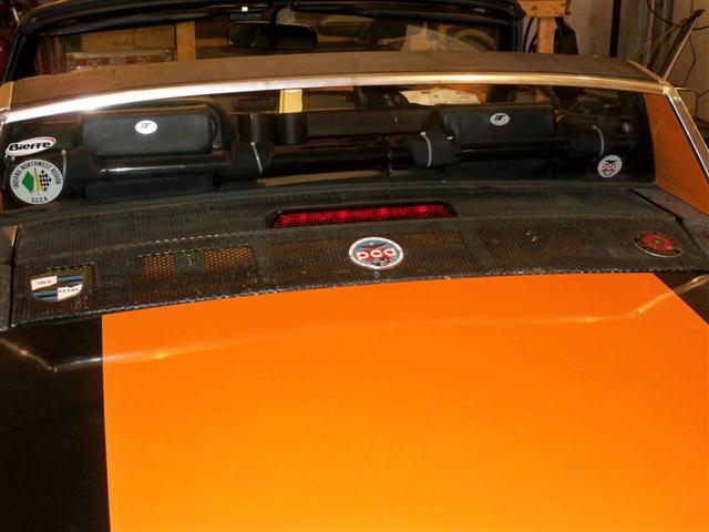

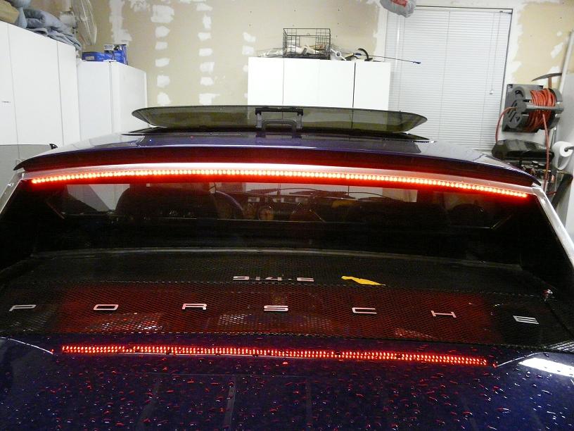

been thinking about a 3rd brake light for a while now
found a 10 lamp unit at http://www.commandelectronics.com/
mdl 003-74r and good price at $29.99
brakes on, virtually dissapears when off

Sorry, need to get the "ON" picture resized
be back later
gary

(IMG:style_emoticons/default/drooley.gif) Can't wait to see the "on" pic.
That's the best 3rd brake light application I've seen on a 914. Might have to do that someday. Price is right too.
Every time I see a GMC bumper out the back glass or in the side mirrors, I'm reminded of how low my 914 is, not to mention my taillights. Feel like a 3rd brake light would look cool and be a good safety addition.

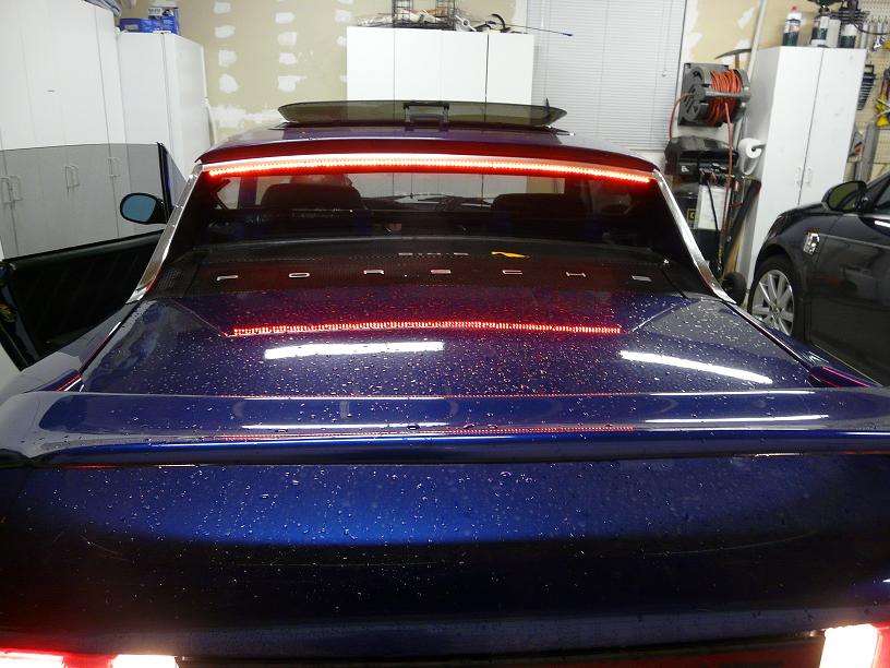

OK resized (I hope)
installed with double stick foam tape and did a temp wire install by sticking to the underside of the rollbar with silicone, and hooked the wires into the bundle-power to a black with yellow brake line and ground to the brown. pretty simple, but no pics of the install. but no bracket needed cause it is only about 1/2in thick.

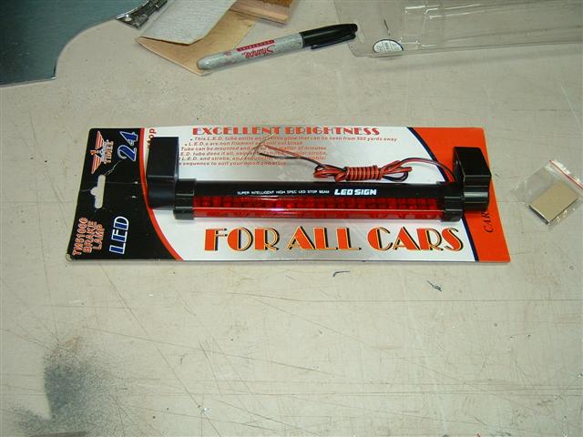

I bought mine on Ebay. They are called LED Flexible Strip lights 120cm (48"). With these light you can trim to fit. And they only cost about $15.00.

I wonder what that light strip would look like if it was put inside the aluminum trim piece right above it.....hmmmm....

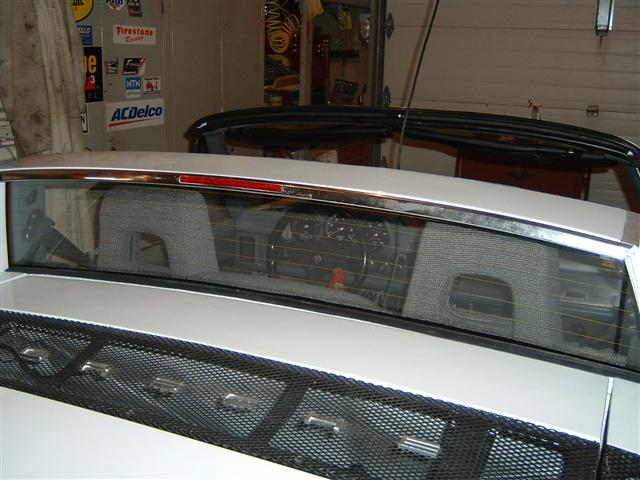

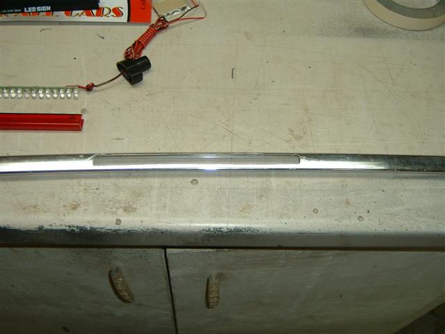

QUOTE(Sleepin @ Nov 19 2009, 07:22 PM) *
Like this!!!
BTW Nice work Gary.

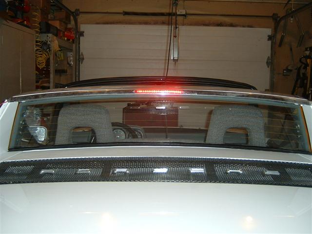

tracks914
post Nov 19 2009, 09:32 PM
Canadian Member
Posts: 2,083
Joined: 15-January 03
From: Timmins, Ontario, Canada
Member No.: 153
more

Yes, like that....just all the way across. I wonder what the depth of the flexible strip lights are.
edit: something like this might fit under the bar and with 24 carefully drilled holes would blend seamlessly!

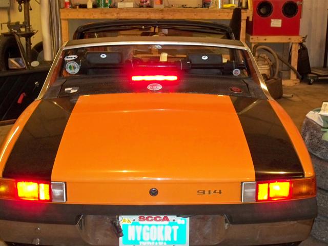

I used a Corvette 3rd light mounted on the engine lid. I do like the hidden in the roll bar chrome also.
